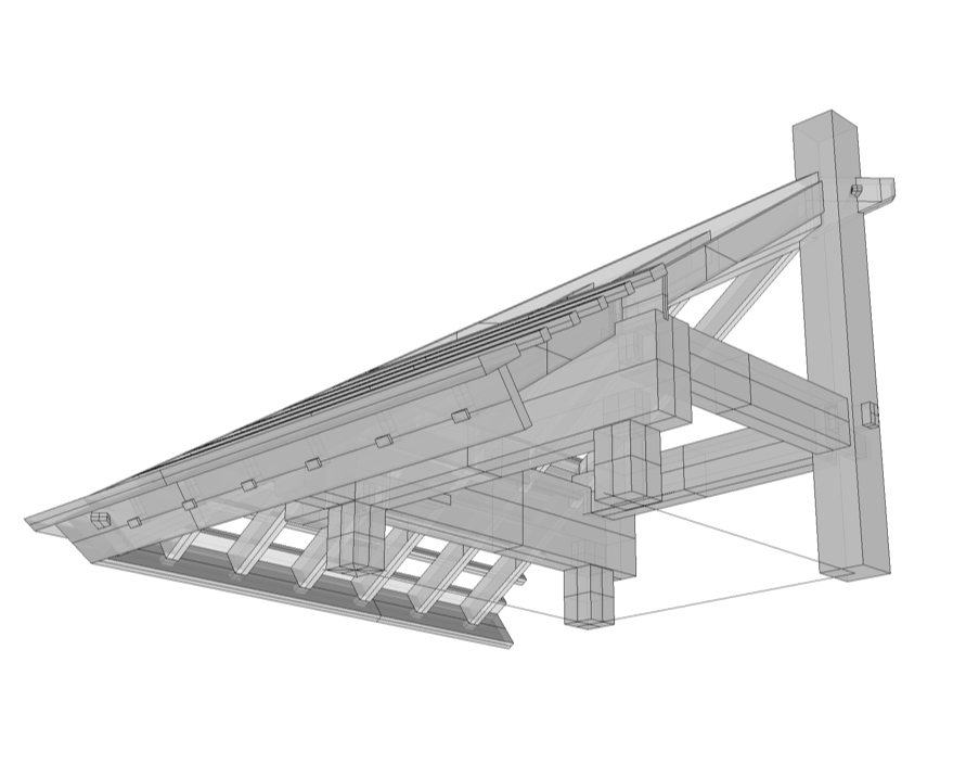

Updating from yesterday's discussion...
I feel like I have developed a strategy with Rhino which works well for what I am trying to achieve at the moment. As usual, mistakes are the best teacher.
Going over the drawing this morning I found a bunch of tiny misalignments between parts. These had resulted entirely from my approach to doing the drawing.
In SU, I generally spend all my drawing time with the camera set to perspective. I go to parallel projection and the standard orthographic views when I wish to export jpegs of plan and elevation views.
In Rhino, perspective is one of the view ports available. So, coming from SU, I gravitated towards doing my drawing work in that view, as it was what I had become comfortable doing. I've discovered it is better, however, to instead do the drawing work primarily in the other standard views (top, front, and right), occasionally popping back over to perspective just to check everything is going as one would like. I discovered that the accuracy can be a lot higher in the orthographic views than in perspective, for one thing. And these views, though the object is completely wire frame, allow me to carefully align everything.
Today I redrew the entire sketch, making corrections and getting more comfortable with this approach. I'm feeling like it is working well for me. This approach, of working in the plan and elevation views instead of perspective, if you think about it, is the normal approach one would take if working with old school drafting techniques on paper. Concept sketches can be realized fairly quickly in SU, while precision plan and elevation drawing in Rhino, which of course generate the 3D model along the way, seems a good sort of workflow. And manipulating at plan and elevation is better for the 'visualization' part of the equation, although of course you can check outcomes in a perspective view anytime.
And I will say that the 'wire cut' tool is my new friend in Rhino when working with rectilinear objects, while in SU I have been largely relying upon a push/pull approach to create shapes. You can push/pull in Rhino 5 as well, which is cool, however I'm realizing it is not always the convenient way to go. In Rhino, I've been making generic shapes in one view, then switching to another and using the wire cut tool to carve out what I need, joinery and all.
I'm demoing the new Rhino 5 for Mac, and so far so good. While I only feel comfortable with a tiny percentage of the tools available in Rhino, I now feel like I have made at least the first ascent of the mountain, and can take a breath on some flat ground for a moment. I'm thinking I will pay for the software when the demo period is over. I think it works well for rectilinear objects.
I thought I'd post this up in case anyone else out there is contemplating a shift to Rhino or a similar type of command-based software. Might be helpful to someone, who knows?

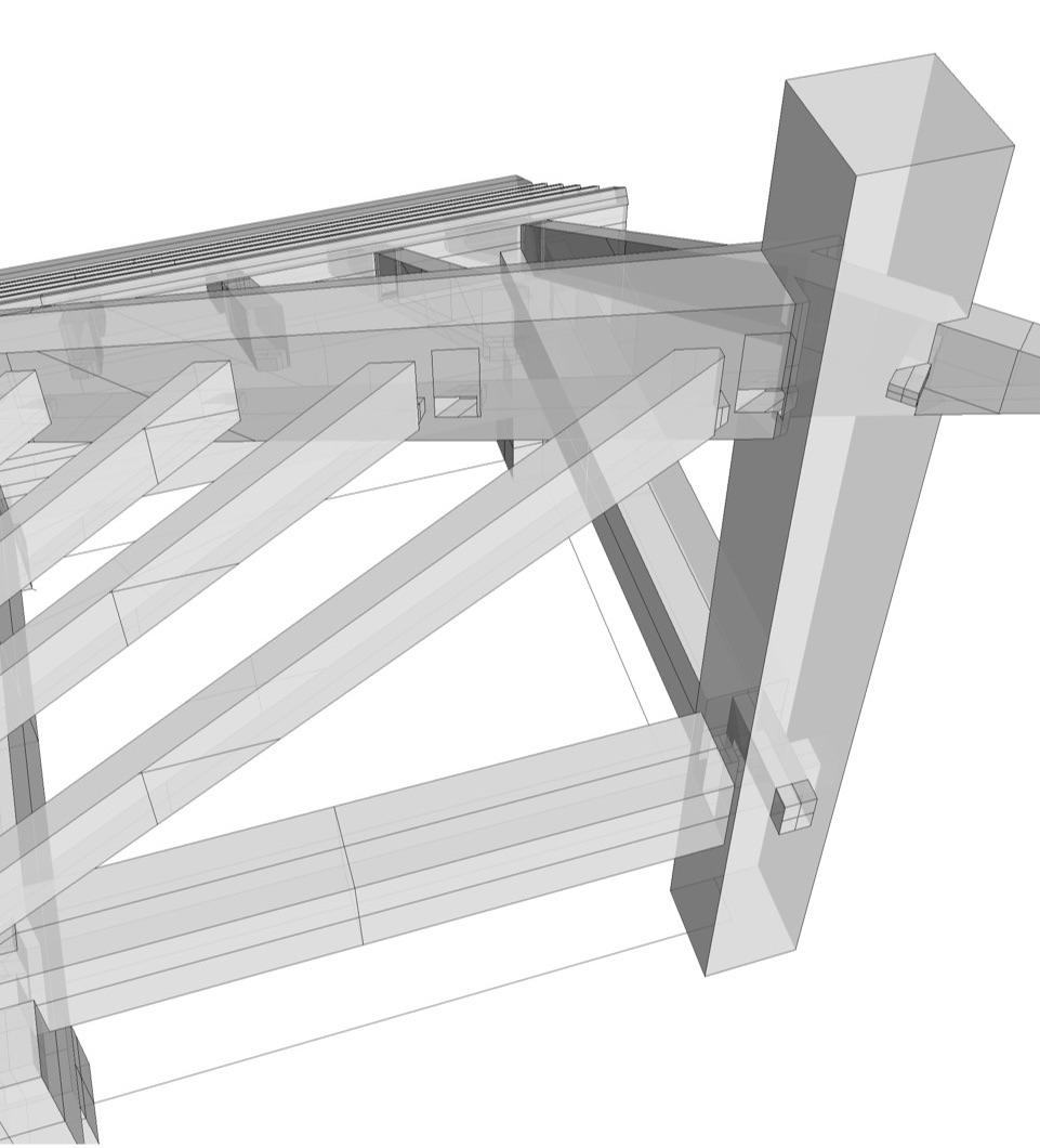

Anyway, nearly done now, just need to add the tenons to the jack rafters, along with their corresponding mortises on the hip rafter:
Steep Hip Model.jpg (140 KiB) Viewed 21005 times
Steep Hip 2.jpg (200.89 KiB) Viewed 21005 times

Well, with my elbow being in slow recovery mode, i need to keep myself away from the shop and thus I'm putting in a few hours learning Rhino.
Yesterday was not without its frustrations trying to get the jack rafter tenons done, but in the end, the model was completed. I think I will start drawing hip roof model #3 next, to try and cement some of the modest gains I have made.
Steep Hip Complete.jpg (129.27 KiB) Viewed 20976 times
Rhino can export to an .skp (Sketchup) file format, by the way, and it works fine when you open it up in SU, however nothing is exported as a Sketchup component, which means the model is a pile of planes which you'd have to stitch back together as components to make the file workable.

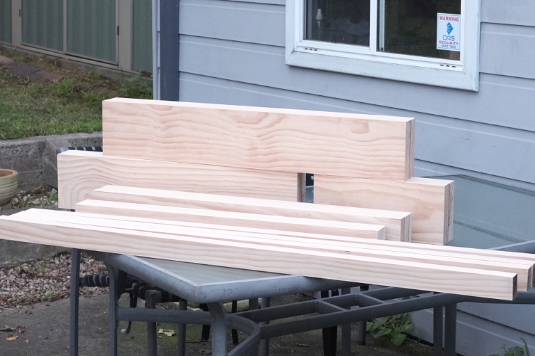

Progress report:
Three Keta pieces dimensioned and cut to length. Stub post stock dimensioned. Main post dimensioned. First bunch of rafter stock cut out but needs a couple of passes through the thicknesser (ran out of time today).
