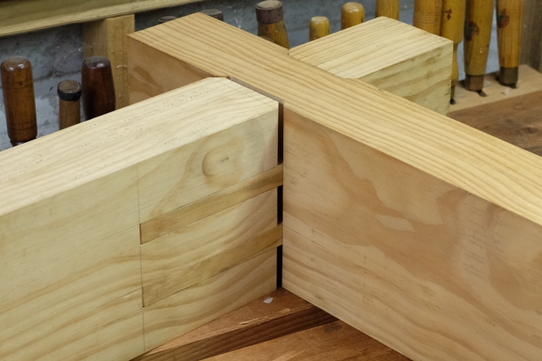

Yeah, it's a joint with long interfaces, which is one of the reasons it is such a strong connection. For ease of disassembly you should ease the mortises in the long keta piece at the very least. A chunk of wood and a small sledge can be helpful for knocking the parts away from one another.

Thanks Chris,
when the joint is closed up tight there would seem to be no bearing surface against which to apply force without marring surfaces. Are you suggesting levering the morticed Keta piece (with the long open mortices) away by knocking it away from the morticed side, thereby allowing the mitred surfaces to bear the leveraging forces?
I have inserted and removed the tenons from the mortices a couple of times and they are a little easier to insert however the tenons still require a lot of persuasion to insert to depth in the through morticed piece.

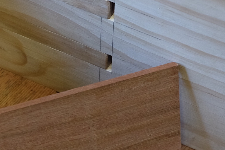

Ok, so a very judicious thinning of the tenons and a bit of a clean up of the through mortices on the large Keta piece and this joint is going together much easier now:
Albeit, a little error in the length measurement of the tenons is now obvious. A little more fine adjustment of the mitred abutments still required before it will close up completely as can be seen on the other side of the joint:

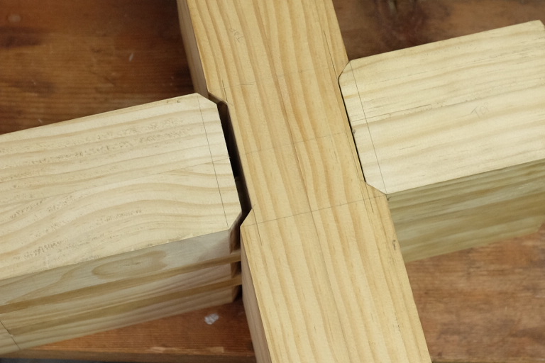

And from above:

Yeah, I thought from your previous set of pictures that the tenons were looking a hair long (or the mortises short). Be sure that when the connection is drawn up tight that there is a little space between the end of the tenon and the mortise end wall, 2~3mm typ.. I think, but I'm not sure without rereading, that I mentioned that detail in the last mailing - or it is at the very least, readily deduced from the sketches and the indicated dimensions for the parts. LMK if that's not how it's adding up for you in the layout.

Mortices too short as it turns out - I had referenced the measurement off the end of the piece, not the mitre line as the drawing showed, hence 10mm short. All rectified now. Chris, you have made reference to the need for a couple of mm clear space at the end of the tenon at various other points in time so there was no doubt about that fact. Many thanks.

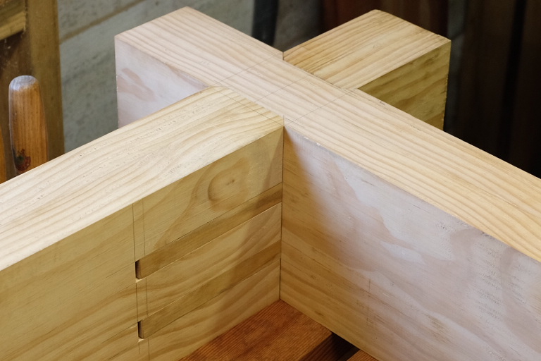

How the joint is looking now with the open mortices correctly dimensioned: A little trimming still required on the mitres but getting close: Some stray 'just shy of 6mm' stock that was minding its own business when I went looking for wedging material:

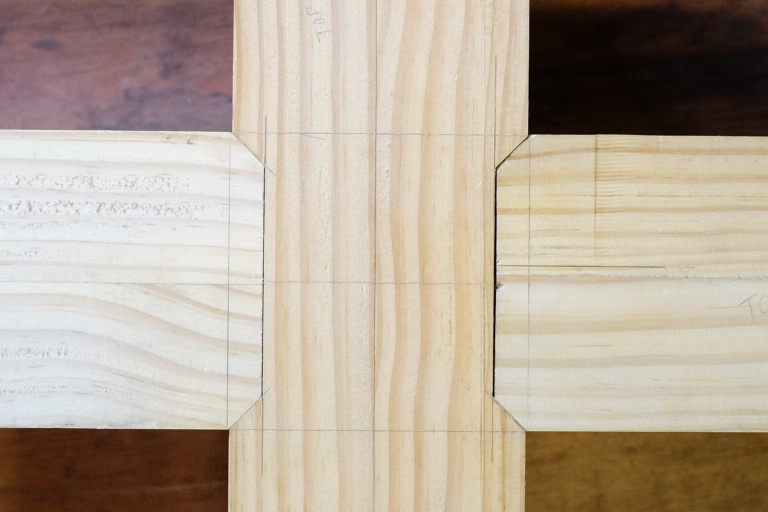

Well, I don't have much to show for myself at the end of this weekend. I spent what seemed like a lot of time trying to fine tune the mitred abutments for the Keta crossing, feeling mostly like I was going backwards. Lot's of variables go into that joint closing up nicely and it can be tough determining which is the limiting variable.
Otherwise I have some stock cut into the required parallelogram size and shape for the Shachi sen. I wanted to have the Keta intersection as tight as possible before cutting the Shachi Sen mortices.

Yes, 4-way mitered connections are a tricky matter and it can feel a lot like you are chasing your tail at times. As you do them more and more, they seem to get easier.
