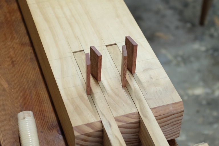

Finally I lightly inserted some pins:
The pins in the picture are actually slightly undersized and have no taper. I have some slightly larger stock which I will use to properly fit to the joint. That will have to wait to tomorrow.

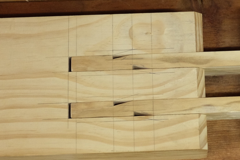

I hope I made mention in the mailing to make the shachi-sen with a bulbous/hook-shaped/barbed head to facilitate their removal.
Re: Hip Roof Model 2, mailing 2: keta intersection
Sun Jul 09, 2017 7:53 am
Chris, you did. My intention was to simply leave the sen over length, thus providing the necessary purchase to remove them. I only plan to drive them in finger tight. This has allowed me to fabricate them fairly quickly using the table saw, and focus on fitting the joint. I am cognisant of the fact that, historically, I make slow progress on these projects and I'm making a dedicated effort to keep things moving, for everyone's sake.

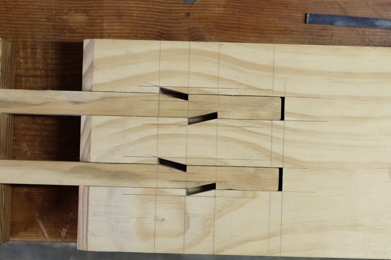

I assume that is why you prefer these joints to square pegs? These being a bit easier to fine tune exactly how much tension is applied, where square pegs being more of a guess.
Mon Jul 10, 2017 10:10 pm
The peg is a weaker link as it is subject to bending and shear loads, while the shachi sen is subject only to compression perpendicular to grain. Shachi sen make for a much stronger connection, and take advantage of the ramping effect as well, which makes them as you note, more tunable.

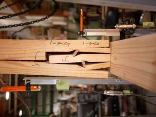

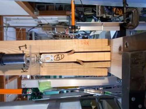

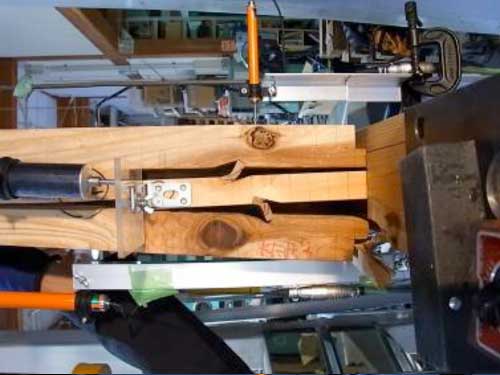

I think pins which break the relish portion when under tension are perhaps joints in which the tenons and relish should have been longer. Pegged connections are essentially best at dealing with compression, with the peg a mere keeper and device which allows for seasonal movement.

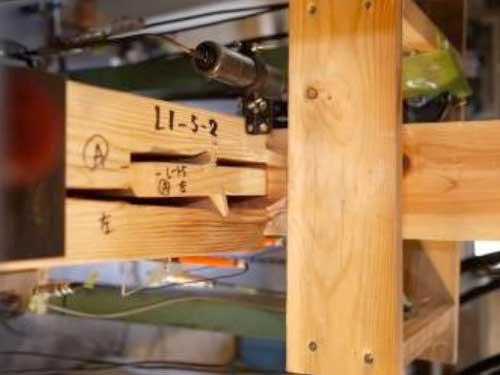

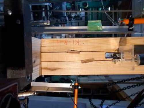

Under severe tension loading, a shachi-sen joint can actually suffer from the pins rotating in their mortises and inducing tension perpendicular to grain in the receiving pieces and thereby splitting them - this seems to happen well before parts of the receiving stick shear off :
