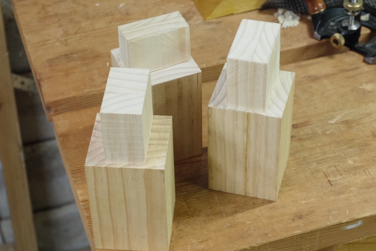

One Tsuka down to final dimensions, the other two rough cut:
Chris, the original parts list in this thread didn't appear to include any with the dimensions that would make a hip rafter - is there another piece to procure?

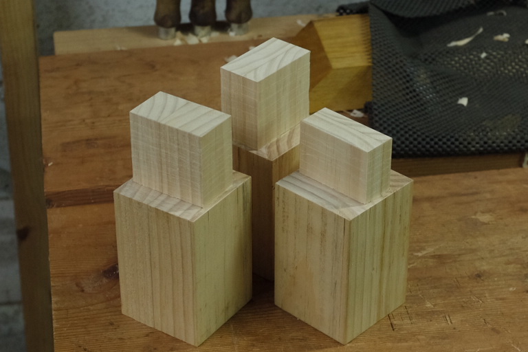

Tsuka complete:

Fri Feb 24, 2017 8:46 am
Looks good!
How are the keta pieces coming along?
Re: Hip Roof Model 2 - are you ready?
Sat Feb 25, 2017 5:45 am
All ready to go, please see photo at the bottom of page 2 :ugeek:
Sat Feb 25, 2017 7:50 am
Have you mortised for the tsuka? The outer ones I mean - and their peg mortises could also be done.
Mon Feb 27, 2017 7:35 am
No, have not done that yet, I will crack on.
