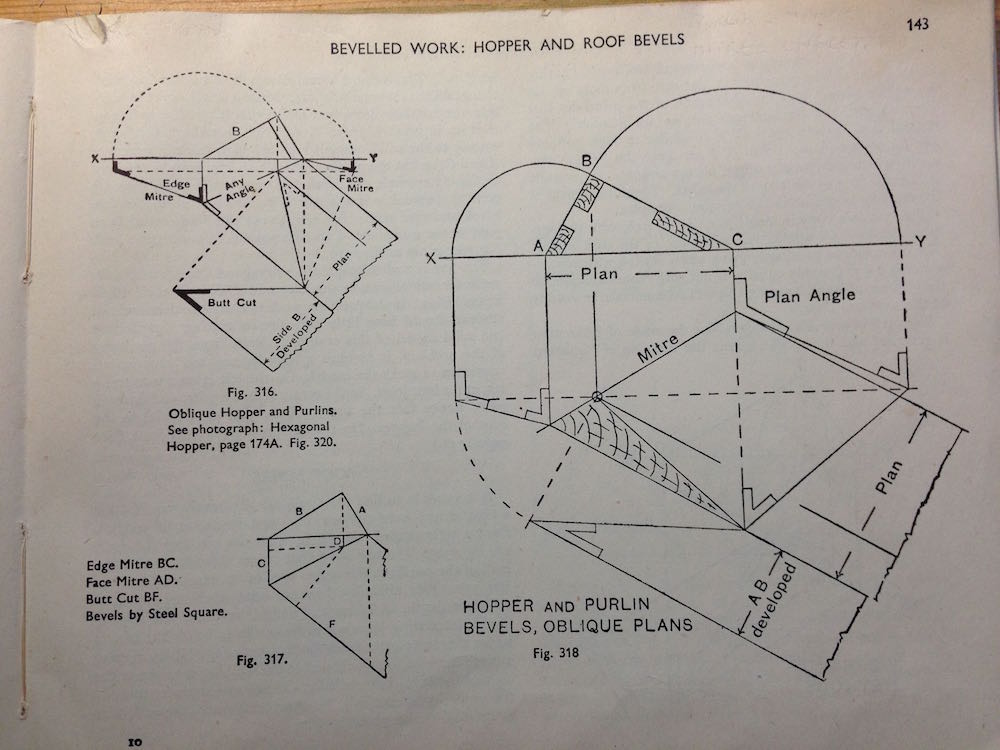

I think the best way to go is to take two pieces of wood, draw and cut. For exemple if you take your third picture, the hopper, it works for any angle in plan and section. ABCDI is the floor plan with a mitered joint BD. E is the cross section of your rectangular piece of wood. L is the miter angle of face IJ and H is the miter angle of face IF. This is a shop drawing and not very clear if you're not used to it. Let's say you can put any section of wood inside AJI with faces paralel to AI and IJ,the miter angles will always be the same. You have one more angle on this drawing which is JID the level cut if you want to bevel your hopper and this is the angle for your circular saw to rip the cut.

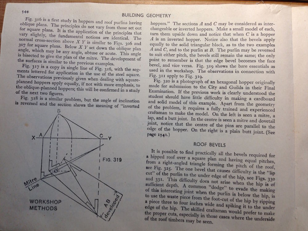

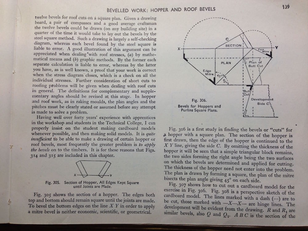

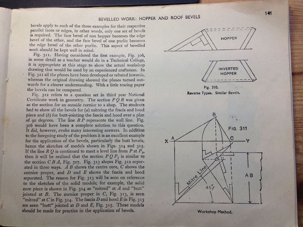

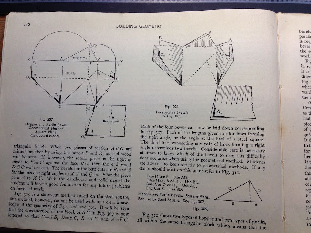

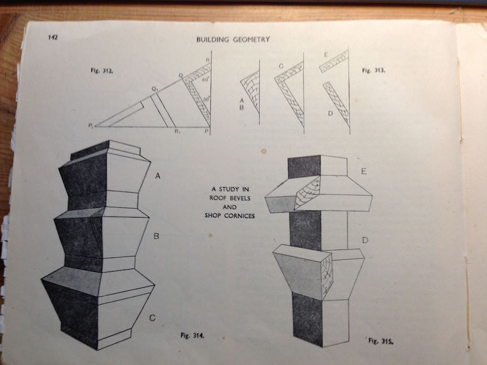

I started scanning a few things.
The one in English i prefer is: Building geometry by W.J.Stone, 1st published in 46, I found this copy in a book shop in Cairo back in the 80's! I think you can find it on ebay.
I scanned a few pages concerning the hopper.
Well the order of the pictures are to be reversed and I can't add more than 5!

Re: Theoretical woodworking
I like this book because it applies to a lot of trades, not strictly carpentry.
