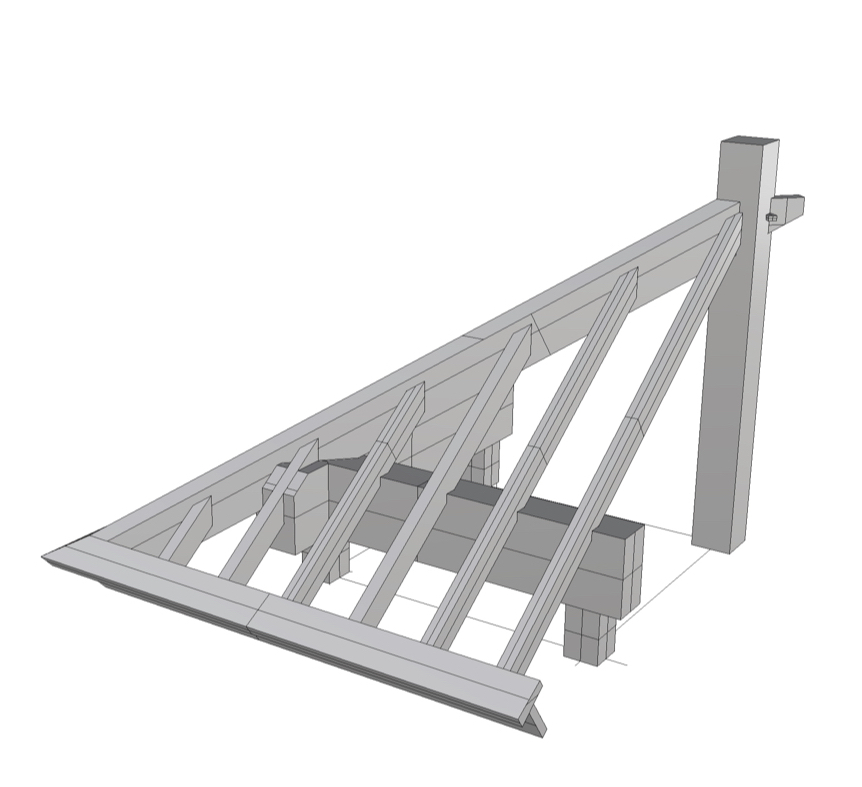

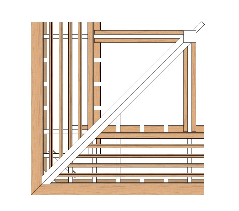

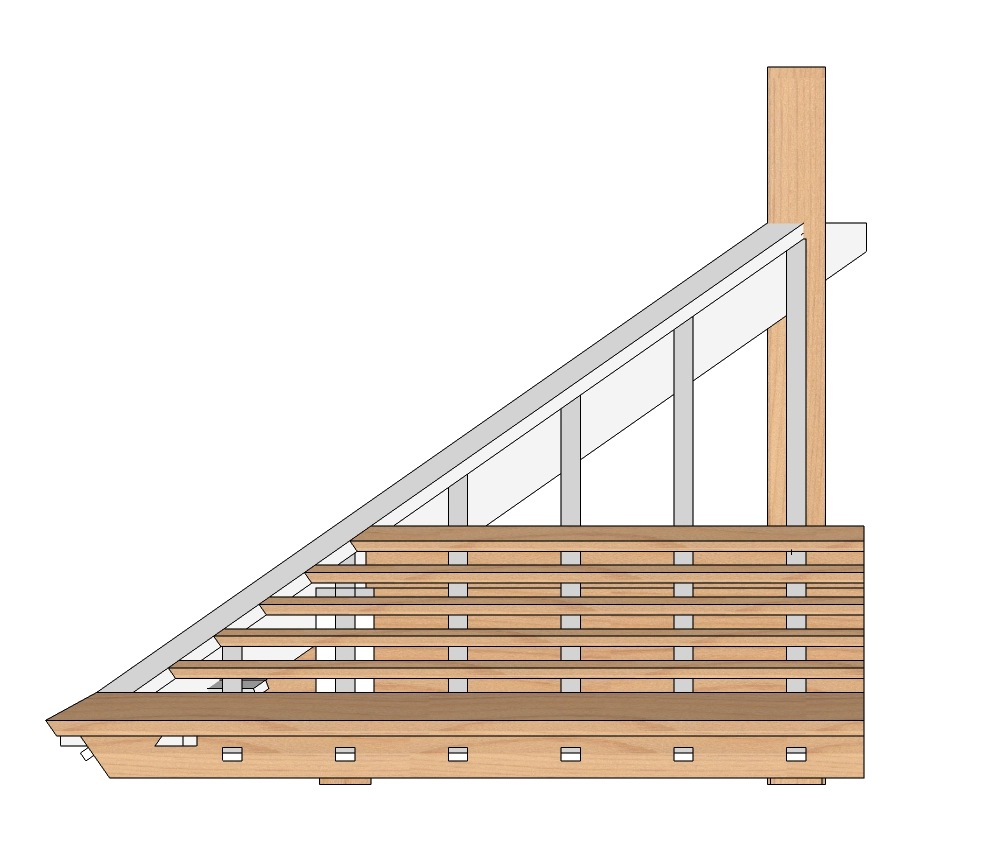

This second hip model, like the first, is regular plan, regular slope. There are many differences however. We'll be working with a steeper slope for one thing, and this will involve a layout offset in relation to the wall plates. The rafters will terminate in fascia on both ends and top, and the upper end of the hip will tenon into a post. The keta cross-over joint will be different, as will the rafter-to-hip connections. The hip rafter will feature some additional detailing as compared to the previous model. Also, we will be delving deeper into hiyodori, with a look at a couple of variants of hiyodori sen. Many of the involved timber sections are a bit larger than the previous model, however this is still considered a half-scale exercise.

Here's an overview of the new model - if you want to engage with this project, contact me for a material list. The first mailing should be out by the end of the month. Hope to see you there!
Steeply Pitched Hip Plan.jpg (155.48 KiB) Viewed 30299 times
Steeply Pitched Hip elevation.jpg (109.65 KiB) Viewed 30298 times

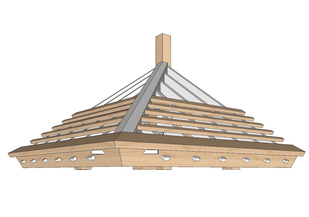

I've managed to draw 95% of it in Rhino now:
hip model in rhino.jpg (187.27 KiB) Viewed 30151 times
There are some powerful tools there, but it takes a good while to get the hang of things. I have tried at times to approach it like sketchup, and found that doesn't work so well at all. :oops:
Won't take too long though to get the rest of the parts on there. The next mailing will probably have a mix of pictures from both softwares.

If you're still drawing with surface meshes (like SU) I think that's a mistake. I think Rhino will really be great should you decide to use it for your metalwork, with all of its organic surfaces. It should also work well with curved members/logs. However for rectilinear objects like TAJCD projects I think a solid modeler like SolidWorks or Inventor might've been easier to learn - albeit at a hefty price.
