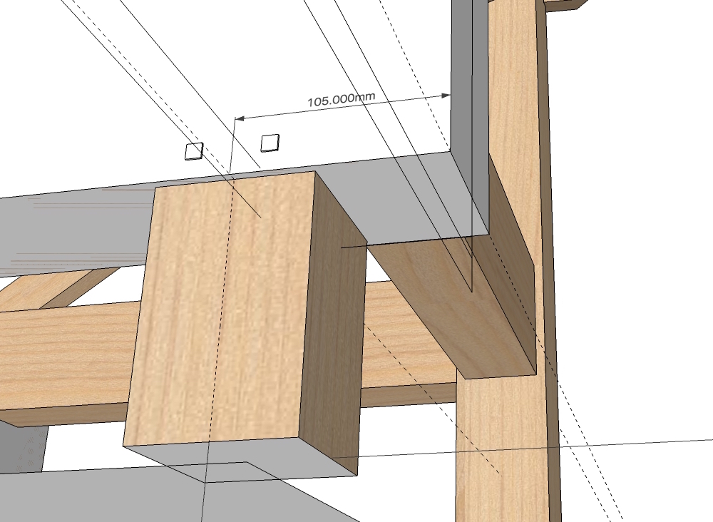

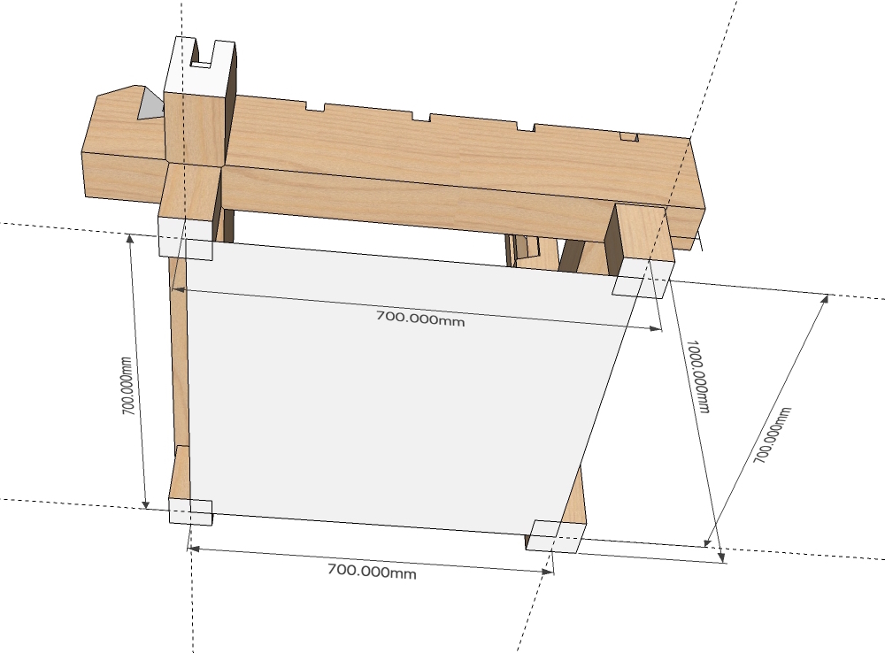

I thought it was included with the .pdf I sent, but in any case, here it is:
Steeply Pitched Hip underview.jpg (198.25 KiB) Viewed 20138 times
This one will be helpful too:
Steeply Pitched Hip tsuka offset.jpg (292.92 KiB) Viewed 20138 times
Re: Hip Roof Model 2, Mailing 1
Posted: Sun Apr 02, 2017 6:23 pm
by Yxoc
Many thanks.
