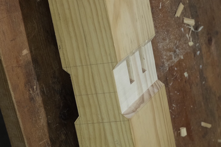

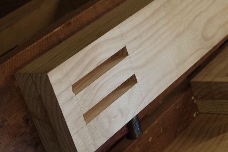

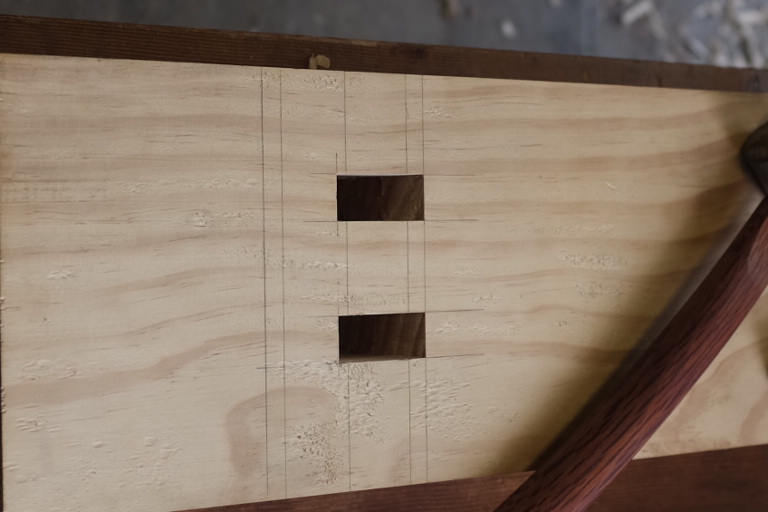

I started with the morticed piece. I drilled and pared the mortices first:

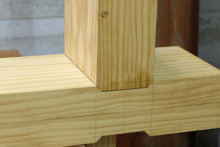

After I was happy the mortices went squarely through the main Keta member along their whole length, I started the cheek recesses that take the cross Keta, first marking out the depth of the mitred abutments:
Then cut out ensued:
The mitres are cut well shy of the line at this stage. Some carelessness with the chisel blowing out some wood near one of the mortices mars an otherwise nice surface.
More to come over the next week.

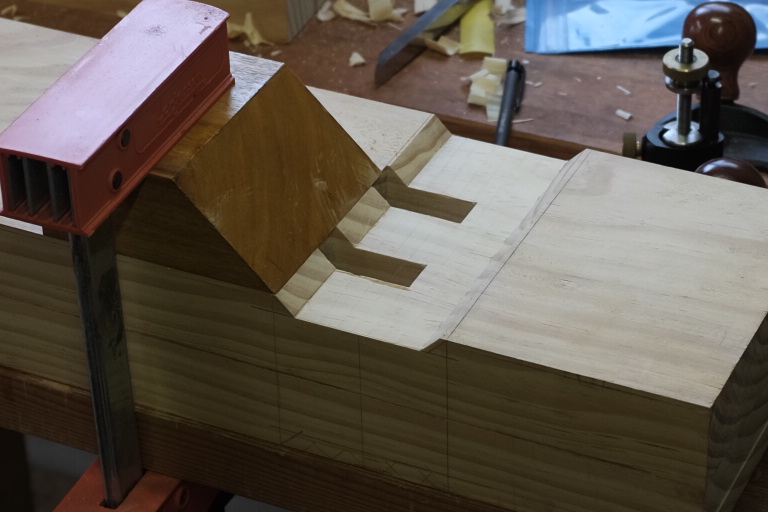

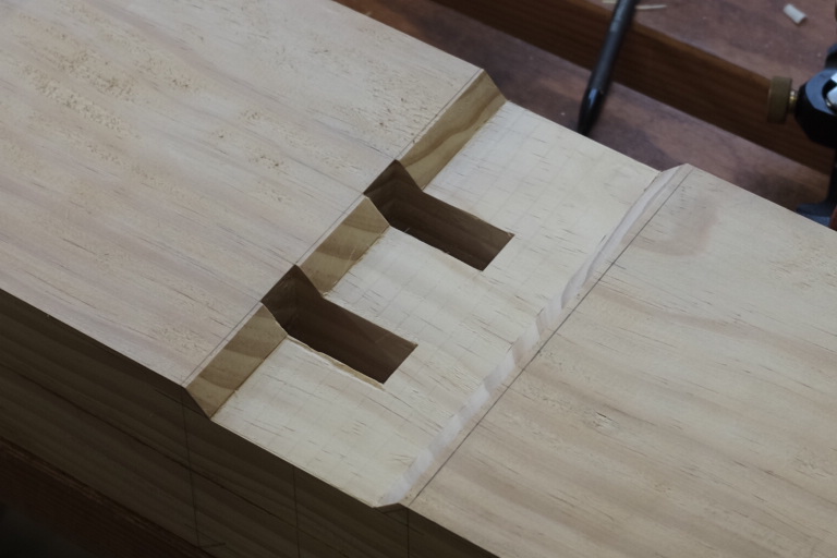

Both cheeks of the main Keta piece cut now, both still with bucket loads of room to manoeuvre on the mitred abutments:
Re: Hip Roof Model 2, mailing 2: keta intersection
Sun May 21, 2017 5:32 pm
The trenches to receive the cross piece tenons have been mostly cut - still a couple of mm shy of final depth. It's a stopped groove at the moment because I haven't cut this piece to length yet:

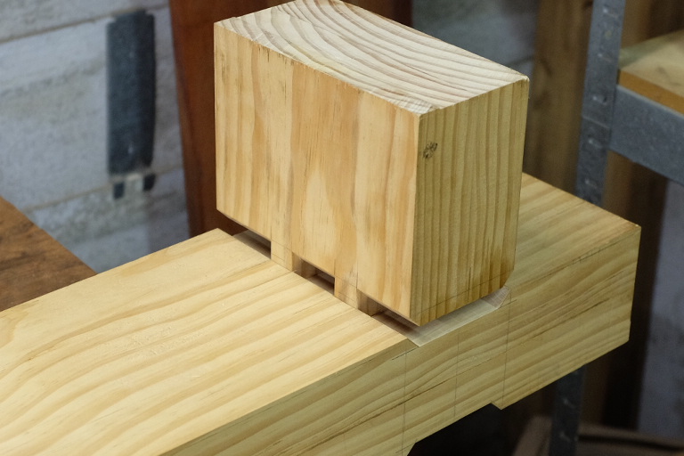

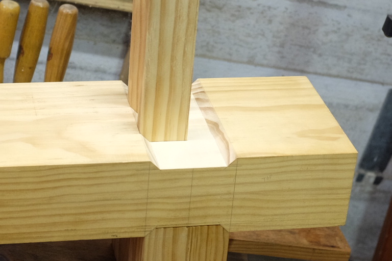

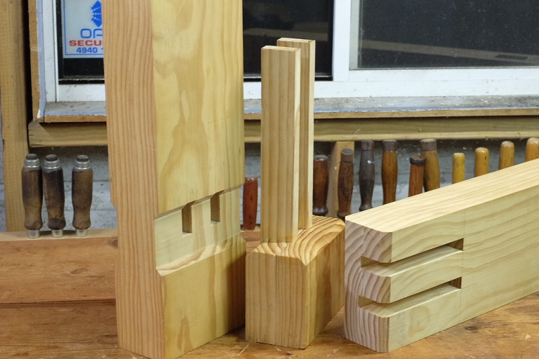

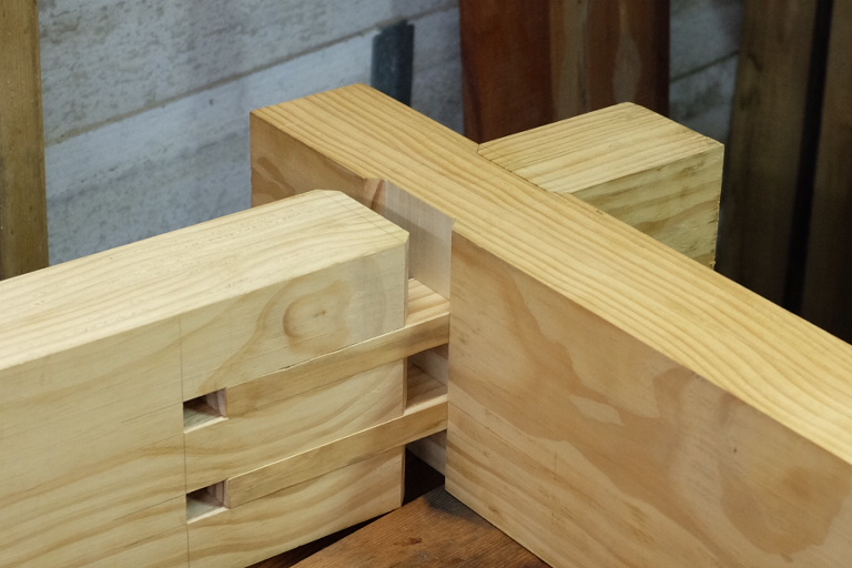

First trial fitting and despite measured dimensions being satisfactory, there is still enormous friction inserting the tenoned piece. Here shown pretty close to fully inserted:
And here as closed as it can be without fine tuning of the mitred abutments:
Tenons passing through the other side:
And here with the morticed piece. This was as close as I dared close up the joint for fear of needing excessive force to get it apart:
Still a little more needs to come off the tenons such that the pieces will assemble with only reasonable pressure.
