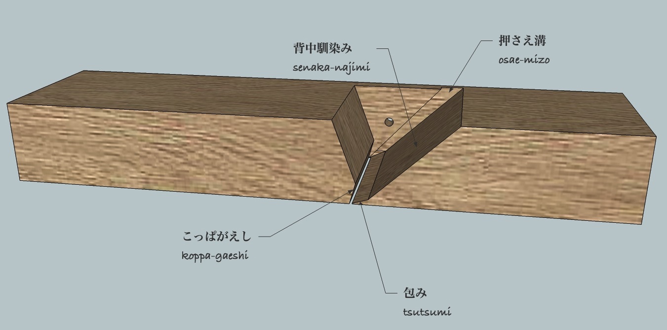

Here's a look at the dai with a portion cut away so a few more spots can be labeled in the blade opening (itself termed the kō-ana (甲穴), lit. the carapace opening:
kanna anatomy 2.jpg (119.8 KiB) Viewed 100626 times
The tsutsumi treatment is usually found only on high class dai for finishing planes with a very tight mouth opening. Such plane blocks are termed tsutsumi-dai (包み台), or, tsutsumi-guchi (包み口). Standard plane blocks without the ledge are termed futsū-dai (普通台) and are perfectly fine for use and less hassle to set up and tune.

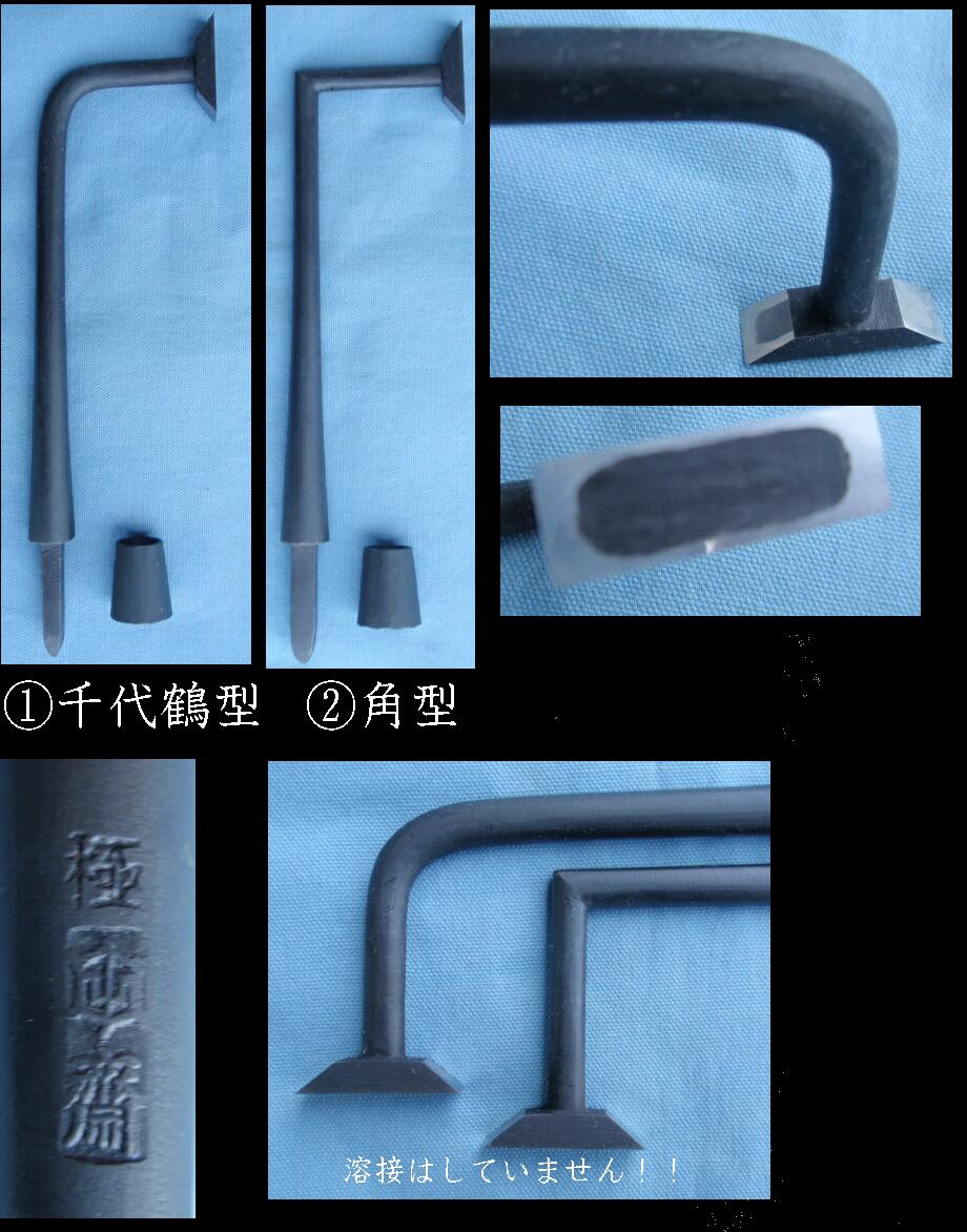

Preparing/adjusting the tsutsumi ledge surface properly is done most conveniently with a special crank-neck chisel, like this one:
田斎 両口コテ鑿.jpg (150.72 KiB) Viewed 100626 times
The one pictured is made by Tasai and is unusual in that it cuts in both directions. More common is the type with the cutting edge only on one end of the tool.

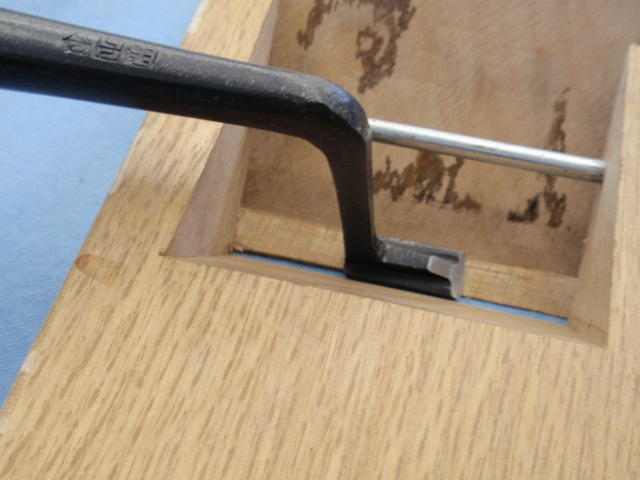

The more conventional version of the tool, also made by Tasai, in action:
