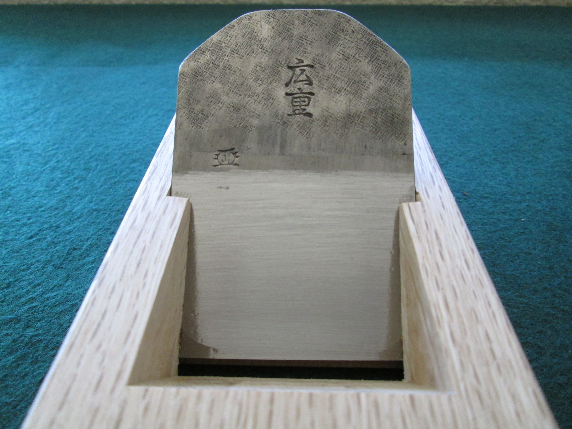

Here'a a koganna by Yamamoto-san I recently got; it'a a 58mm Hiroshige, said to be VAR White Steel #1, not yet set up (hope the image appears):
/Users/macuser/Desktop/Hiroshige 58.JPG
It looks like it will be a pretty straightforward job, and I look forward to its test-drive.

Trying again with image:
- Hiroshige 58.JPG (691.55 KiB) Viewed 29910 times
Re: Kanna for softwood finish?
Beautiful plane! Very nice, I'm sure you are chomping at the bit to set that up!
