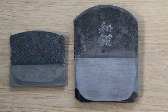

Those kanji, 和鋼, would be read wakō, meaning Japanese steel. Are you sure the reading is supposed to be kon? If so it is a non-standard reading.

Hi Chris, I think you are right with your reading of the kanjis.
Ernest, you have a interesting second name for this forum! It was very hard to find a tamahagane-blade. Therefore I wrote to Iida-san some years ago. After a long time he told me that he had found a piece of good quality. So Tsunesaburo made this blade for me. The blade is easy to sharpen and works very well. You can use it for soft and hard wood - even for Wengé. Only a HSS-blade is more tough and much more budget-priced.
