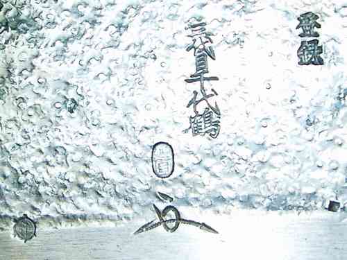

That pair of characters is read tō-roku. Below is an example, on one of the blacksmith Chiyozuru's (千代鶴) plane blades - spot the kanji saying tō-roku at the upper right of the blade in the first picture.

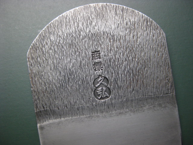

In the second picture, we see a blade in which the first two characters 商標, shō-hyō, meaning 'trademark', are used only.

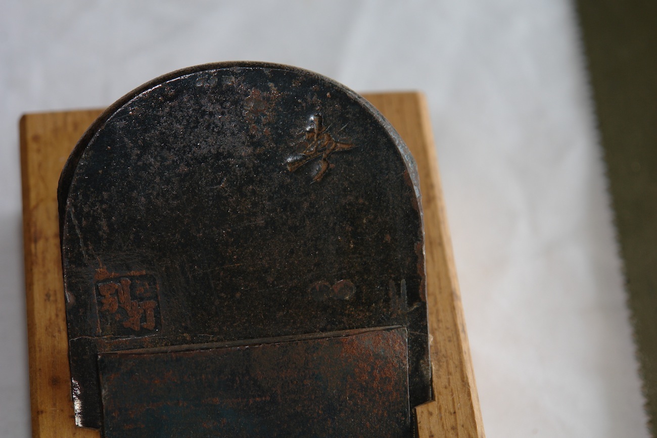

here is a shot of a japanese plane i just picked up here. it's got a lot of superficial oxidation, but the blade is still in good shape (blue steel) and it's being worked on right now, but i got it for a bottle of suntory whiskey. can't beat that price.
anyone have any ideas on the maker? the rust actually makes it a little easier to read. ; /

Well, I can't quite make out the kanji stamped on the right side, but on the left there is 別打, "betsu-uchi", which means specially forged.
