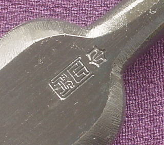

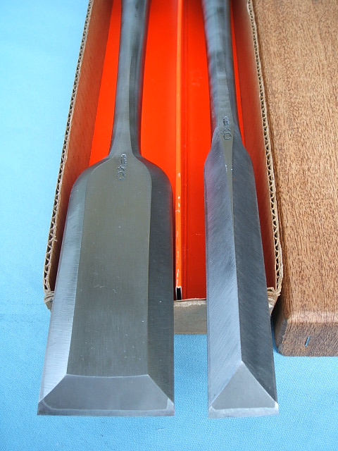

B. 梵字 Bonkaku
bonkaku mentori 梵字.JPG (45.26 KiB) Viewed 53301 times
bonkaku 梵字.JPG (38.68 KiB) Viewed 53301 times

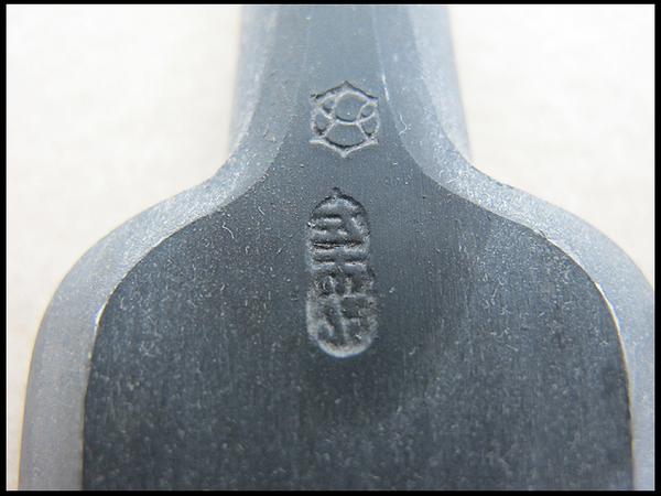

C.

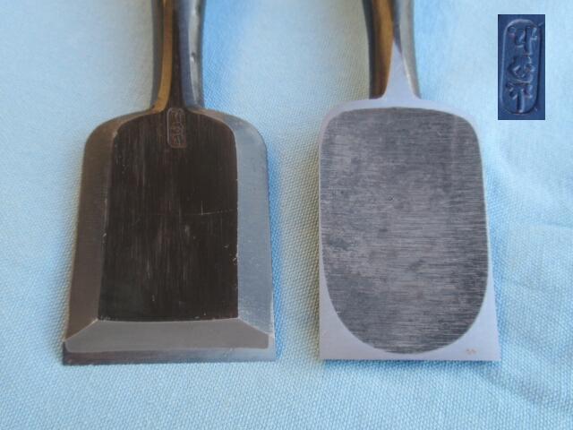

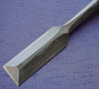

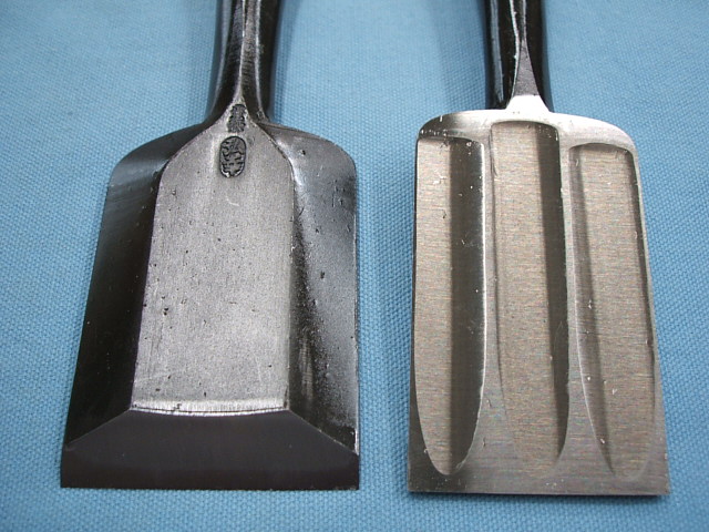

D. 太進 Daishin
daishin 太進.JPG (113.42 KiB) Viewed 53297 times

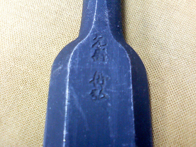

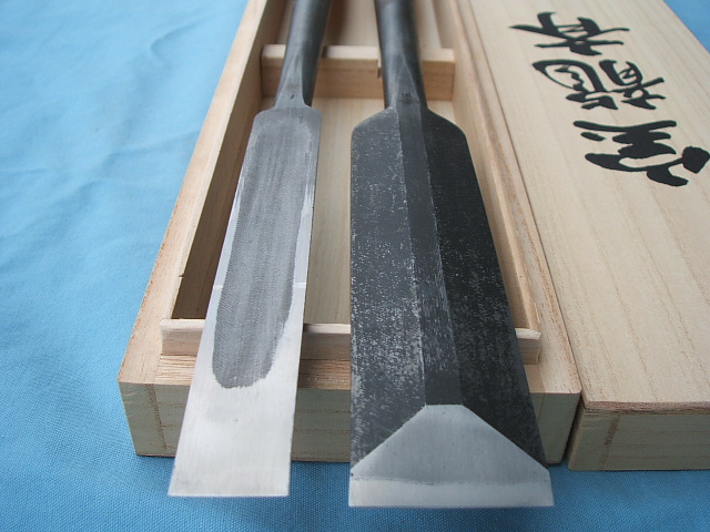

G. 元寿舟弘 Genjū Funahiro, the work of the celebrated blacksmith Funatsu, Yuji (船津祐司), hailing from Echigo-Yoita, a traditional craft center in the village of Yoita in Niigata Prefecture.
Genjū Funahiro mei
Genjū Funahiro Mei

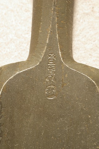

H. 左市弘 Hidari Ichihiro. There's some curious history to the Ichihiro brand name. Early on it was called 'tsuki-ichihiro' (月市弘), the prefix tsuki (月) meaning moon. The maker's mark, or mei (銘) featured a gourd-outline with the characters stamped within. An example of that mark is found among the pictures below. Also you will see, above or below the mei, another registered stamp, which is the mark of the Tōkyō Guild of Blacksmiths.
Along the way, apparently, Yamazaki forge work was in such high esteem that another company in the late 1940's - Natori Trading - registered the brand name 'ichihiro' (at a point before Yamazaki had thought to do so) and produced inferior knock-offs. So Ichihiro, unable to register his name 'Ichihiro', registered 'hidari Ichihiro' instead - the left ichihiro.
To further distinguish his brand, the mei which was stamped into the tools was in mirror image - see the stamp shown in the second to last picture below. This mirror-imaging is a bit confusing for those not entirely savvy with looking up Japanese characters - unless you recognized the mirror inversion of the kanji, one would have an impossible time looking up the characters in a dictionary.

Yamazaki
'Hidari Ichihiro' reversed stamp
'Tsuki Ichihiro' maker's mark
Ichihiro mei .jpg (44.29 KiB) Viewed 53300 times
Ichihiro mei 2.jpg (32.95 KiB) Viewed 53300 times

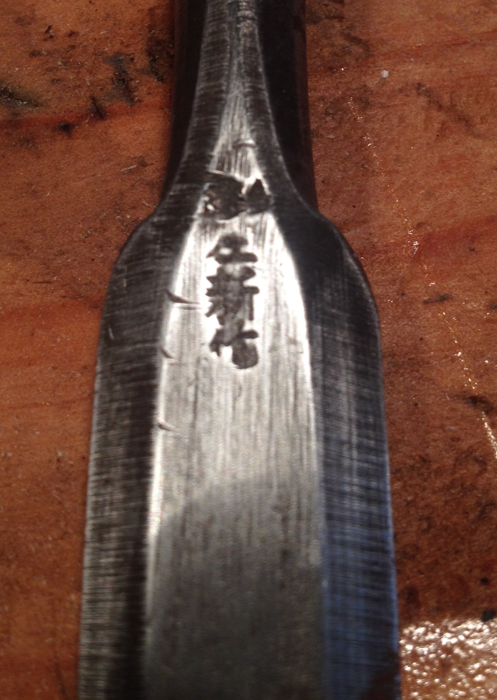

左新作 Hidari-shinsaku
Simply a brand name. The smith's name for that brand is Miyawaki, and the chisel is likely more than 65 years old. Likely to be White Steel #2.

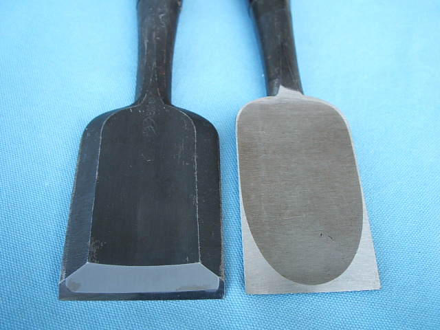

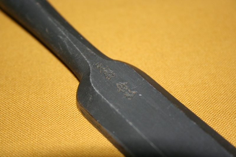

久次郎 Hisajiro
hisajirou 久次郎.JPG (107.96 KiB) Viewed 53301 times
久国 Hisakuni
hisakuni (久国).JPG (106.2 KiB) Viewed 53301 times

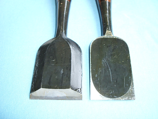

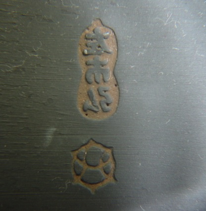

I. 市芳 Ichiyoshi
ichiyoshi 市芳.JPG (103.83 KiB) Viewed 53301 times

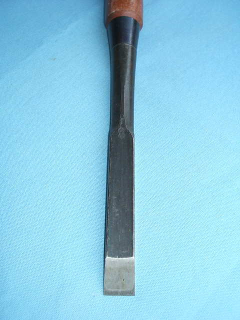

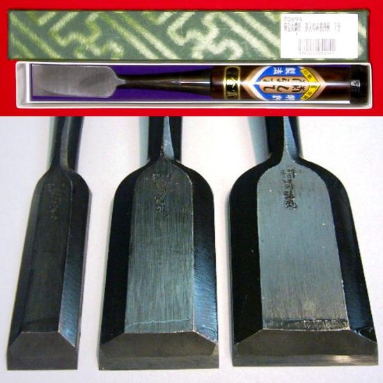

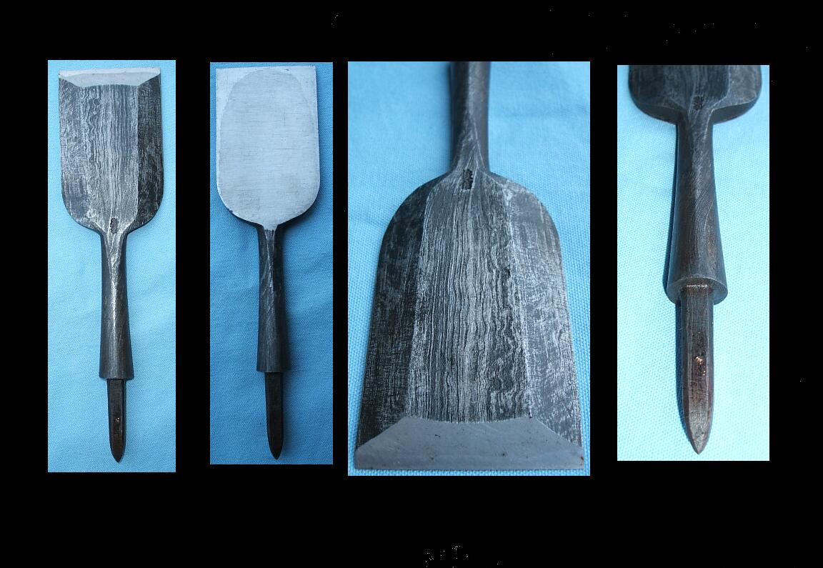

菊弘丸 Kikuhiromaru Hitachi White Steel #2
"KikuhiroMaru no shigotonin.jpg (25.4 KiB) Viewed 53296 times

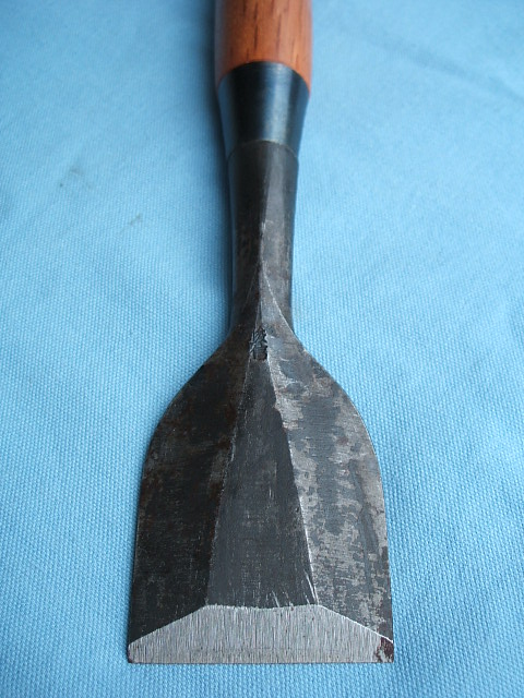

国慶 Kunikei Smith's actual name is Ikeda (池田慶郎).
kunikei (國慶).JPG (137.63 KiB) Viewed 53297 times

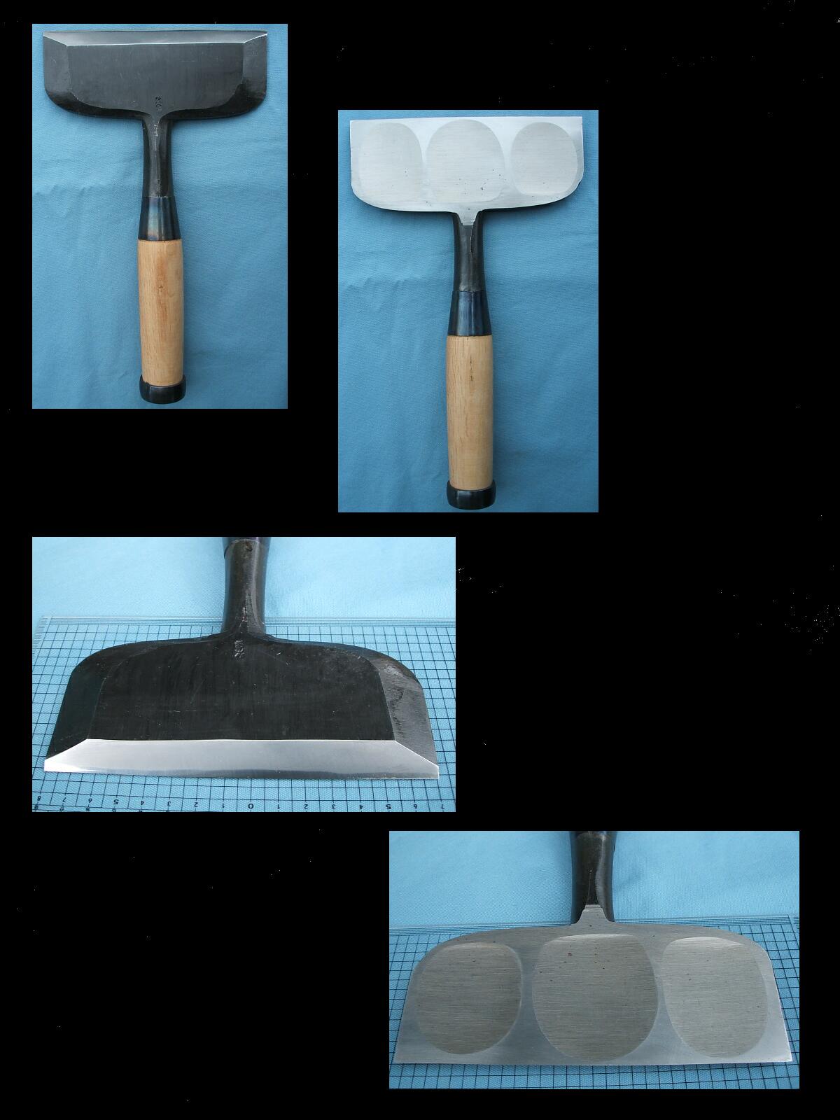

正よし Masayoshi These are some 'chunky' chisels!

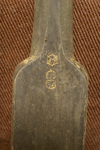

N. 長弘 Nagahiro

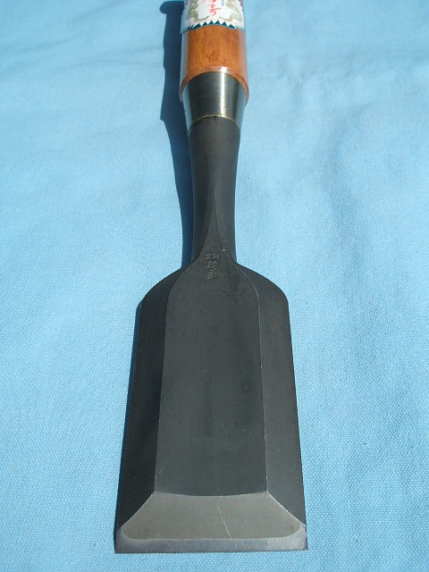

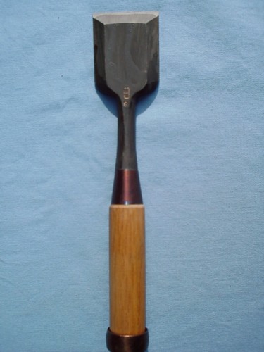

徳綱 Noritsuna
noritsuna 徳綱.JPG (112.73 KiB) Viewed 53299 times

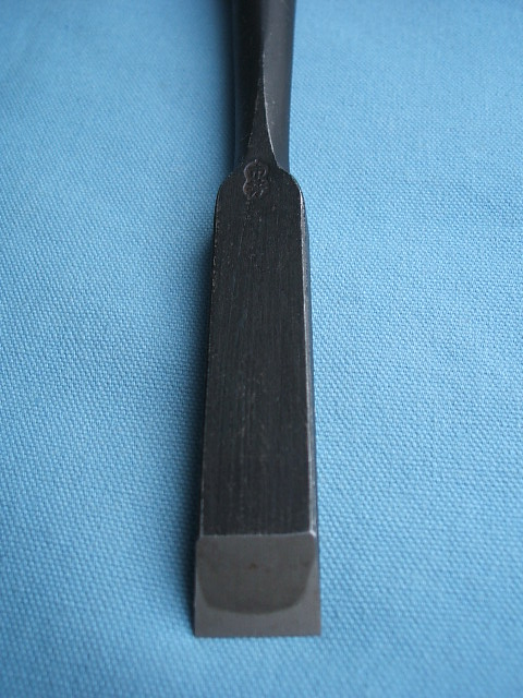

S. 忍 Shinobu
shinobu 忍.JPG (111.3 KiB) Viewed 53296 times

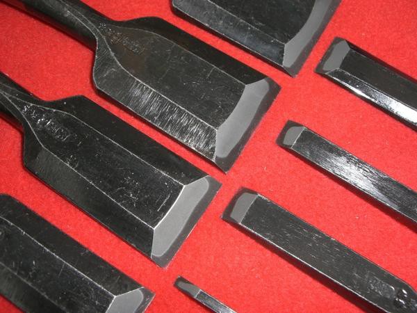

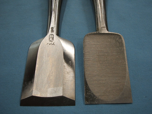

助丸 Sukemaru The upper one is made from HSS
sukemaru 助丸.JPG (112.13 KiB) Viewed 53297 times
sukemaru sword mark 助丸.JPG (110.99 KiB) Viewed 53299 times

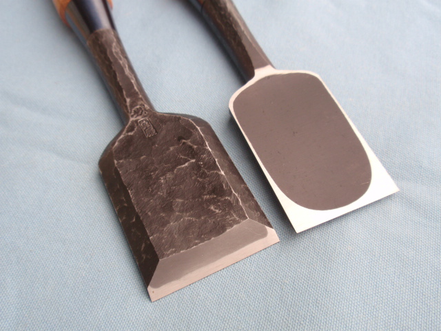

T. 孝弘 Takahiro A brand of the blacksmith Maruzan (圓山) living in Urawa City (浦和市), Saitama Prefecture (埼玉県)
takahiro 孝弘.JPG (110.69 KiB) Viewed 53296 times

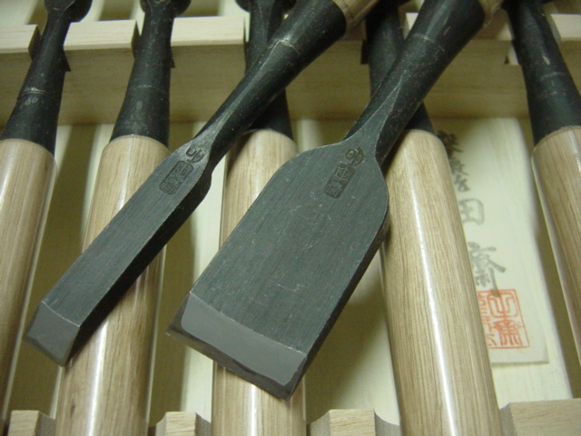

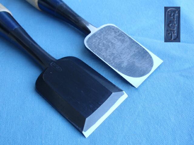

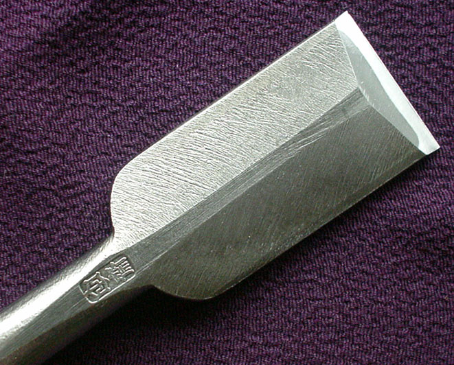

田齋 Tasai. This forge is run by a father and son team, Aki-o (田斎明夫) and Michi-o (田斎道生). Like Funahiro, they are based in Echigo-Yoita in Niigata. A couple of examples of Tasai's chisels, the first with a hand-filed finish. Tasai is also famous for their wood-grain "moku-me" decorated chisels:
Michio (L) and Akio (R) Tasai
tasai sinogi upup .jpg (139.97 KiB) Viewed 53434 times
Tasai's mei

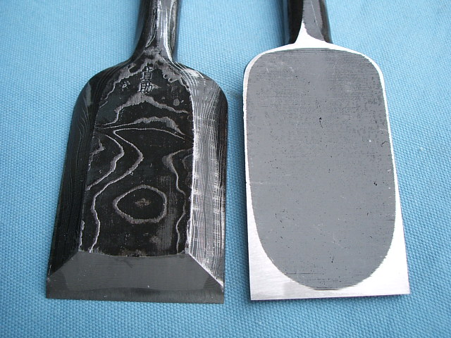

貞助 Teisuke
teisuke 貞助.JPG (111.32 KiB) Viewed 53296 times

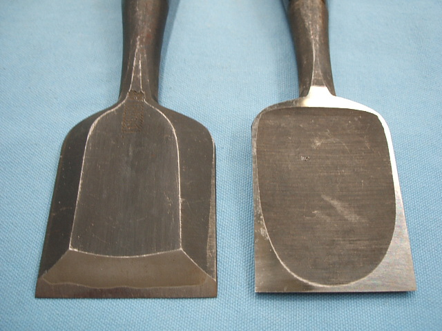

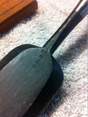

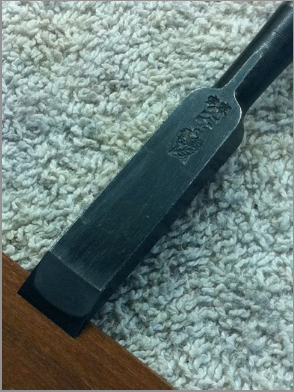

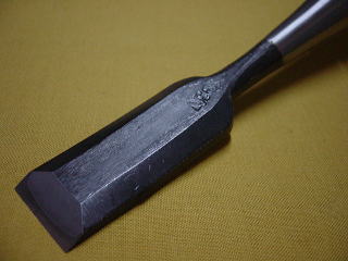

i have chisels from 2 makers
the wide slick made by kiyomi nishiki ,
the bench chisel ouchi white steel #1
Screen shot 2011-06-28 at 8.34.53 PM.png (224.94 KiB) Viewed 53421 times
Screen shot 2011-06-28 at 8.33.19 PM.png (206.17 KiB) Viewed 53421 times
