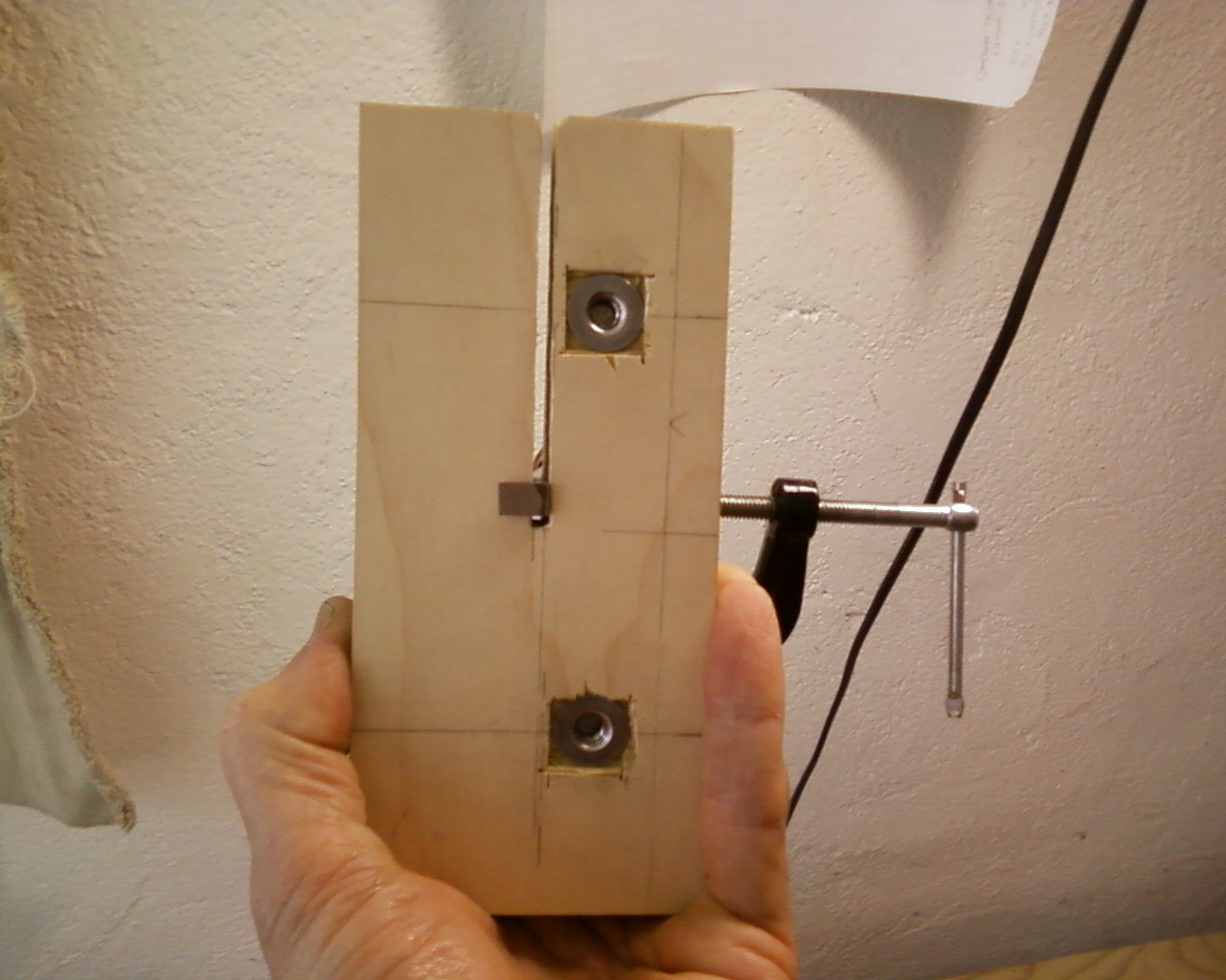

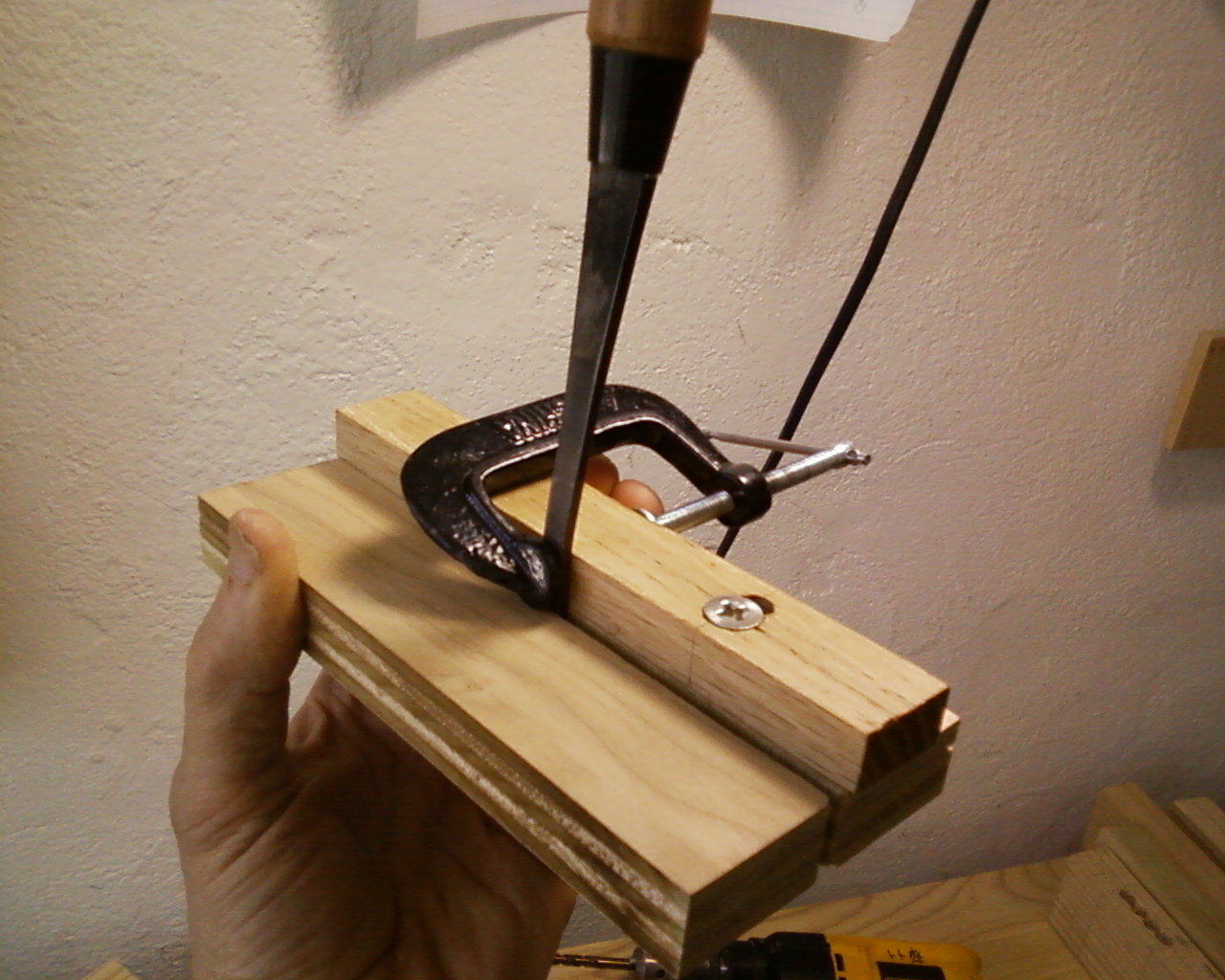

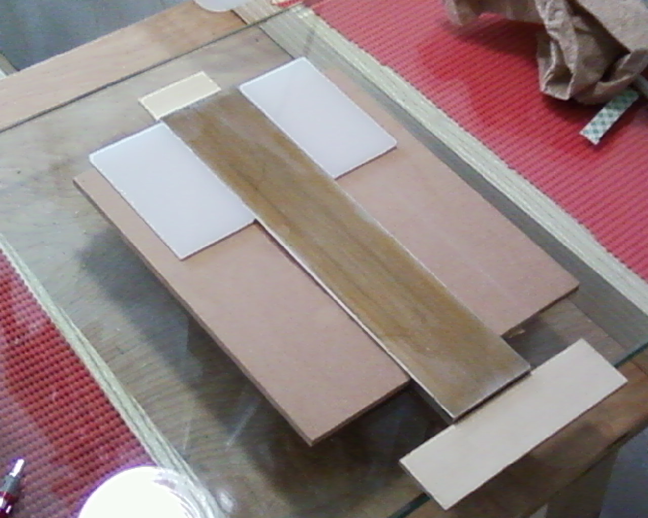

Follow up: a question about sharpening a bottom-cleaning chi
Hi Chris,
I spent some time Sunday browsing for small stones online, but I could see that it was going to take some time find stones that would fit the bill. So Monday, in a fit of impatience, I decided to use what I had at hand, and build the jig you suggested but use it upside down. A bit rough, but it worked. The foot was rounded at the center, and I did get it flat fairly quickly, but I think my earlier free-hand attempt changed the angle of the foot and bevel. So the cutting edge is now too acute--it cuts, but the edge is too fragile. I will have to adjust the bevel. Sorry for the poor photo quality: I used my old-school cell phone to take the pictures. Whether this is a positive example or a negative example...well...
Not pictured is a small strip of wood that I attached to the small rail with double stick tape to keep the chisel upright. The sharpening surface is a DMT fine diamond plate. I moved the jig and the two squares of plexiglass across 1/2" MDF held down with double stick tape.
Re: A question about sharpening a bottom-cleaning chisel
Good job! The only thing I might change on that jig would be to attach a 'fin' and second clamp, to the bottom, so that a wedge could be slid in between it and the edge of the chisel to fine tune the side-to-side tilt of the tool. I would worry that a single clamp could let the tool squirm a bit while sharpening, but maybe I'm just paranoid
. Looks like you're getting the job done though!
