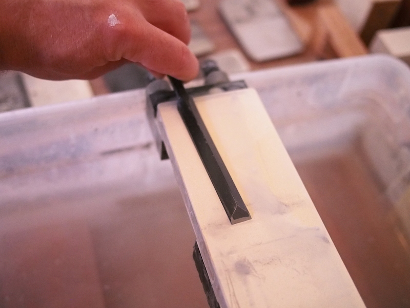

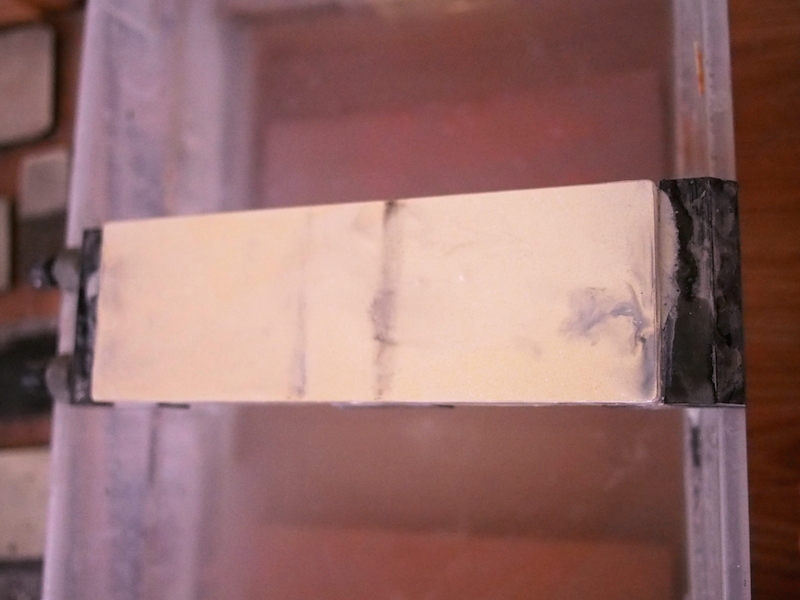

Here's what I found (these are the Fujihiro chisels from Hidatool: blacksmith = Imai)
All three have similar scratch patterns on the stone and on their ura. They are sizes 6, 12 & 30 mm
Here are some pictures to show the results
Stone for the 6mm
Picture of 6 on the stone

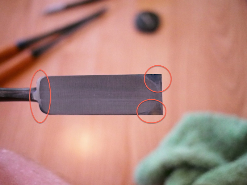

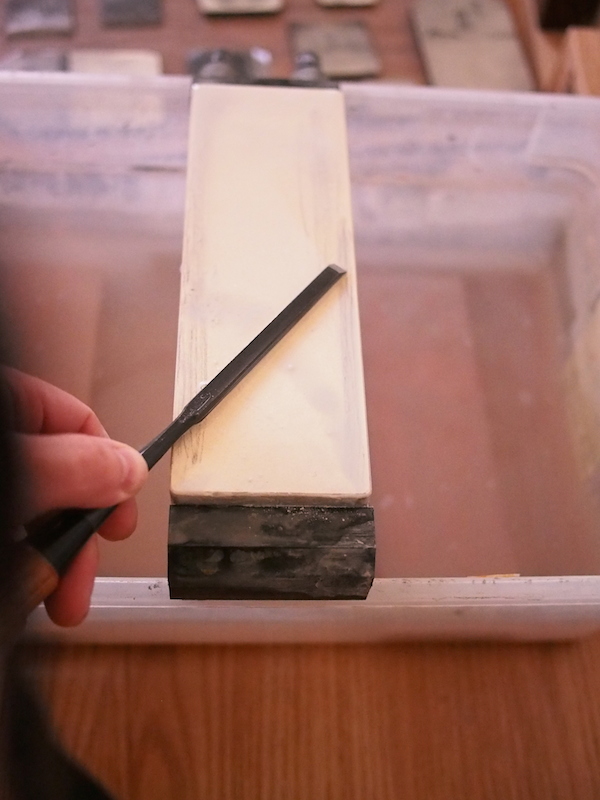

12mm on the stone
12 mm rub areas
Rub pattern for the 12 on the stone. Ran it perpendicular to the stone
more to follow... (5 maximum attachment limit)

continuing with the 30mm...

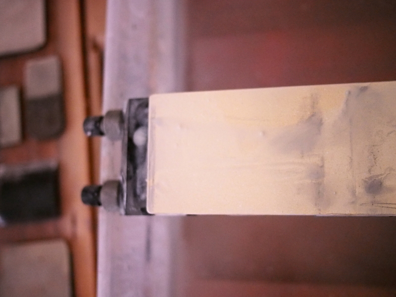

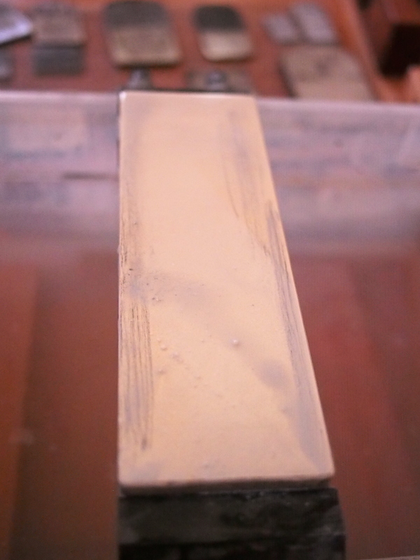

30mm marks left on stone

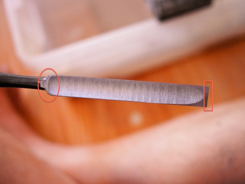

Rub marks on the 30mm
The only unique thing about the 30mm was that it didn't fully rub across the front length but I'm guessing the amount of flattening that needs to occur on the courser stones will take care of that as there appeared to be a very small separation between the marks.

With that pattern, the situation you have is a blade that has slightly cupped after forging. Same thing happens to plane blades in many cases. So yep, the solution is the same as I showed on my blog in the plane set up series- wrap the middle of the chisel blade in UHMW tape and work the front 10mm or so until it is decked. You'll probably have to re-wrap with the tape several times. The key is to work only the last cm or so of the blade on the stone, and place finger pressure on that last section only. The portion with the UHMW tape will glide lightly over the stone surface.
You can recheck your progress by rubbing the entire back (sans tape) on a finish stone and checking the scratch pattern. When you have something fairly even, you can then work the blade on a medium and finish stone. Make sense? By the time you are done you should have a decently large ura-suki on the chisel behind the cutting edge.
