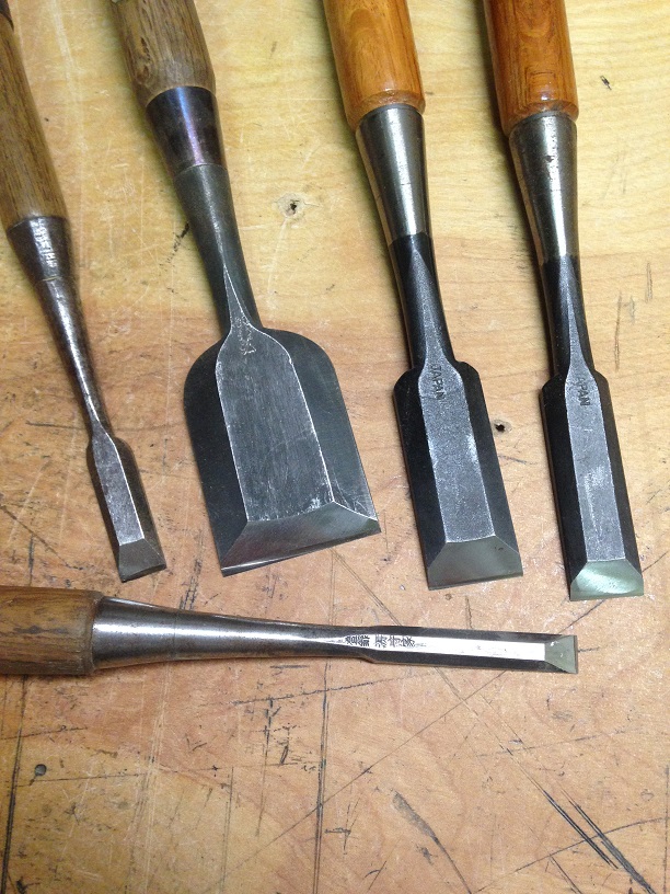

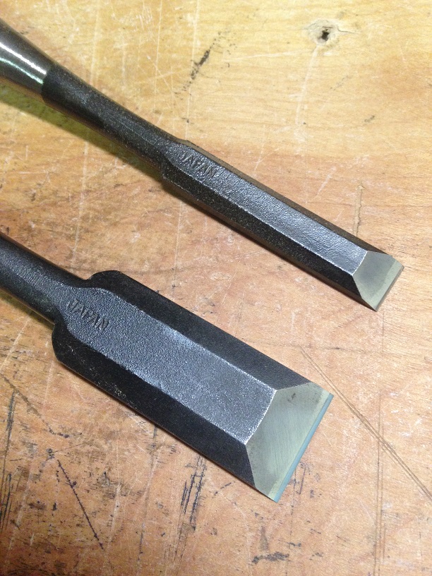

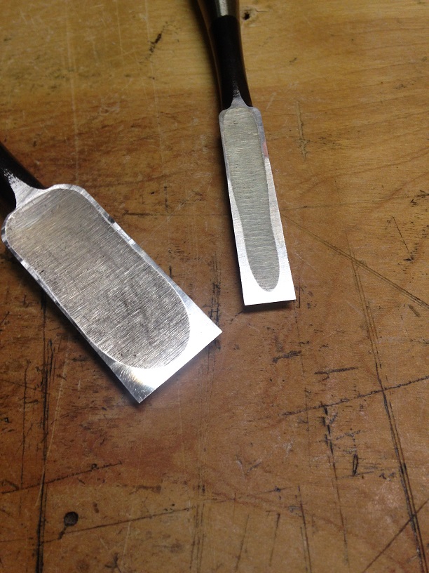

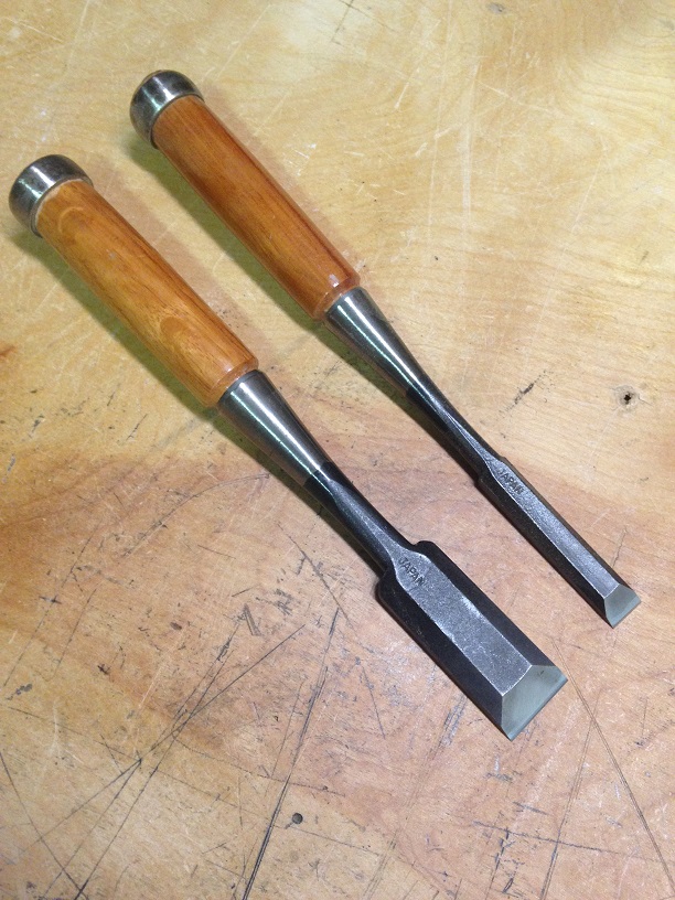

Over the years I have picked up a large number of low end Japanese chisels (ebay and garage sales) that perform very well. They simply say "Japan" on them. They are not finished as well as my other Japanese chisels but I use them a lot and see no reason to replace them any time soon. They hold an edge very well. I have about 15 or so and they are not as pretty as my other chisels (that is for sure) but I have no problem recommending them based on their performance. Some of these chisels I have had for 30yrs and they have held up very well.
The reason I am posting here is not to say that low end chisels are the best - far from it. What I am saying is until you can afford the best there are a lot of other good chisels you can afford until then.
I don't read kanji so the 3 chisels in the bottom picture (on the left and bottom of pic) are left unidentified.
- The finish on the low end chisels is not that bad.
- chesel 3.jpg (212.99 KiB) Viewed 23282 times
- The finish is not as good on the low end chisels.
- chisel 4.jpg (232.46 KiB) Viewed 23282 times
- The backs of the low end chisels
- chesel 2.jpg (186.48 KiB) Viewed 23282 times
- The 2 upper right chisels are the cheap ones.
- chisels 1.jpg (231.64 KiB) Viewed 23282 times

Nice Paul, name or no name those look pretty nicely made. The only structural difference I can see from the photo is that the steel lamination does not come up the sides as far as I've seen on other chisels.
The lamination appears to be flat, rather than a channel shape.
