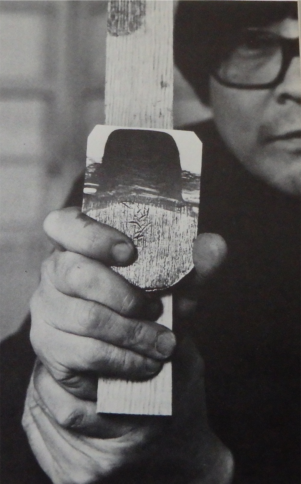

Here's a picture of a blade that someone has avoided tapping out for a long time, for instance:
Beta ura to be sure, and the ura-suki is asymmetrical. He has worked the blade too far up the stone and scarred the iron portion above the forge weld line, so it looks kinda ugly overall. Not the sort of picture I would be inclined to show myself...
He may be one of those woodworkers who doesn't care about the issue and that's fine, it's a free country and all, though as a result he does make things harder in sharpening than they need to be.
No surprise then, given that ura view, to see a picture on the same page showing him squatting down and using a stick as a lever to apply heavy pressure to work the back of the blade on the stone. Beta ura goes with such techniques, since you are gradually increasing the amount of hagane to work by avoiding the tapping out process.
