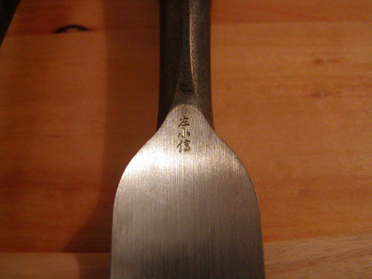

The backs are scraped on the Konobu (Konobou?) chisels it would appear....that is pretty nice and certainly more time consuming than using a grinding wheel.
Re: Suggested Acquisition
Sun Jun 21, 2015 3:20 pm
With the gouges the ura is rounded along the width of the chisel and does not have a hollow. The scratches on the hagane are along the length of the chisel opposed to perpendicular to the side as is the case when the hollow is made with a grinding wheel. Looking at the scratch pattern of the gouges it does suggest that is made with a hollowed sen (metal scraping tool) not entirely sure though.
The chisels for sale are very likely hollowed with a sen since I see no other reason for the scratches to be aligned in the length direction. Performance wise it really doesn't make a difference but it is a statement of quality by the blacksmith.
