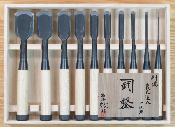

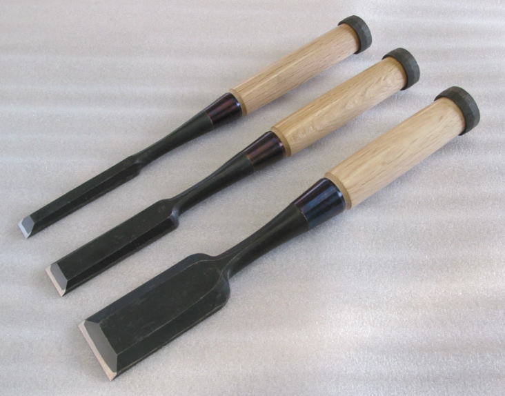

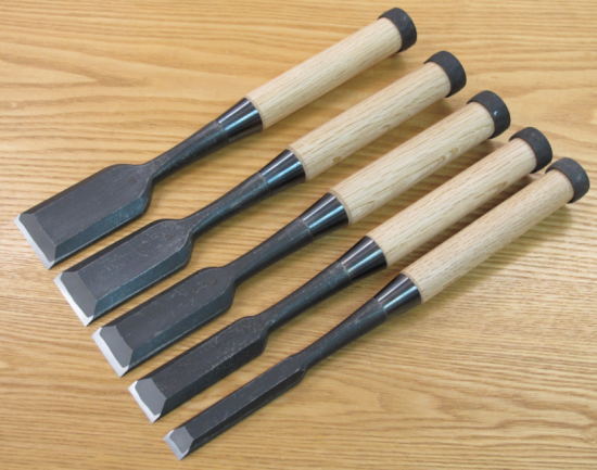

中叩鑿 Chū Tataki Nomi, 'mid-size striking chisel'.
These are slightly slimmer and lighter than the tataki nomi, but still heavier than oi-ire nomi. Also called han-tataki-nomi, 半叩鑿, han meaning 'half'. Total length is 26.5cm, with a head length of 7.5cm (2.5-sun), neck of 4.5cm (1.5-sun), and handle of 13.5cm (4.5-sun). Probably the ideal carpenter chisel if you don't work really large timbers, or prefer something slightly heavier and longer than the standard bench chisel.

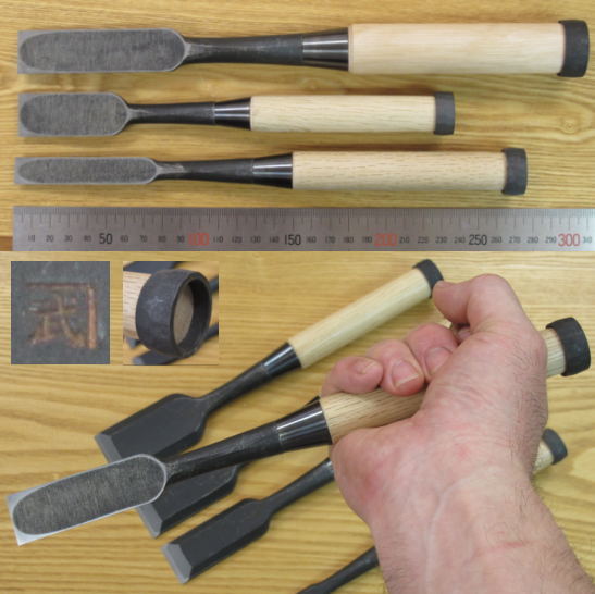

Here's a 5-set by the blacksmith Takahashi:
Takahashi's chisels take the brand mark of the character '武' in a reversed '厂' enclosure, which is read ’Kane-take’, as seen in the picture below which also gives a good idea as to the size of these tools:
(Photos from Mandara-ya)

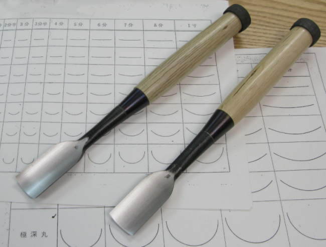

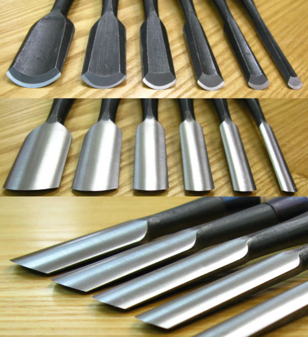

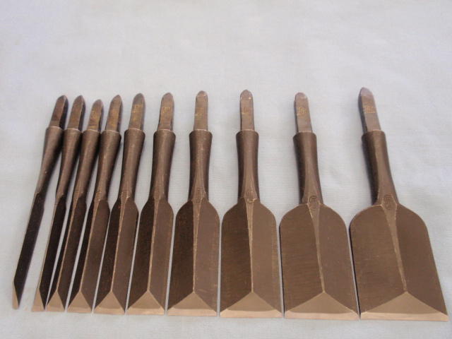

丸鑿 Maru nomi, gouges. Can be for cutting on the outside, where they would be termed soto-maru-nomi, 外丸鑿, or used on the inside, where they are termed uchi-maru-nomi, 内丸鑿. Note that the word uchi, 内, in this context, is a different character with a different meaning that the one seen in the term kaku-uchi-nomi.
Gouges are sized by the radius and depth you wish to cut, sized in ~bu increments, however if the radius/depth you have to work is unusual, then the tool can be custom made to suit.
A soto maru nomi, Kanetake brand (the smith is named Takahashi):
Note that with gouges, you have the same options as seen with standard striking chisels - you can have versions made with longer necks and handles, version which are thin or thick, etc.. Any version of a striking chisel can be made as a gouge.
A set of uchi maru nomi:
(All photos from Mandara-ya)
The sheets in the background indicate how gouge sizes and shapes are specified.

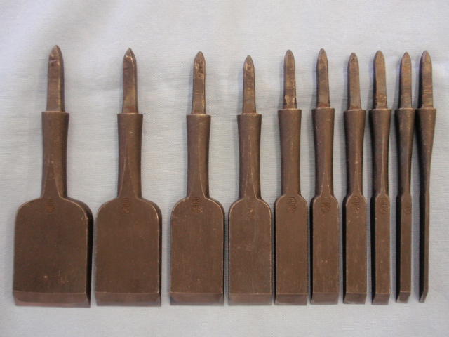

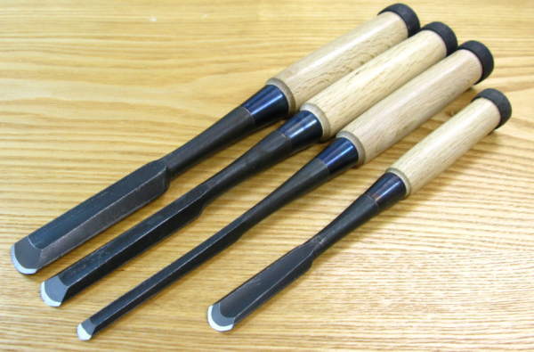

穴屋鑿 Ana-ya Nomi: extra long timber chisels for working deep mortises. Typical overall length is 1-shaku, 6-sun (49 cm), with the head comprising a length of 4-sun (12.1cm) the shank 6-sun (18.2cm), and the handle 6-sun.

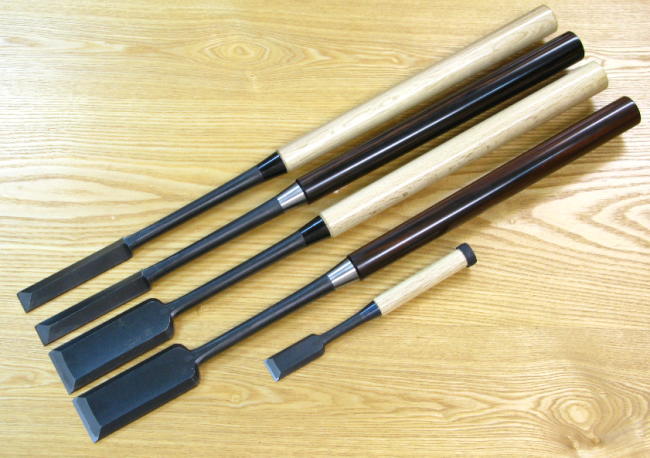

Some examples made by Tasai:

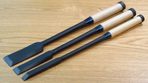

Tsuki Nomi 突鑿: push chisels. Also known as hon-tsuki nomi 本突鑿 and sashi nomi 差し鑿.
Dimensions on these can vary quite a bit, but typically we might find that the chisel head length is 4-sun (12.1cm), the shank length is 5-sun (15.1cm), and the handle length is 1-shaku, 3-sun (39.4cm).
Often these are sold as a boxed set of two, one 54mm and the other 24mm, say, though they are available in many sizes. Used for large joinery clean up and finish chisel work.

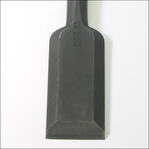

Here are some examples by Kunikei, with white oak and ebony handle options, and a standard oi-ire chisel for comparison:

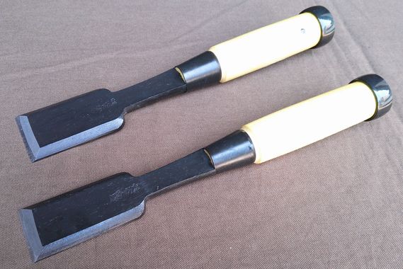

薄鑿 Usu-nomi, or thin chisel. Also referred to as kinari nomi, 木成鑿, kinari perhaps best translated as 'finishing'.
Both shank and head of these chisels are thinner, and the bevel angle lower, so as to facilitate easy slicing. Handles are typically left bare of finish to enhance grip. While they are meant to be pushed instead of struck, they will tolerate a light amount of wooden mallet use. Generally though, these chisels are used for cleaning up and finishing off of surfaces, not heavier stock removal.

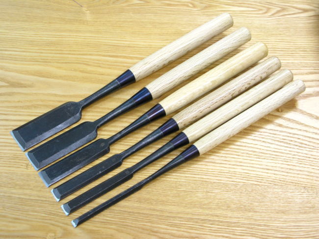

Examples with white oak handles, by Takahashi (Kanetake brand):

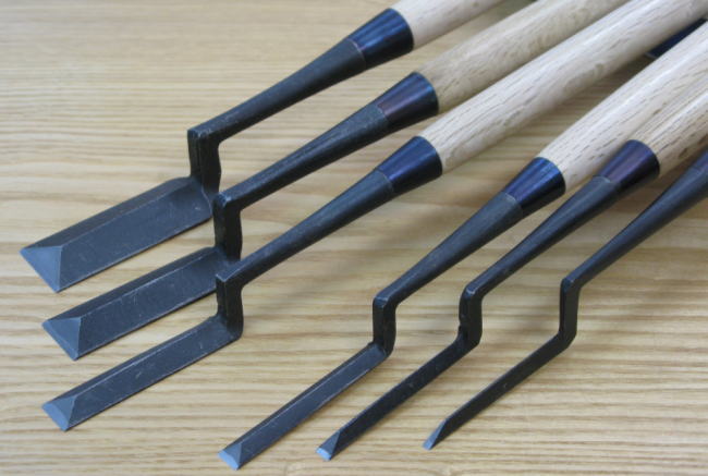

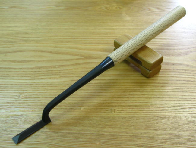

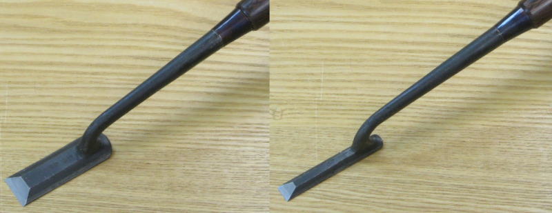

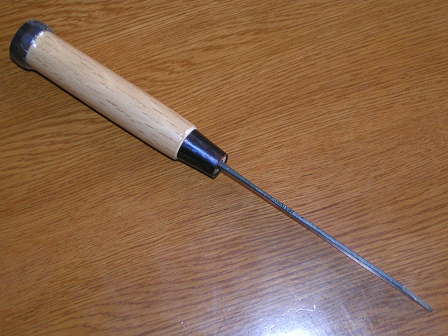

鏝鑿 Kote-nomi: Trowel chisel. Used primarily for cleaning up the bottom surfaces of dadoes.

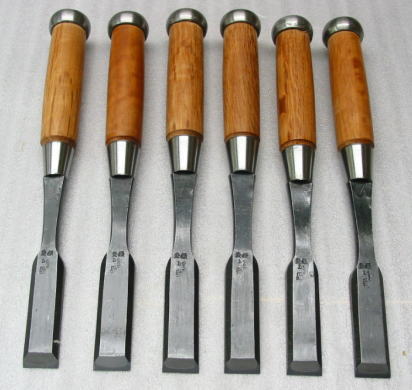

Examples by Takahashi:
Another by Kiyohisa:
As you can see, there are different approaches/styles in regards to forming the cranked neck and the attachment of the shank to the head of the tool.

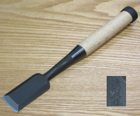

Here's an example by Funahiro:

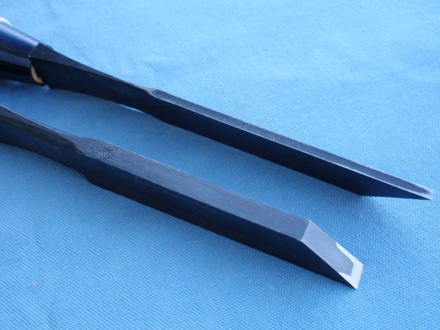

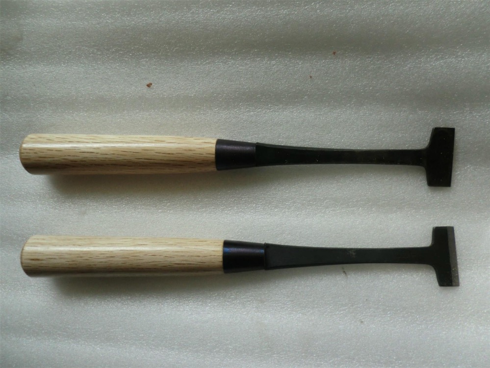

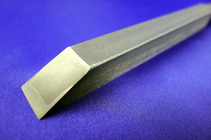

口切鑿 Kuchi-kiri Nomi, or mouth cutting plane. A type of thin paring chisel with flattened shank intended for cleaning up the plane mouth, koppa-gaeshi surface and edge of tsutsumi.
kuchi kiri.jpg (174.19 KiB) Viewed 19363 times
By Kanetake.
These chisels are even thinner than hiramachi chisels so they can slide into a tight plane mouth opening.
