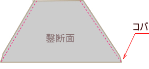

Excellent question. I would differ from your earlier teacher's assessment that the shinogi form chisels are "completely unsuitable" and prefer to say they are not perfectly suited for the task out of the box, so to speak.
Dovetails may be chopped and pared with either shinogi-form or umeki-form chisels. When you receive a shinogi-form chisel from a blacksmith, the cross section looks like this:
chisel cross section for dovetail.jpg (23.64 KiB) Viewed 21443 times
Note the part marked with the arrow, termed koba '小端'. You can see that the intersection between the side of the chisel and the ura is not a crisp corner. A chisel side is made this way because (and just like the tip of the chisel), if the side arris were sharp after forming to shape, then the process of tempering would disproportionately affect the sharp arris, making it too hot. This would later result in a chisel which has a crumbly side edge. That arris needs to therefore be left blunt for the heat treatment phase. When chisels are formed, the tip is left blunt for the same reason, then shaped to a sharp point after the heat treatment process is complete.

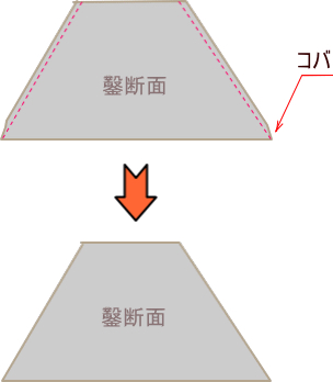

After heat treatment, the smith does not similarly grind the side of the chisel to a sharp point for the reason that, in most usages, it makes for a tool which will readily slice the side of your finger open - the same side of your finger you may use to guide the tool when paring. For most usages, you wouldn't want the side arris to be razor sharp. However, if you want to cut dovetails or similarly acute inner corners, then grinding the edge of the tool into a sharp arris would be the thing to do:
chisel cross-section change.jpg (38.37 KiB) Viewed 21443 times
(images from Mandara-ya's site).
Generally speaking, if you had a set of 10 chisels, you would only need to modify a couple of them with sharp arrises specifically for the task of cutting dovetails.
