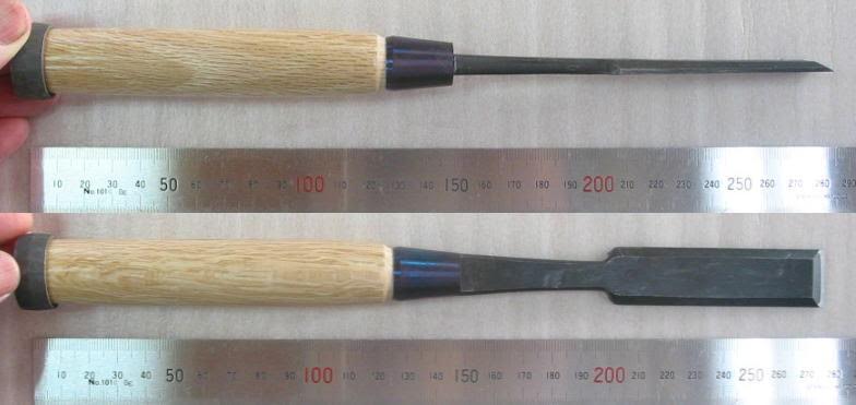

I've ordered a 16-set, 3mm to 60mm, in a special kiri box. The chisels are of the hiramachi body type with flattened shanks, with all chisel heads in the kaku-uchi shape. All the ura will be hand scraped by sen. These chisels are longer than oi-ire nomi, more like tataki nomi in length. All handles are gumi, 5-sun long, and both ferrules and handle hoops are of the hammered form. Finish is in the standard black, including ura.
I patterned these off of a special type of hira-machi chisel that Mandara-ya sells (fine chisels but not made by Kiyohisa though). Here are some pics showing the general dimensions:

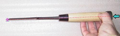

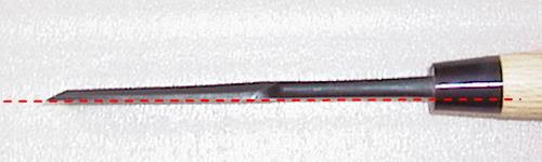

The body alignment is a straight line from head through shank:
Well this chisel set represents pretty much my ideal in terms of the perfect all-around versatile chisel design, and I intend this set to be my go-to set for a lot of work - until I'm dead and they can be pried from my cold hands.
