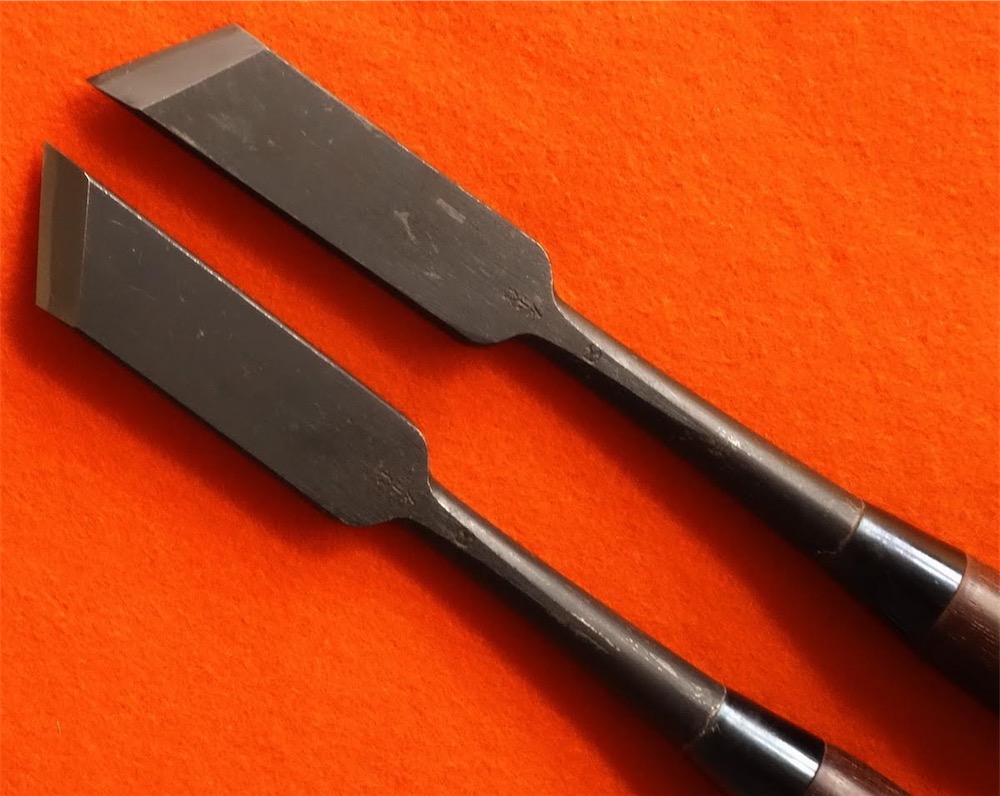

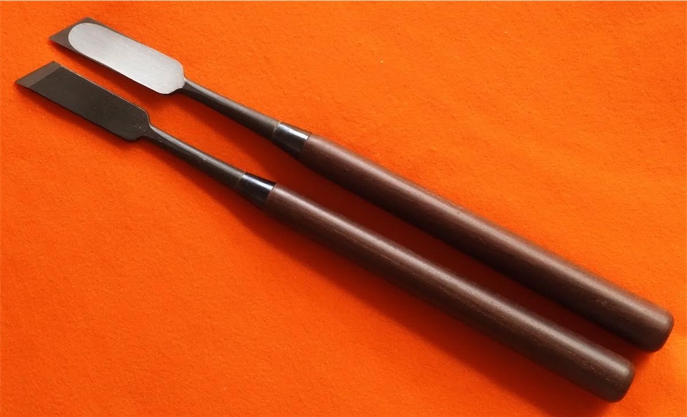

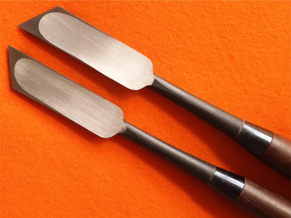

Well, I was being a bit shy about that, but since you ask, why, yes, they are in fact ready after a year's wait:
Since I will never likely get the chance to actually work with Zitan (Shitan in Japanese), I thought it would be cool to at least experience how the wood feels to the touch.
A couple more photos - Satō kaji-ya san does nice work indeed:
I'm waiting for a kiri box to be made, and the calligraphy will be done, as I specified (I might say, I was given a choice between three styles and, perversely, chose a 4th), in seal-script style. I am not big into paulownia boxes as such, but they are a handy way to keep things apart within my Kennedy tool box, which is where I keep my chisels and planes. Like my set of Kiyohisa chisels, I will take the lid off the box and keep it at home and use the box like an insert tray inside the cabinet.
