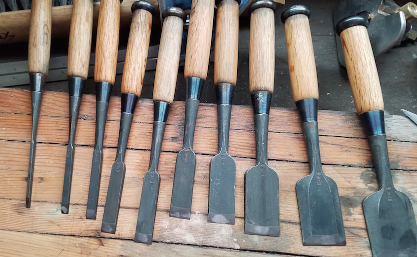

Hi all, first post here. Hoping someone out there has an idea for working these chisel backs. I found this set on ebay about a week ago. I have been casually looking for a 10 piece set with the kaku-uchi shape, so when these revealed themselves for a couple hundred bucks, I figured I did not have much to lose and clicked buy.
They arrived this morning (fast shipping!) and here is how they look with the lacquer off and a quick pass on the lapping plate to see what kind of shape the bevels were in ( I think "convex" would be the the appropriate descriptor).

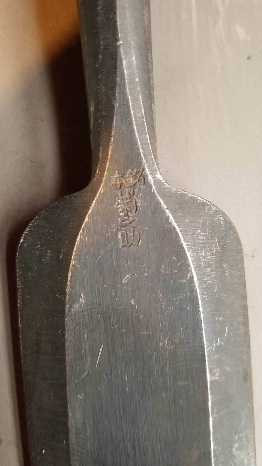

And here is a shot of the stamp. Some of the handles still had their sticker, which read "Narumiya Sato"

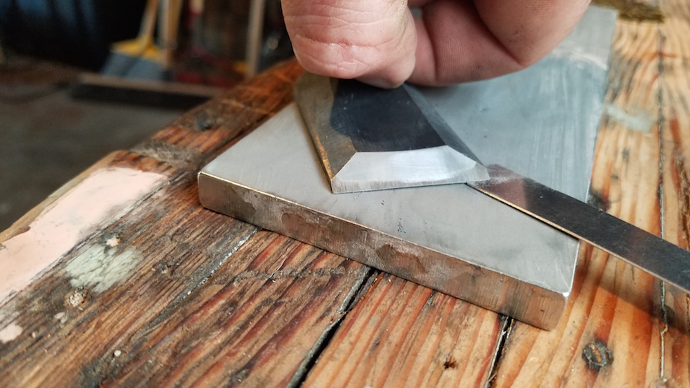

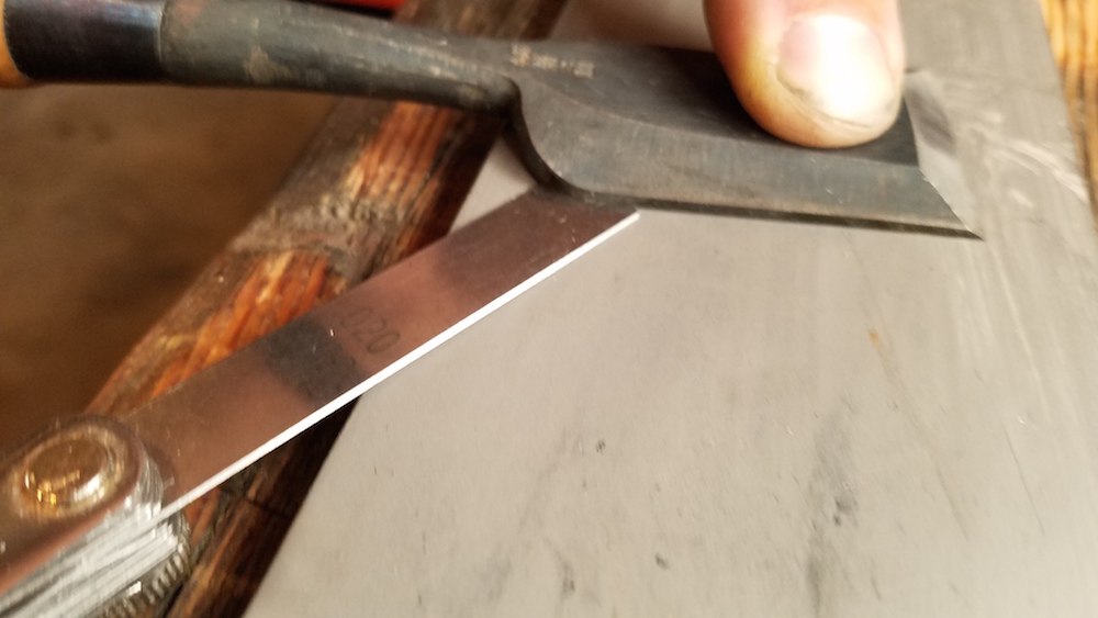

As I draw the first chisel across the stone I feel a disturbing rocking and feel a corner dig in (keep in mind the ura looks brand new). I get confused and see if there is a chunk of dirt or something on the stone that is causing the chisel to rock. No dice, stone looks clean, and back of the chisel looks like it just came from the smith's shop. So I reference the back of the chisel on my DMT plate (flattest thing I own) and the chisel is rocking back and forth like crazy. There is a clear "high axis" from the back left to the front right corner. Below are two pictures with me pressing on the respective "low spots" with a .020 feeler gauge underneath the resulting gap.
I think maybe this a just a bad apple, start checking the others it the set -- and they almost all have the same issue with the exception of a few of the smaller sizes.
So where to go from here? Should I rub these against a lapping plate for the rest of my life? I am sure I could eventually get them flat, it would take some time and create a very asymmetrical wear pattern on the ura.
Should I just focus on creating a flat behind the cutting edge? I would be able to get the chisels sharp, but couldn't use the chisel back as a reference when paring.
Can I beat these with a hammer a little bit to try in move the back into a single flat plane? Like an aggressive version of tapping out?
Any suggestions appreciated.

You ask a great question for your first post. Unfortunately, I do not have a good answer for you. I have a set of Kunikei chu-tataki chisels, and many of them have convex backs. I decided to only flatten the front area of the chisels to avoid lapping away too much metal, and to not mis-shape the ura too badly. Of course this means I cannot register the full bottom of the chisel to guide a cut. I did consider beating the chisel (with a block of wood or soft metal ), but I did not want to try this on my new chisels.

No good answers here, either. I'd probably just flatten the fronts. But if you do decide to give them a whompin', you might warm them up a bit first- not hot enough to affect the temper, but just enough so they're a little relaxed, not cold and brittle. I'd try leaving one blade down in a cup of very hot (or maybe even boiling) water for a minute or two, then whomp with a wood block, or squeeze in a vise, etc. Definitely don't hit the ura side directly with a hammer. Actually I wouldn't hit either side directly with a hammer, unless tapping out.

This is a tough one, .020" is a ton IMO. I'd like start by working with a large wooden drift pin then finish the job via tapping out. Tapping out aggressively on chisel with ears, as most have) stands to weaken it from what I've been told. I tend to tap out very minimally on chisels with mimi and more freely on chisels without or plane blades.
A good ura can be achieved in all likelyhood but how you manage the work before going to the stones will likely determine.
Konobu, as an example, never seem to contact at the front edge without some work. The first few I treated as normal chisels just working the backs with rough stones...,it took hours and the backs were ok but not as sexy as when I received them. The remainder I tapped out to wonderful effect and took maybe 5-10 minutes to setup the backs.

Think the chisel reads 菊之助 - kikunosuke. Either the brand or someone's name.
