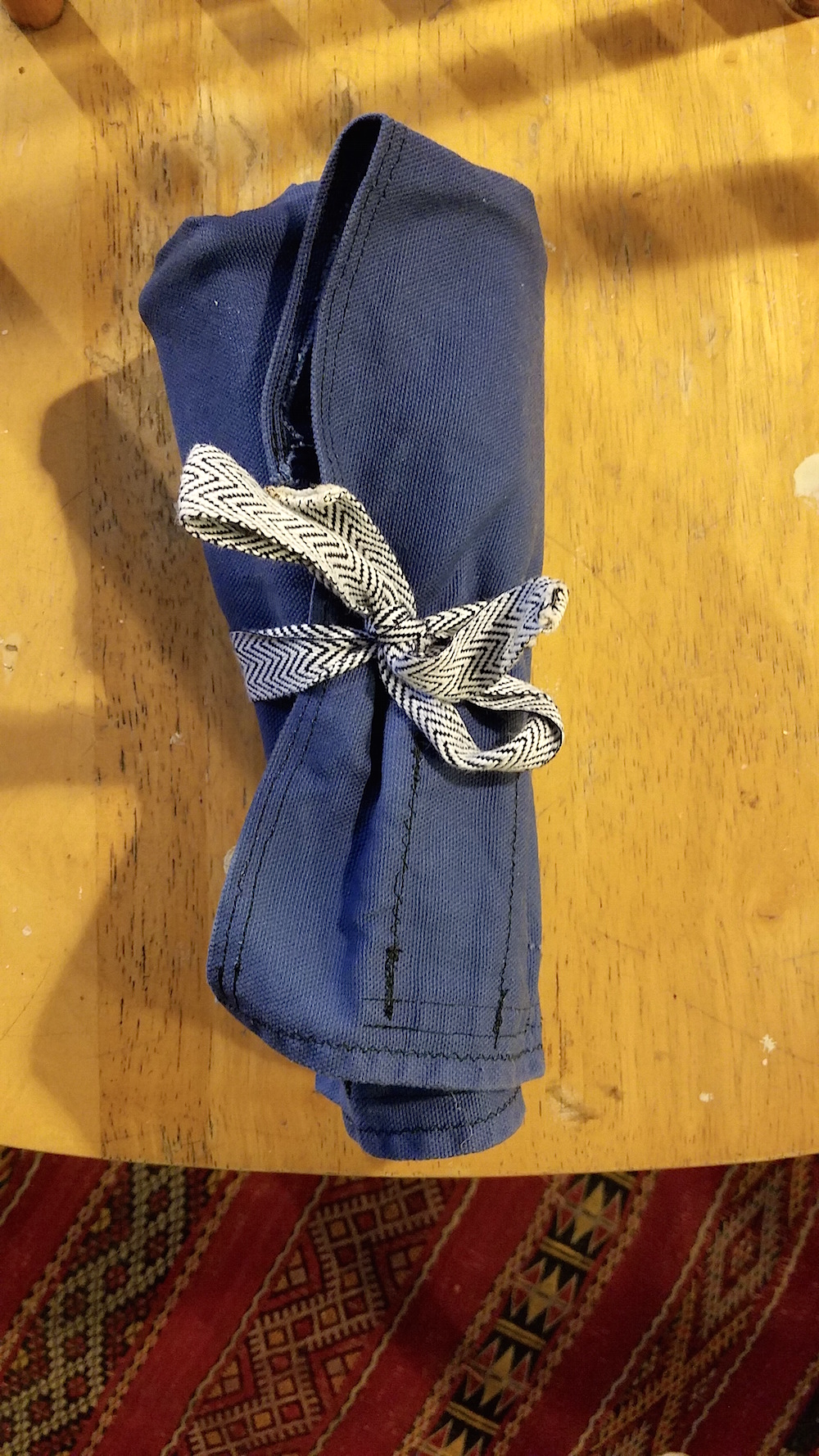

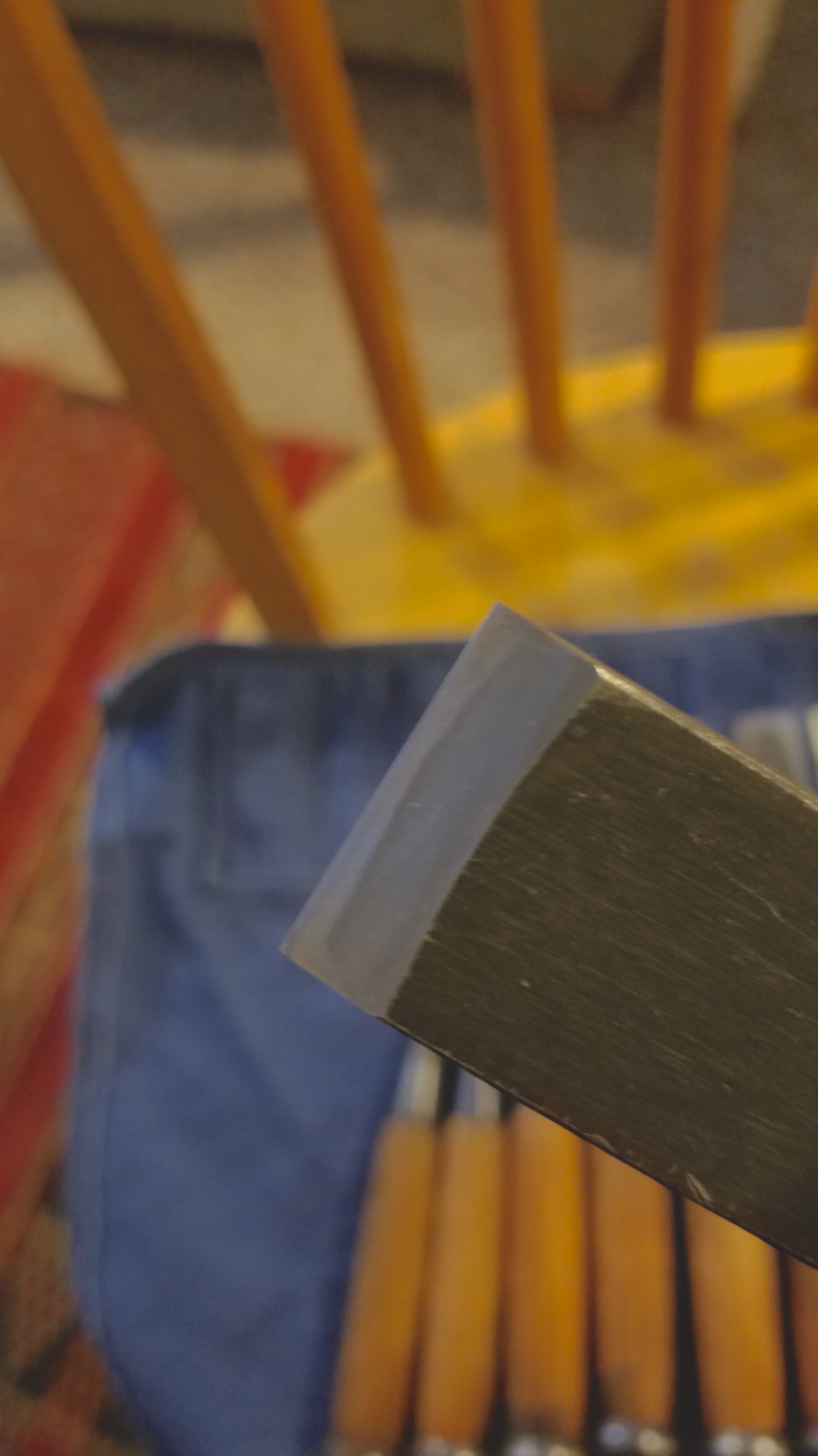

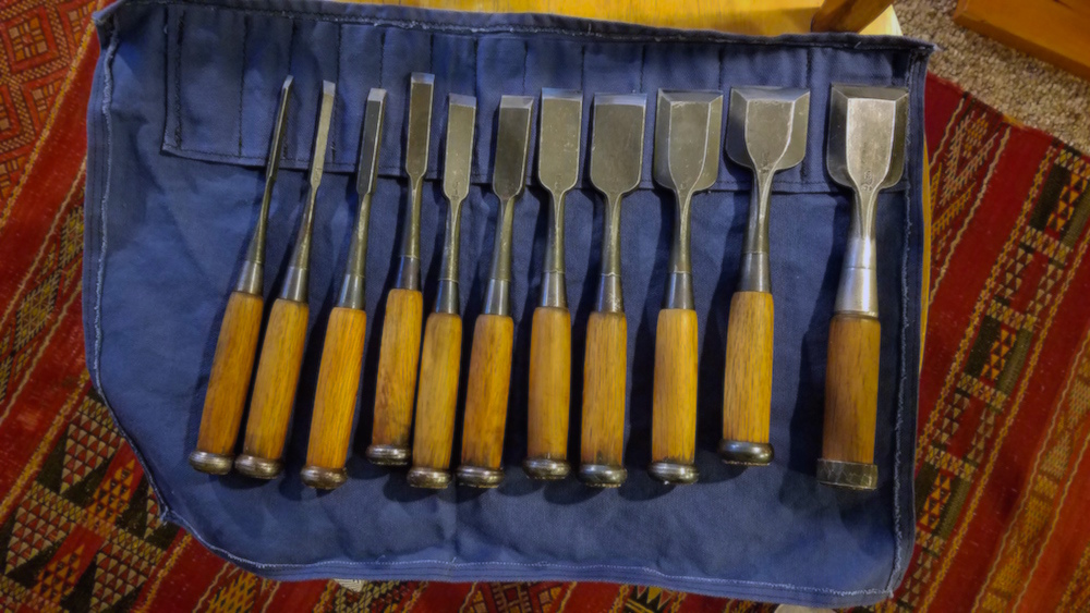

I just finished getting all the chisels set up, got the hoops on and made a new bag for them. Doing all 10 took some time, but I am excited to be able to have them all ready for work. Thanks for all the replies. They were very helpful. I did end up trying to move the steel with a wooden drift per Brian's articles. I had some success, but was unable to take all the warp out -- I decided to lap them flat regardless as the chisels will be most useful to me that way. It would be nice to have the backs in perfect condition, and maybe someday I will have the skills to set them up that way. The reality is that in my work as a site carpenter, in addition to wood, these chisels will probably encounter MDF, plywood, gluelines, dirt and, god forbid, stray nails. As a result they tend to get touched up often, and maintaining a perfect shape was never in the cards for this set anyway. So here they are + an extra 42mm Iyoroi that I already owned.
