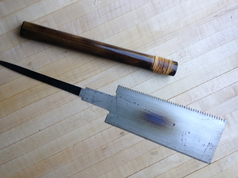

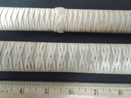

Wow! Nice handles, how did you learn to wrap like that? I assume there is a repeating pattern to follow? I really like it.

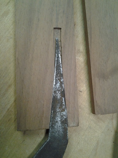

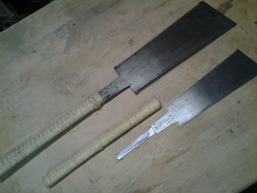

I just purchased a new saw from ebay that has not arrived yet. When it arrives I would be happy to chronicle its journey of being put into use. I may reshape the teeth slightly for hardwood or the like. As for my handles - thank you very much. I make my handles in 2 pieces with the saw tang cut out on only one side. I then glue it together and wrap with rattan. I have some saws that have the original one piece handle. I have no idea how the saw maker is able to drive the long tang so far into the skinny handle without splitting it to shreds. Some sort of ancient magic with mumbled incantations I am sure.

- 2 recent saw projects
- 2 saws a.jpg (63.11 KiB) Viewed 23282 times
- Recent saw handle detail
- saw handle detail 1.jpg (74.72 KiB) Viewed 23282 times

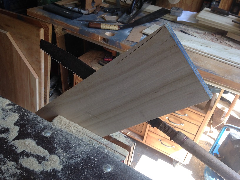

- Starting the handle of a ripsaw handle.
- big rip saw handle 1.jpg (65.76 KiB) Viewed 23282 times
- Recently completed ripsaw handle in background.
- large ripsaw handle 2.jpg (199.34 KiB) Viewed 23282 times

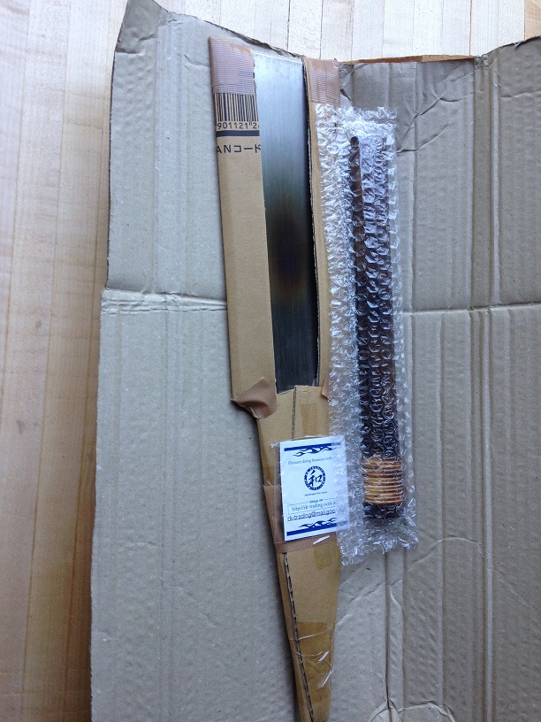

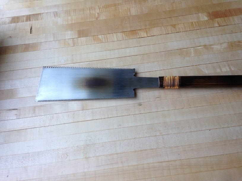

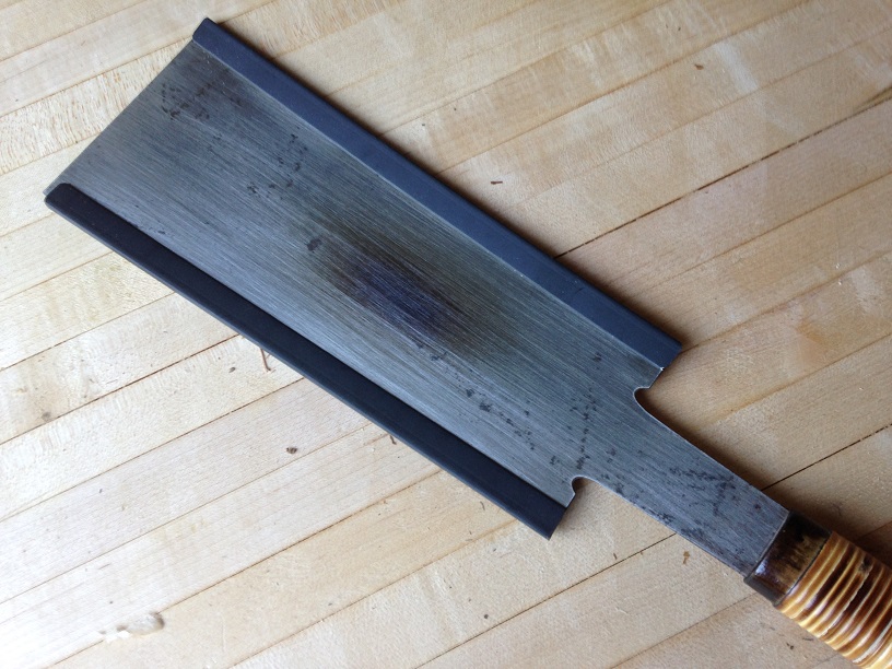

I recently received a new "ebay" saw. While the saw is new, I did find some minor shortcomings. The saw is sharp but pulled to the left - indicating improper set or burr. I will have to retouch the teeth with a file and maybe hone the sides. The handle is kinda "clunky" and is thicker than I would like and it is not tapered in the center. I will trim the handle in the center so it has a better feel. The saw will hopefully be a good user, but I will have to get used to it.
The wrapping on the saw handles I showed earlier is not that difficult (if I did it-you can). I used chair seat rattan soaked in warm water for a while and then put some varnish after smoothing out any blemishes on the rattan.
- Unwrapping my prize.
- saw 1.jpg (202.23 KiB) Viewed 23271 times
- The saw is pretty simple - the blade and a handle.
- saw 2.jpg (173.82 KiB) Viewed 23271 times
- The saw handle had the tang hole ready for the saw to be inserted.
- saw 3.jpg (197.7 KiB) Viewed 23271 times

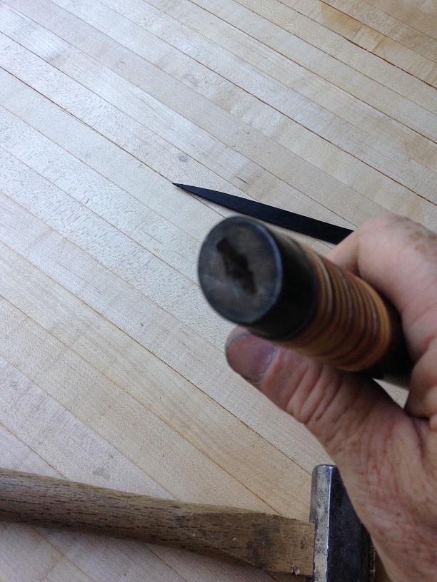

- The saw tang inserted as far as I could by hand, it will be seated the rest of the way by hitting the end of the handle with a hammer.
- saw 4.jpg (218.28 KiB) Viewed 23271 times
- The saw fully seated and ready to use.
- saw 5.jpg (141.01 KiB) Viewed 23271 times

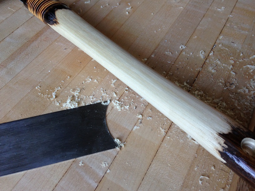

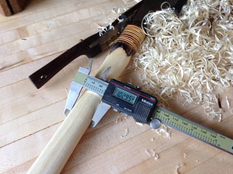

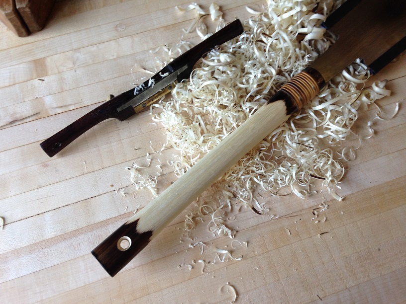

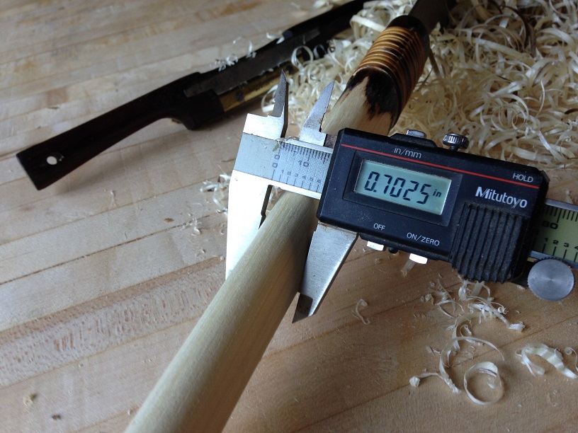

After writing the above entry, I decided to go out and reshape the saw's very plain handle. By contouring the handle it gives my hand more orientation to the saw. I used a spoke shave for all of the shaping and finished with a scraper.
This saw has no maker's mark.
- Final shape and the amount of wood removed. Don't be afraid to remove until comfortable.
- IMG_1213.JPG (243.38 KiB) Viewed 23271 times
- Handle finished with just a scraper.
- IMG_1214.JPG (205.96 KiB) Viewed 23271 times
- height before was 1.18in
- IMG_1217.JPG (212.59 KiB) Viewed 23271 times
- width before was .88in
- IMG_1220.JPG (180.37 KiB) Viewed 23271 times
- I always protect the edges when not in use! Broken or bent teeth are very bad.
- IMG_1226.JPG (192.84 KiB) Viewed 23271 times

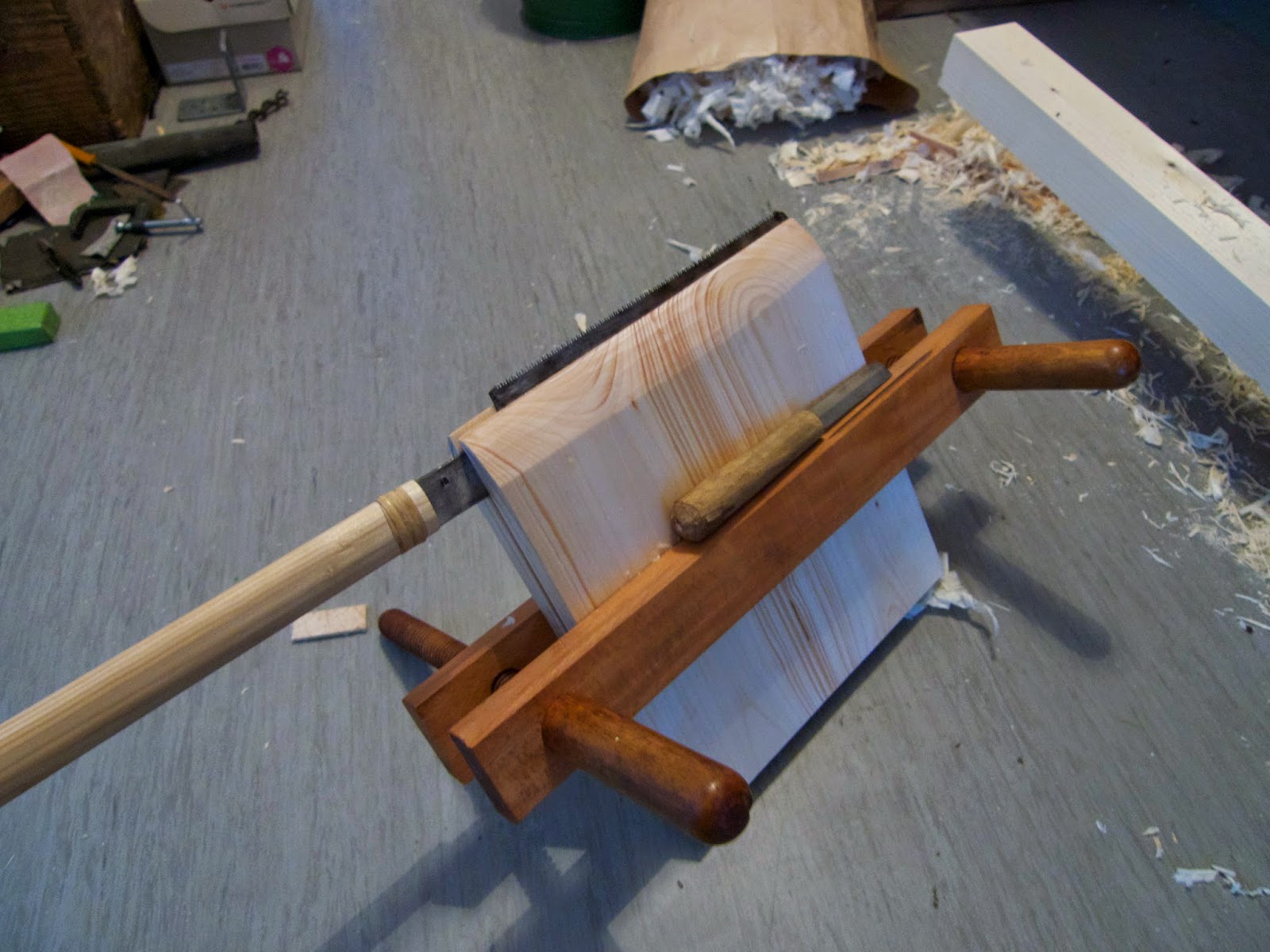

I can give it a try... at least I have the vice and some experienceYxoc wrote:Love those saw handles Paul!
I can see the need for a Japanese saw sharpening post. Who could do it I wonder...?

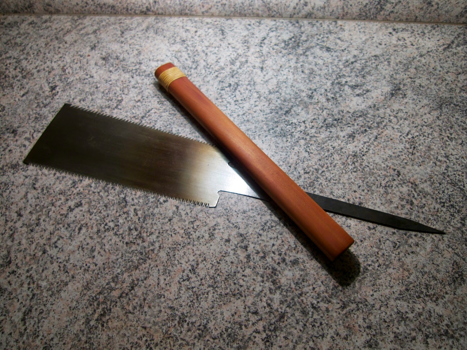

This is one I made for Opa's 81 birthday. He's a violin maker in north Germany.
I used some really perfumed cedar I took from his workshop. I got the saw from the same seller as you, their handles are really cheap. The saw is not bad, but my favourites are the "expensive" Nakaya he sells.

I love the design of the saw vice? Did you make it? I have one that has a wedge along the bottom, but yours seems to take care of the clamping and the positioning which is pretty cool. Making your handle makes you want to start sawing stuff, eh? I will put a picture of the saw vice I have. I make my handles in 2 pieces, but some of the handles I have gotten from Japan are one piece with the saw tang pounded all the way in - I have no idea how they do that without splitting it!!

Cut the tang opening into the handle with a keyhole type of saw as far as you can. Then heat up the pointy end of the tang of the saw with a propane torch until it is hot - not red hot. Then slip the tang into the handle and hammer on the end of the handle to seat the saw blade.I have no idea how they do that without splitting it!!

Actually, I didn't have the screws that sunday to finish it, so I tried the wooden vice and, surprise, I didn't need a support anymore for it. I have the space to put the wedge along the bottom too but I guess will never use it, at least not with this vice. I didn't have a large piece of wood to use as support either, so it was win win situation.
The only problem it has, is that the moxon vice is not symmetric, so I need to change the angle of the file in each side. I guess I could cut the threads but I took that vice from Opa's workshop and it's really old, I don't feel I have the right to modify it. Anyway I plan to make a new one, spruce is slightly too soft for the job.
Re: Still Empty Here??
Paul Atzenweiler wrote:I love the design of the saw vice? Did you make it? I have one that has a wedge along the bottom, but yours seems to take care of the clamping and the positioning which is pretty cool.
