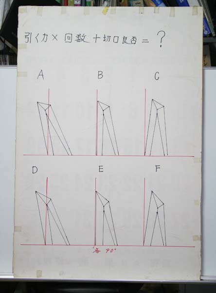

Going back to the illustration Sebastian showed in his last post,
The top of the picture asks:
引く力 x 回数 + 切り口良否
It's asking to compare, good and bad (良否), the tooth patterns shown with pulling force (引く力) and number of saw strokes required (回数).
Then there is some text below the illustration comparing tooth pattern 'A' with 'C'.
About 'A', the text reads:
Aの場合
■引っ張る力 鋸を引くときにCの3倍ほど力がいります。
■切り口 繊維を引きちぎるので、切り口が粗い
■鋸を引く回数 34回(Cよりも7回多い)
The first bullet point looks at how much strength is required to pull the saw, or hipparu-chikara (引っ張る力), and says that 'A' tooth pattern makes for 3 times the effort as compared to 'C'
The second bullet point looks at kiri-guchi (切り口), which means the end grain cut surface I do believe, and says that it will be arai (粗い), rough.
The last bullet point notes the number of strokes to cut the piece, at 34 strokes, which is 7 strokes more than with tooth pattern 'C'
About 'C', the text reads:
Cの場合
■引っ張る力 鋸を挽くときの力はAの1/3程度
■切り口  光を放すようなカンナをかけたような光沢がある
■鋸を引く回数 27回(Aより7回少ない)
Well, this list is the mirror image of the list for 'A'.
The first bullet point looks at pulling load, and states that 'C' requires 1/3 the force.
The second looks at the end grain cut surface, and notes that is it bright, polished (光沢がある) and the fibers cleanly cut, like a plane made the surface work.
The last bullet point looks at number of cuts, noting that it took seven fewer strokes with 'C' than 'A'.

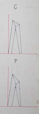

There's also a drawing comparing 'C' with 'F', the only difference between the two being the angle of the uwame (tooth tip):
The text:
「CとFの下刃は同じ角度です。上目の角度を変えました。さてどちらが切れるでしょうか」
もうお分かりになりましたよね。悩んだ方は先ほどの防波堤をイメージしてください。
下刃の角度が同じ場合
刀の先端(上目)を尖らせないほうが、スーッと素直に切れます。答えはCです。Fの場合、切り口が波打ちます。
Below the illustration, the writer asks how the cutting might be different between the two uwame forms. He then suggests to think of the image of a breakwater (防波堤をイメージしてください).
He then states that if the cutting tip angle does not become so sharp ((上目)を尖らせないほうが、), then the cutting action is smooth and predictable, as in tooth 'C'. If tooth pattern 'F' is employed, the end grain cut surface will look rippled (nami-uchimasu 波打ちます)

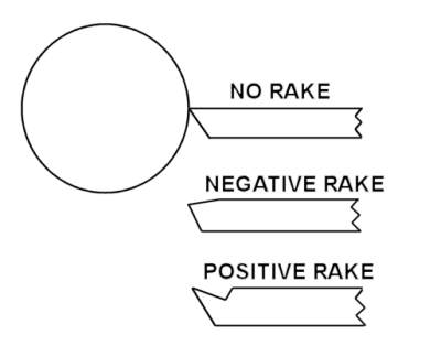

I think we have a reversal of terms involving 'positive' and 'negative' rake. Going back to this diagram:
I would term 'A' positive rake, and 'C' negative rake.
In machining, it is the same use of terms for the different types of rakes:
Another pic showing for saw teeth:
And one for a (powered) crosscut saw blade:
So, given that 'C' is the ideal according Nakakatsu, it seems we are talking about a 'negative' rake, correct?

Chris Hall wrote: So, given that 'C' is the ideal according Nakakatsu, it seems we are talking about a 'negative' rake, correct?
That's correct, I always get confused. Maybe because you need to "push" the file towards the facet that I associate it with a positive. I will edit my previous post to be sure it's right. Thanks for pointing it out Chris.
