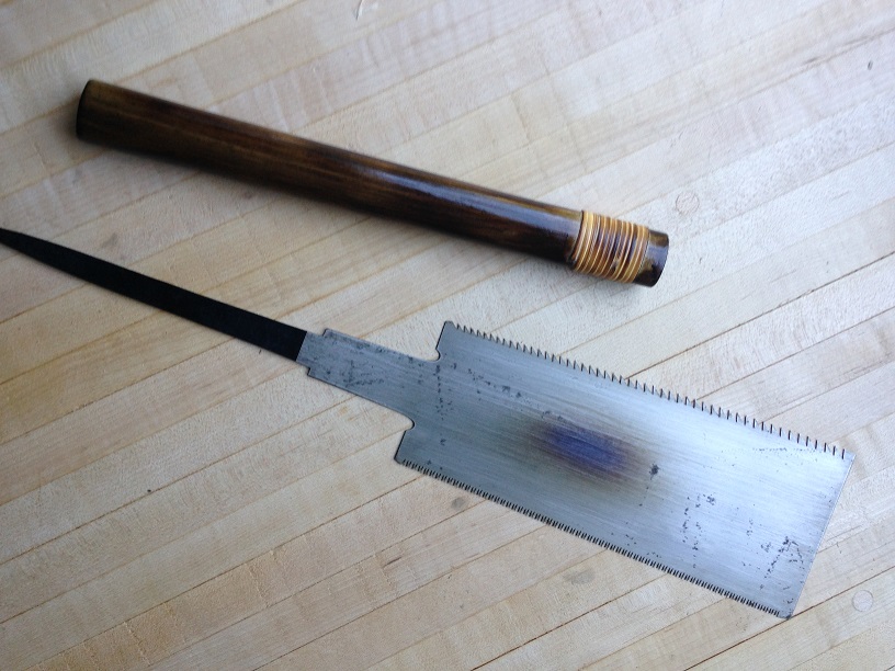

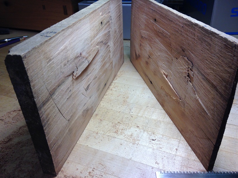

I recently sharpened a saw I had purchased on ebay and I was going to resaw a piece of oak in response to a post by indranil. I knew the saw was sharp and I used it to make shallow rip cuts for some joints and it worked very well. It became obvious very quickly that even though it was sharp it was terrible at resawing. The saw drifted to the left horrible. I continued and fought the whole process thinking I would have a good example of what a cut from a badly "set" saw would look like. This HORRIBLE cut is from a sharp saw that is not set well. I will have to figure out exactly where the problem with this saw lies. I have 2 rip saws I use and they stay on track very well. I will be very interested in your post about "setting" as my experience with setting has been limited to correcting individual problem teeth.
- This the saw used for this cut.
- saw 2.jpg (173.82 KiB) Viewed 33576 times
- Resaw fail.jpg (208.45 KiB) Viewed 33576 times

Did you try running your fingers along the teeth? I hold the teeth between my finger tips and travel the edge from one side to the other. Sometimes fingers are better at seeing than eyes. If there is a bump you should feel it immediately. Or a tooth that's too much set.
Now, I had the experience of cutting ash with one saw, and getting a perfect match when resawing, but trying rosewood and getting the bump with the same saw. So it depends on the wood too. It also gets better with time, the more I saw, the better it gets.

can you take a picture of the teeth, both from the side and from the top or back of the saw? Trying to focus on how the set looks like.Paul Atzenweiler wrote:I recently sharpened a saw I had purchased on ebay and I was going to resaw a piece of oak in response to a post by indranil. I knew the saw was sharp and I used it to make shallow rip cuts for some joints and it worked very well. It became obvious very quickly that even though it was sharp it was terrible at resawing. The saw drifted to the left horrible. I continued and fought the whole process thinking I would have a good example of what a cut from a badly "set" saw would look like. This HORRIBLE cut is from a sharp saw that is not set well. I will have to figure out exactly where the problem with this saw lies. I have 2 rip saws I use and they stay on track very well. I will be very interested in your post about "setting" as my experience with setting has been limited to correcting individual problem teeth.

I have not identified any "one" tooth. It may be teeth on one side just have more set. I may be able to correct it by honing that side? I think I will concentrate some of my other saws and sharpening in general first.

Other option is that the teeth are punched and not filed. I have one saw like that from Sakura pink, which is where I guess you got yours. My saw had a small burr in one side from the press, not a really high quality tool. You need to file that out and leave the teeth symmetric.
Also, a sharper saw will cut more easily in a straight line. I would say just touch up the saw and give it another try. Worst case scenario you get some practice, both sharpening and sawing.

You should be able to "feel" with your fingers if one side has more set. You could indeed file that side, but I would try it in other wood first. Check the geometry, maybe it's too step for hard wood. I would do the honing only if you are sure one side has more set, which in my experience has not yet being the case. (And if it were, I would go for a soft hammering to one side instead of honing.) Since you hammer the set in japanese teeth, it's actually quite easy to give them a uniform set, just drop the hammer from the same height always.Paul Atzenweiler wrote:I have not identified any "one" tooth. It may be teeth on one side just have more set. I may be able to correct it by honing that side? I think I will concentrate some of my other saws and sharpening in general first.

I did think that it could be a manufacturing problem where all the shaping was done from one side. The saw appeared to be new when I received it. I have so many saws (but I'm sure I will get more) I really need to figure out the issues of sharpening and setting. I really like your sharpening tutorials and videos.

I would say that is it then. A close up picture would be great, to see which saw is it and compare them with mines. If it's a "factory" problem, then there is one solution for all of them.Paul Atzenweiler wrote:I did think that it could be a manufacturing problem where all the shaping was done from one side. The saw appeared to be new when I received it. I have so many saws (but I'm sure I will get more) I really need to figure out the issues of sharpening and setting. I really like your sharpening tutorials and videos.

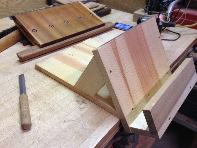

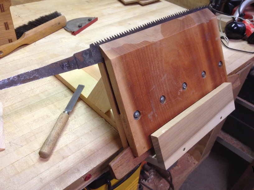

I like your saw vise set up, but believe it or not I don't have an area to sit and sharpen so I wanted to adapt it to the work bench. I don't know if I will need to make adjustments so I didn't spend a lot of time making great joints and used screws. I just used some scrap pine. When I feel I have it figured out I will make a more refined version. The whole set up is able to sit on the bench and is stable with just gravity-no clamps. After using it for just a little bit I really like it.
- saw vise 1.jpg (160.72 KiB) Viewed 33554 times
- saw vise 2.jpg (181.57 KiB) Viewed 33554 times
