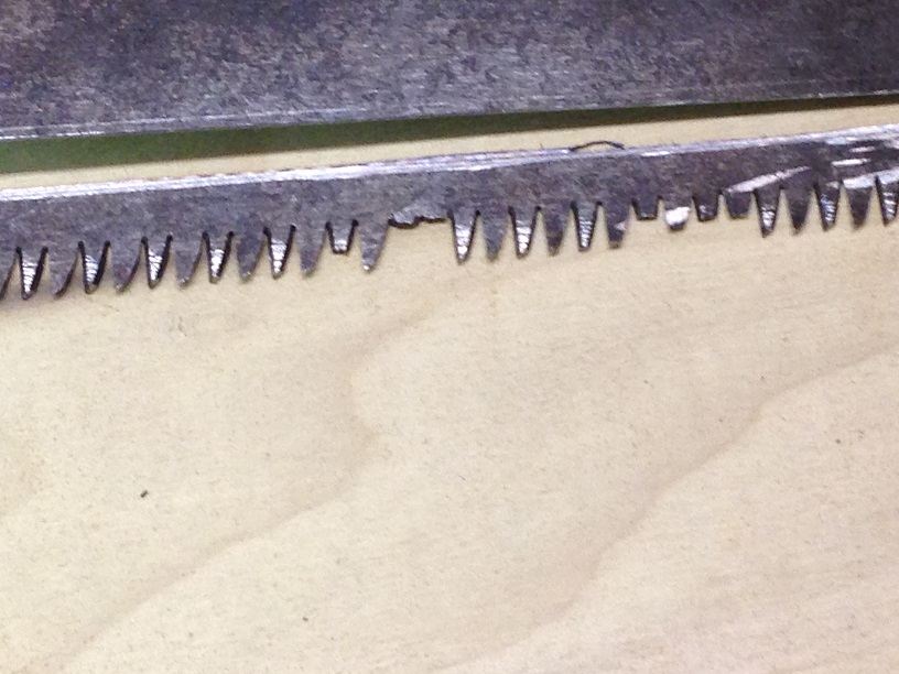

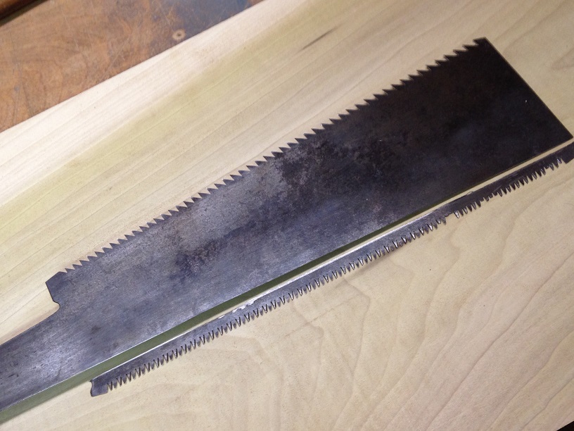

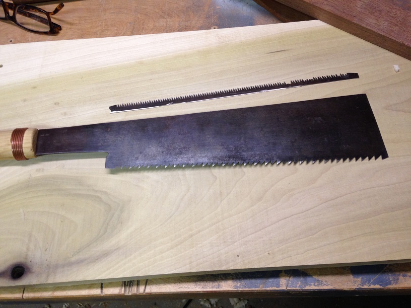

I will try that with the saw in previous post. I think that saw will become the saw I experiment on. On this saw, I am cutting off the crsosscut teeth as they have became broken and cracked by previous owner. I clamped a piece of wood to the saw and used an angle grinder to score the blade and carefully snapped off the row of teeth. I filed the cut smooth and am now ready to resharpen the rip teeth.

Check the thickness of the blade in what now is the back of the saw. That gives you the minimum set you need. (Looks like the teeth were filed from the side so you have less set now but it may have been compensated by cutting the teeth off.)
Are you making a key-hole saw with the left over teeth?

There is about 6 - 7 inches of good teeth and I will save it for keyhole saw or some specialty type saw. I will at least sharpen them for practice.
