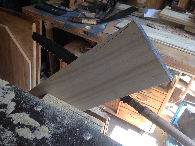

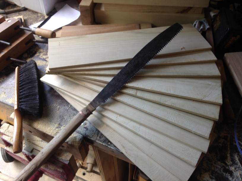

Japanese rip saws are very much like western rip saws in that the file is held at 90 degrees to the saw when sharpening. The teeth are also very close with maybe a bit more forward aggression. Sharpening a Japanese rip saw is not very complicated and well within the skill set of most woodworkers. I do use a Japanese saw file rather than a typical triangle file. You can file a saw several times before you have to "set" the teeth. I say this because most people don't even try to sharpen a saw because they feel there is a long arduous process, usually you can think of it as a "touch up". In the pictures here, I am resawing poplar which is a soft wood. The process for hard wood (even very hard and abrasive) is the same - just slower and you will have to sharpen occasionally.

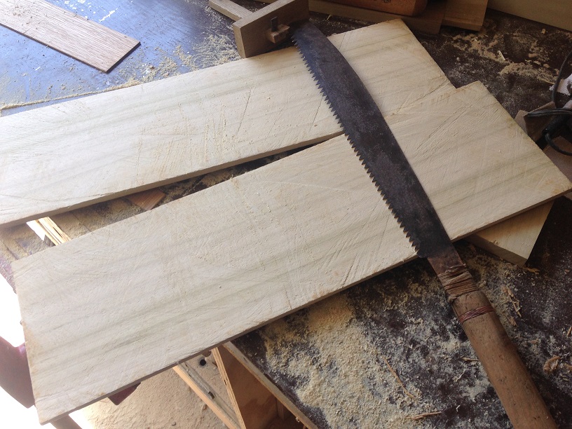

Re: Could someone recommend a nokogiri for re-sawing hardwoo
Here are more photos of this process.
- Resaw pic 1.jpg (199.34 KiB) Viewed 19994 times
- resaw pic 2.jpg (218.06 KiB) Viewed 19994 times

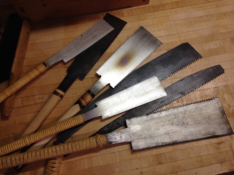

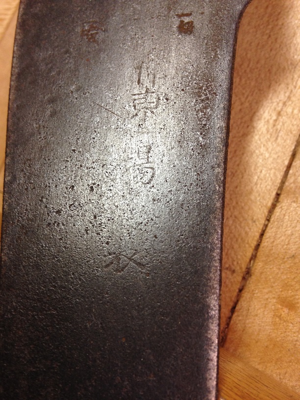

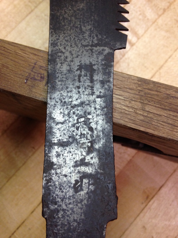

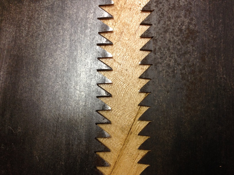

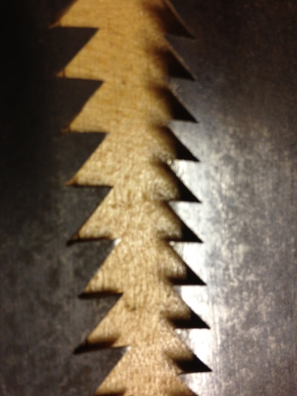

Most of the "non replaceable blade" saws I have I purchased off ebay. The rip saw in the above photos was about $25. The saw with the "pistol grip" handle came with no handle and was also about $25. I put the rip saw next to the rip teeth on a Ryobi and you can see how much more aggressive the teeth from the Ryobi are. I am going to replace the handle on the ripsaw which is why the handle is gone. I tried to photograph the markings on the saw but these are old saws and I don't read kanji. Hopefully someone like Chris can interpret them. I would suggest buying a replaceable blade saw first, because there is less effort in getting an "up and running" saw.

- 2 different rip teeth, one on right would be better for soft wood.
- tooth pattern.jpg (125.28 KiB) Viewed 19977 times

- markings on ripsaw.
- saws 4.jpg (238.32 KiB) Viewed 19977 times
- attempted photo of markings on ripsaw.
- saws 5.jpg (182.84 KiB) Viewed 19977 times
- My non replaceable blade saws from ebay
- saws 1.jpg (193 KiB) Viewed 19977 times
Those characters are bit hard to make out, though I can see parts of kanji there. Not enough to give you the reading though, sorry. In the first picture of the mei I can make out the character 'ba' (場), meaning 'place'.
