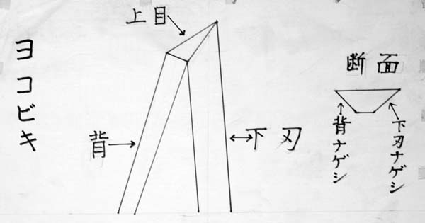

I can help with the translation a bit. Here are the terms for the various parts of the tooth in a cross-cutting saw, or yokobiki (横引き):
The three parts are:
Shitaba (下刃): cutting edge
Uwame (上目): top facet/tip of the tooth. Another term for this part is 'katana no sentan' (刀の先端)
Se (背): 'spine'
Se (背): 'spine'

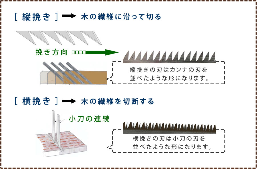

This sketch was interesting, comparing a ripping tooth to a cross-cutting tooth:
It described the ripping tooth (top half of the picture) as being the same as a kannami (plane blade), while the cross-cut tooth (lower half of the picture) is said to be akin to a (marking) knife slicing across the fibers - he used the term kogatana (小刀). I can see his argument for a negative rake tooth pattern for cross-cutting.
