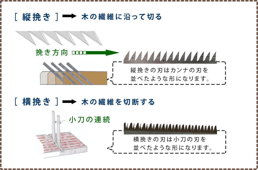

He also appears on a few blogs, like Douglas boatbuilder and in his saws Tanaka's videos. However, the turning point for me was a small diagram shown to me by Jason from mypeculiarnature.blogspot.com:
The idea being that the best teeth geometry is not A but C, against what saw sharpening companies promote. Here you can read it all in japanese http://blog.goo.ne.jp/yui1415/e/b78d923 ... 9672741882 (would be great if someone can translate/summarise, I don't read any japanese, so everything is google translated.) The difference seems to be that a positive rake bites the wood while a negative rake slices it, producing a smoother surface. From the saws I have, I can say that it was a common practice to use a (slight) negative rake on the teeth.

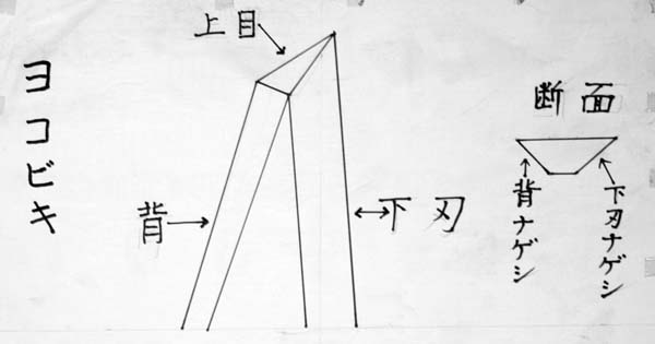

I can help with the translation a bit. Here are the terms for the various parts of the tooth in a cross-cutting saw, or yokobiki (横引き):
The three parts are:
Shitaba (下刃): cutting edge
Uwame (上目): top facet/tip of the tooth. Another term for this part is 'katana no sentan' (刀の先端)
Se (): 'spine'

This sketch was interesting, comparing a ripping tooth to a cross-cutting tooth:
It described the ripping tooth (top half of the picture) as being the same as a kannami (plane blade), while the cross-cut tooth (lower half of the picture) is said to be akin to a (marking) knife slicing across the fibers - he used the term kogatana (小刀). I can see his argument for a negative rake tooth pattern for cross-cutting.
