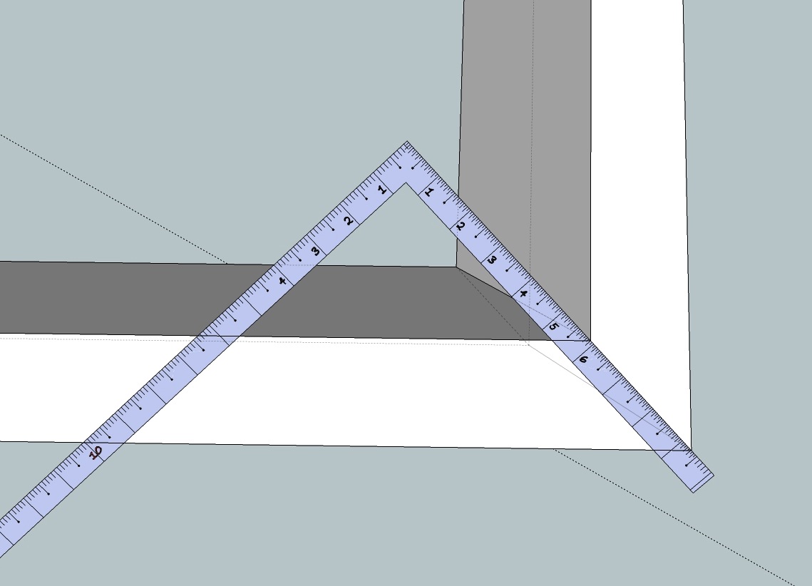

Here's the chōgen triangle on the edge of the board:
CSG Hopper 2 chogen explained correctly.jpg (94.21 KiB) Viewed 80724 times

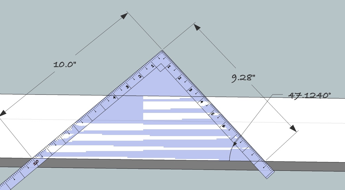

And here's the framing square with the same measures on the edge of the board:
CSG Hopper 2 chogen on hopper.jpg (78.13 KiB) Viewed 80724 times
Yep, revision 5 will have to come down the pike soon enough. I'm astonished that one got missed, so good on you Craig for finding it! I hope you find more (sorta :oops: )
