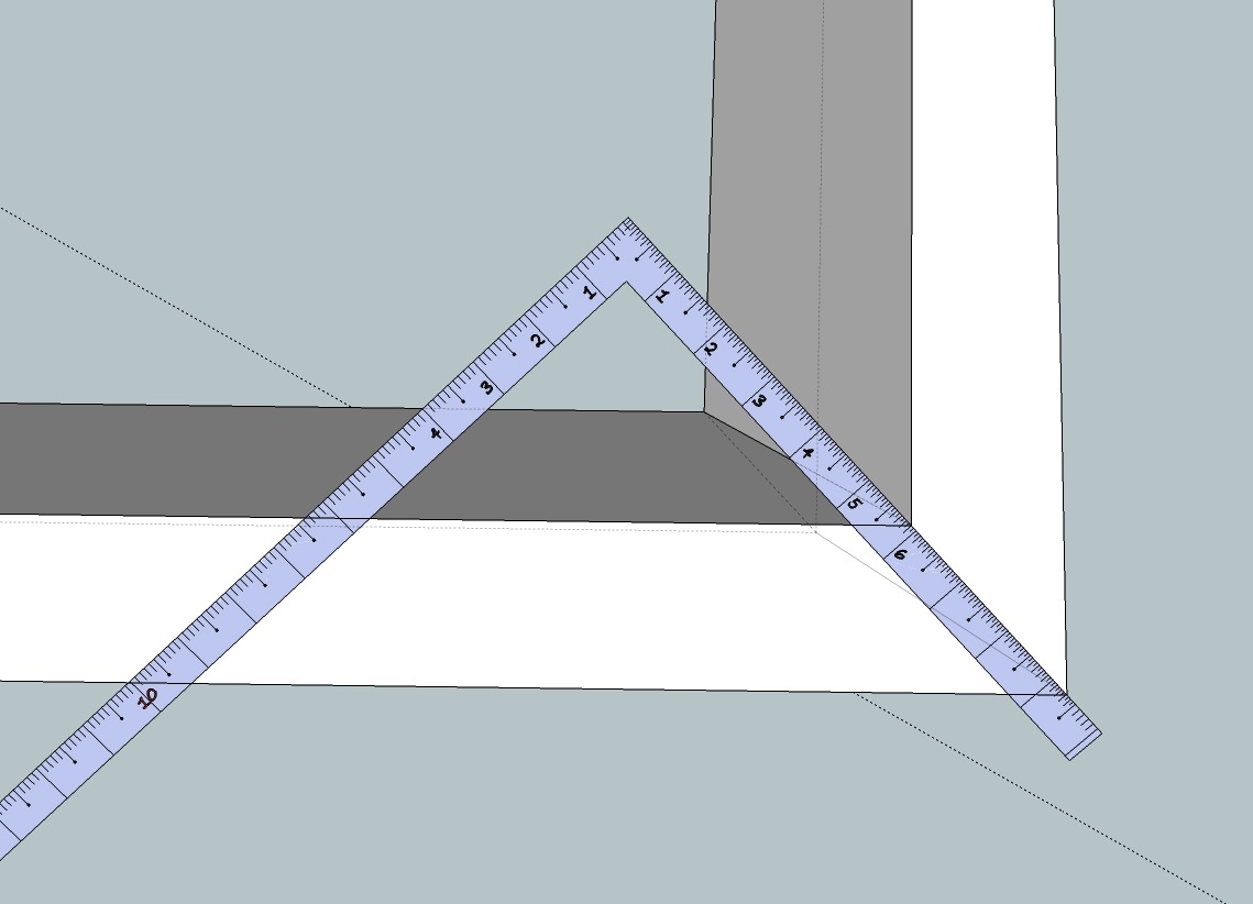

Here's the chōgen triangle on the edge of the board:
CSG Hopper 2 chogen explained correctly.jpg (94.21 KiB) Viewed 80733 times

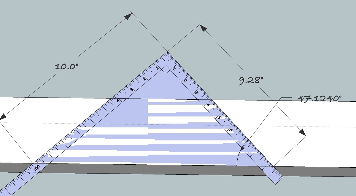

And here's the framing square with the same measures on the edge of the board:
CSG Hopper 2 chogen on hopper.jpg (78.13 KiB) Viewed 80733 times
