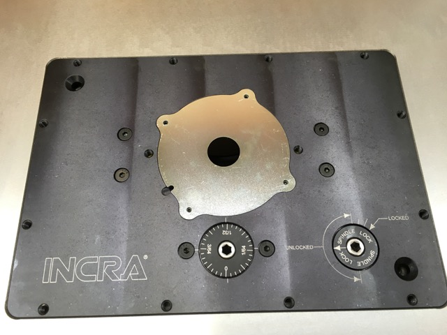

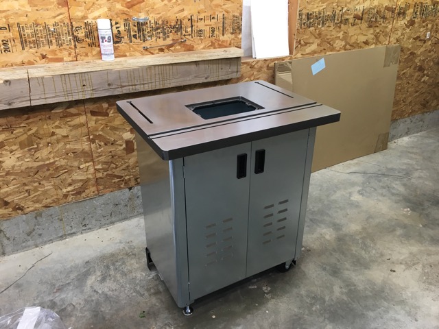

As it turns out, I had an opportunity to get a floor model of the BenchDog/Rockler cast iron table along with the cabinet. Started setup yesterday, will finish in the next few days. Since this is my first cast iron, I also sprung for a Starrett 36" straightedge.

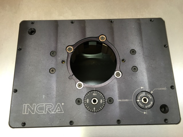

The Incra magnetic plate setup is interesting. We'll see how that goes...:
The Bench Dog cast-iron table with the steel cabinet base.
Incra/JessEm lift
Incra/JessEm lift with magnetic plate

A quick follow-up: I've used the new table in anger for some new stand prototypes. (I ended up designing and building two karakumidai for the Braid Society conference here in Seattle, WA a few weeks back.) So far, so good. By which I mean "absolutely dream-like compared to any router table I've ever used before". I still need to do final squaring-up of the router spindle to the table, but it was close enough for prototype-grade and primarily aesthetic finish work.
An unexpected benefit of the Incra version of the lift: there are optional magnetic plates with extra vents machined into them for better downward chip collection. They don't benefit all cuts, but when they do, they're amazing. A run of double roundovers (think semicircular) on 30mm rail end grain produced nearly zero ejected chips.
