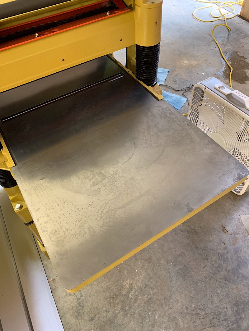

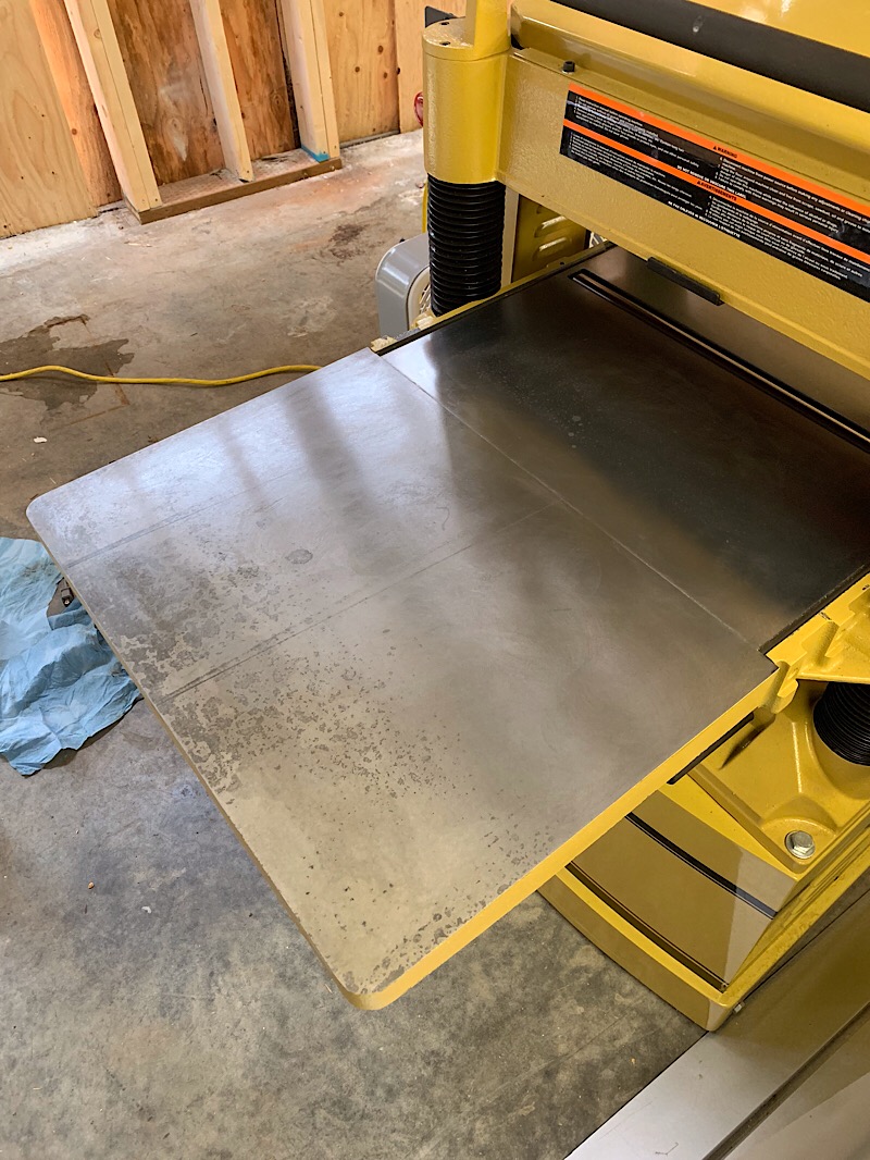

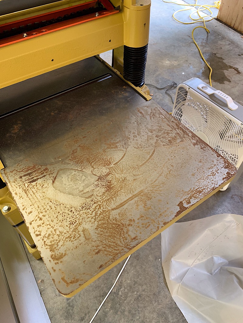

Here’s before and after #1. I removed the rust with Rust Free and a white scotchbrite, cleaned up with mineral spirits, then reapplied T-9 and paste wax.
Before (I only shot one side; gomen!):
Planer before
After:
Planer after 1
Planer after 2
Fortunately only the extension wings were really hit. The planer head was completely protected and the main table got only minor spotting. I’ll need to retouch the one extension wing, as there are some small but determined rust spots that weren’t fully removed in this pass.
