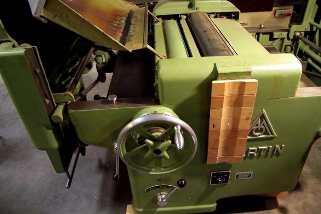

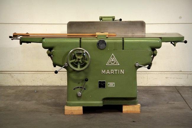

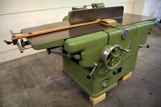

A well known German made machine.
pos.:
  • eats everything you feed it
    extremely well build with grease nipples on every moving part
    very accurate, thicknesser adjustable to a tenth of a millimeter
    high opening up to 280mm
    very wide table up to 640mm
    feed speed adjustable
    tilt-able fence
neg.:
  • extremely loud
    tables need to open in order to use the thicknesser to it's full capacity, requires better planning during work
    only two knives, nonetheless it produces a very smooth finish because of high rpm
    aeroplane loud
    Mr. Dust Collection, no I am sorry we don't know him

I got this machine almost two years ago and love it ever since. I have a dust cap for it which could work in the thicknesser mode but lack the funds to acquire a dust-blower. For now it is ok and doesn't effect the planing quality if you remain aware of it.
I have removed a thin strip of sheet metal which caused decompression of air in thicknesser mode and this made it noticeable quieter to my great relief. In planer mode however there is still air decompression between the knifes with chipper and the edge of the table. I am still thinking of a way to deal with this. Any advice or ideas would be appreciated. If I would have a permanent shop I would certainly try to install some decent dust collection on it. I am sure I could figure out something to make it work easily and effectively. For now it just sprays chips like there's no tomorrow.
It is just a great machine huge and powerful and still very accurate. If you are not in a hurry there are a lot of gems out here in Europe on the second hand market.
