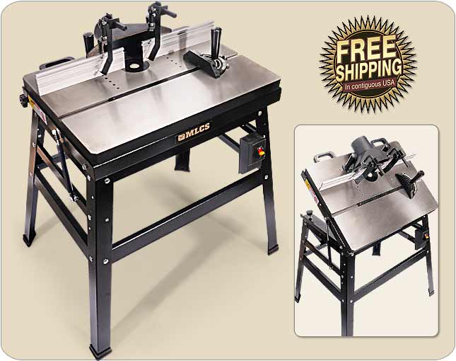

I love the whole thought process of building your own table from thick stock and I think it would be very rewarding. Before you reinvent the wheel there are some free standing cast iron tables from MLCS and Grizzly tools. When making your own you just have to be sure the fabrication process doesn't alter the top such as warping from welding. I will be interested to see pictures of your progress! Also depending on your frabrication skill level there are also extruded stock "systems" that are user friendly with a lot of clamps and bolt on accesseries that allow you to construct very sturdy and professional looking frames and fences. One company is Alufabinc.com. I have not used these systems so I can't say how expensive they might be. If there is a "metal by the foot" source in your area I would try there as well. Here in Kansas City there is a company called (of all things) Metal by the Foot that I have used many times. They have a great variety of metal profiles and there is no minimum quanity.
