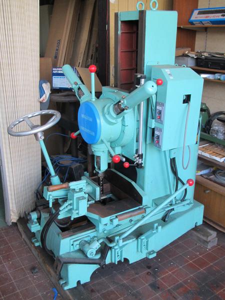

To expand a bit on what Dennis was saying in regards to stationary mortisers, I think if you are handling 8"x8" and larger timbers, the standard hollow chisel machine is not the best bet for convenience of use. You have to lift the timber fairly high to get it on the table, and would need to rig up auxiliary support tables. There is, however, a purpose-built hollow chisel machine intended for those working with larger timbers, in which the work table is quite low to the ground.
Here's an example, a Shinoda model with three heads:
I know of a machine like this for sale on Long Island, for about $5000 if anyone is interested. Otherwise, there really aren't any of these to be found stateside.

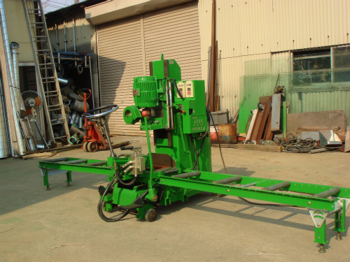

Another one, single head with side support tables, the hydraulically powered Shinoda SS-G52:
Re: Hollow chisel mortiser

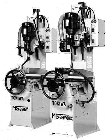

As for the hollow chisel mortisers used by furniture makers, the one I drool over a bit is made by Tokiwa, the Servo-V:
Compare the size of the box column to anything else on the market - hulking! These machines are well designed. The one on the right in the picture has hydraulic clamping.
These can be had for $4000~5000. Older ones are green, newer ones are white.
