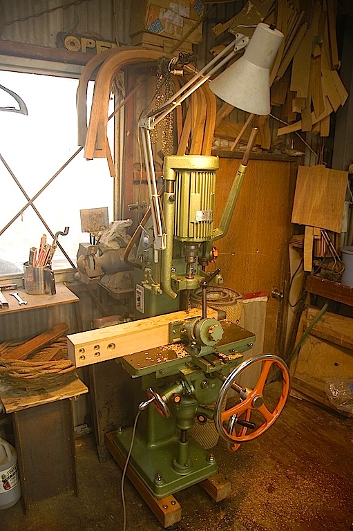

The new lad in the shop, a Tokiwa MH-30. Some improvements over the previous mortiser are spindle locks on the adjustments, larger clamp surface, a better depth stop arrangement, and a larger width capacity that will fit between the table back and the clamp. The table looks short in the photo, but it's 55cm long, which is pretty adequate for furniture work. One nice feature that I quickly noticed on this machine, is the good sized gap between the underside of the table and the ways beneath that support it. If you need to take off the clamp for more width, you can still fasten the work to the table with C clamps. which allows for horizontal movement.
I'm the second owner, but the previous one used it sparingly and respectfully. It's not so often that you can obtain a used drilling type machine where someone hasn't managed to drill into the table.
I made a simple base on casters, which adds height and stability, allows pullout for more room if needed. The machine is surprisingly heavy, made from cast iron. The rear neck is 18cm square, rather beefy. Japanese woodworking machinery tables tend to have a rather low working height.
