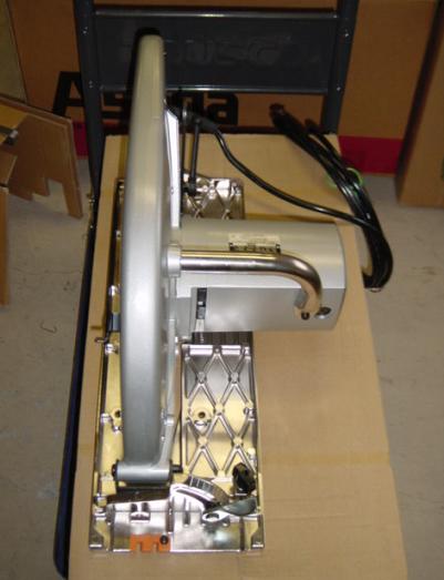

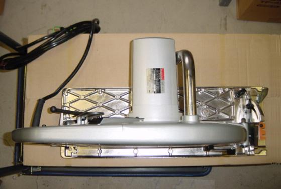

Not everywhere - the US and Canadian markets get the cheaper saw with pressed steel base. Makita makes a model with a cast aluminum base for other markets:
They are underpowered, especially when ripping with anything but a really sharp blade. The 380mm model is a better choice IMO.
