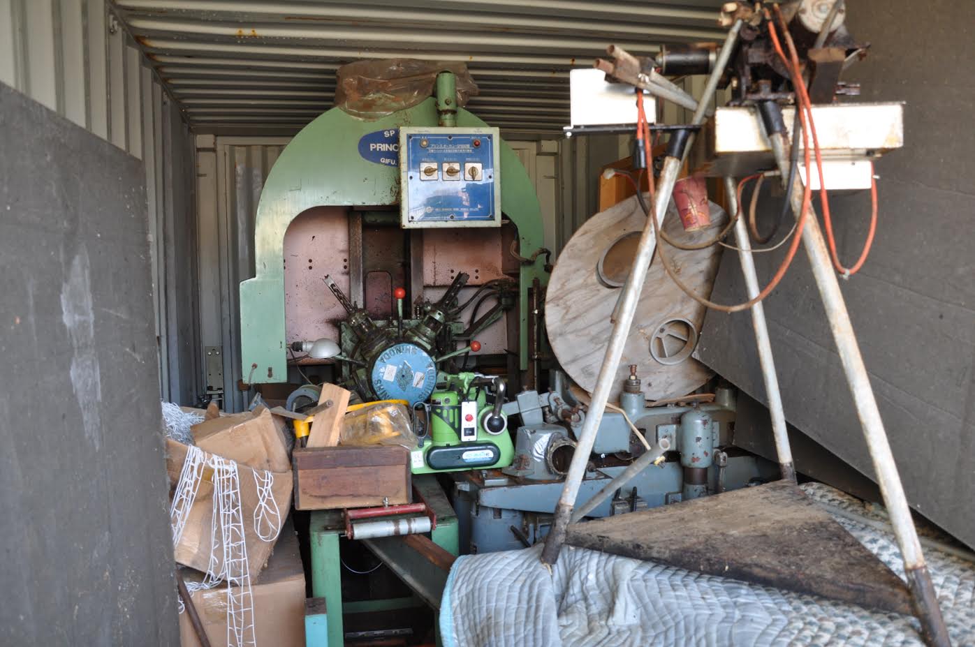

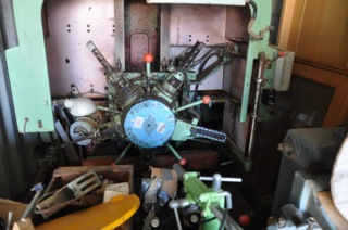

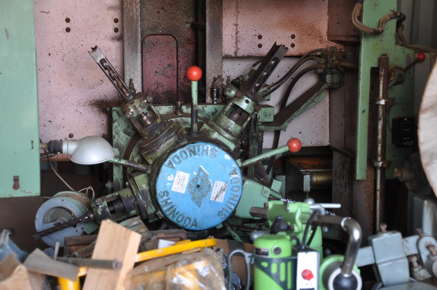

Cole wrote:I would be interested in getting a stationary one set up for larger timbers but I would like to purchase a turn-key machine with tables etc. like the one you posted above. (Sasada SS-G52)
I finally got some pics back from the guy with the mortiser. It's an unusual unit, with 5 heads on a turret. The more the merrier. There are three square hollow chisel bits mounted, 15mm, 18mm, and 30 mm, a dovetail hollow chisel bit, and a chain mortiser as well!
The model is not too common- I couldn't find any other pictures of the same machine online.
I asked for large format pictures, and received small ones - sorry!

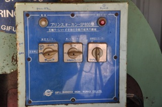

I also now realize I was misreading the kanji - choosing to read 'sasa'-da for '篠田' instead of the correct reading for those characters of 'Shinoda'. The character '篠' can be read as 'sasa' or 'shin' and the actual meaning is a type of bamboo grass. Trying to decide which reading is the correct one to use for a character is one of the challenges to Japanese. There are general rules of course, but many exceptions and odd cases.
Re: Hollow chisel mortiser
Sat Dec 06, 2014 9:36 am
After I asked for larger photos, they were in fact forthcoming - well, a couple at least:
He said the mounted hollow chisel sizes were 15,18, and 30mm, but it looks more like it is 15mm-24mm-30mm to me.
Shinoda is a general iron works and fabrication outfit, also making large metal vats and canal lock gates, etc.

That's quite an arrangement, wonder what it sounds like? Did the fellow that sent the photos, ever use it? Presumably all the chisels and other cutters aren't turning at the same time.... :o
