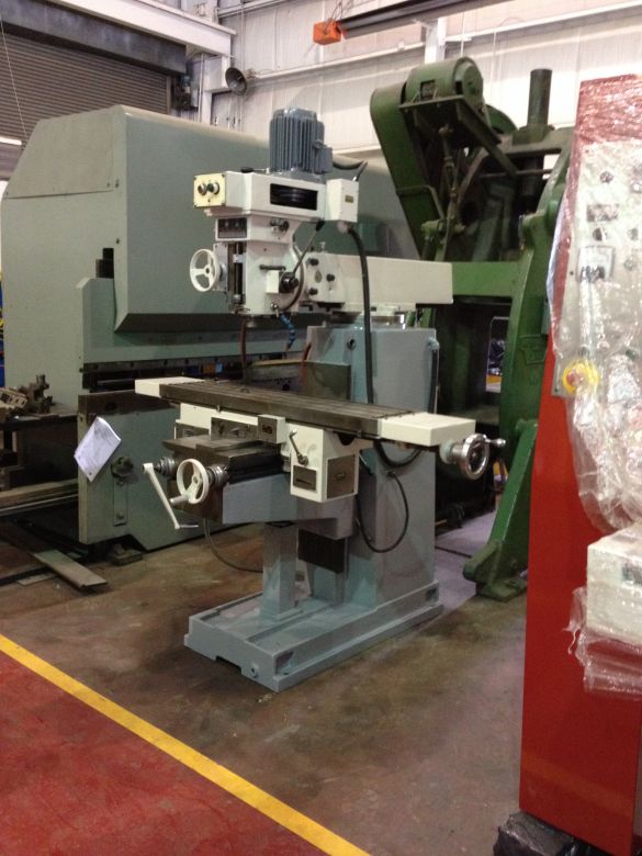

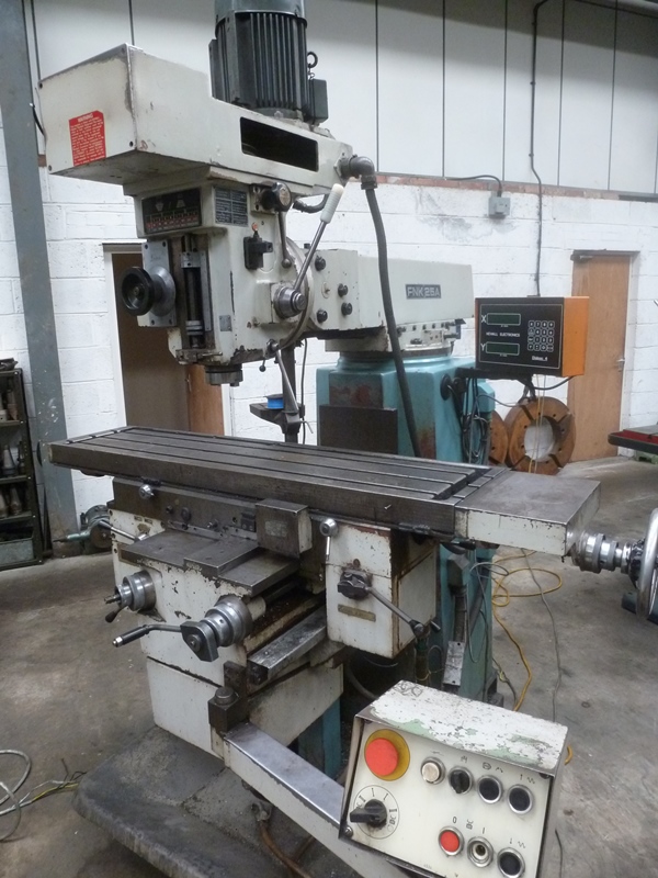

So, in the past couple of days I have learned that a company in the Czech Republic, TOS Kurim, made a version of the FZ-5V under license from Zimmmermann. The TOS model was called the Finesa FNK25, and typically came with a conventional size metalworking table of 11"x49".
Here's a couple of examples:
They made these from the late 1960's up until the 1990's and more than a few were exported to North America. This means that I might have a chance of getting parts for the machine through TOS Kurim (still in business), or otherwise. These machines are pretty much identical to the Zimmermann product, save for a different upper table, lack of rotary table, and some minor differences in levers and stuff like that, and SK30 tooling instead of SK40. Instead of switching between powered left-right and powered rotation, the TOS machines are set up to have powered in-out (y-travel) instead of the rotation.
Someone has even uploaded a copy of the TOS machine manual, in English to ScribD. Unfortunately, the vital parts schematics are missing from the file online, but there was some helpful information in there nonetheless.
