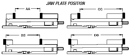

You probably have looked up a spec sheet on your Kurt vise as to the different configurations of bolting the hard jaws on but if you haven't, it is capable of opening and holding up to 17.030. You can have taller and wider soft jaws made to give more support to clamp thicker parts (wood in this case). Out riggers can be made to bolt to the left and right of the t'slot table to support longer work. I worked on part on a Bridgeport that formed the backbone of the B1-A prototype bomber. Those parts were over 16 feet long and cut were made on each end and along different places in-between. Those parts were supported on shop made roller rests which amounted to the type used as in feed/out feed support for woodworking machines. The floor was concrete but you may get proper support on your shop floor if you are to set up that kind of support.Chris Hall wrote: It's all a learning curve.
Re: Zimmermann FZ-5
I presume you mean this spec sheet?:
I hadn't considered moving the jaws outboard, so good to know!
