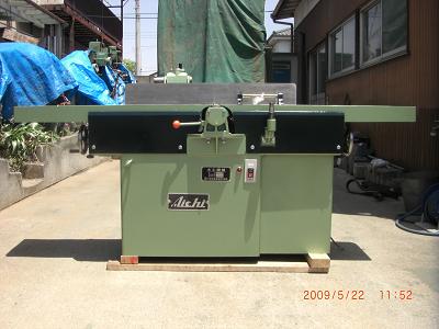

A 300mm jointer by Aichi Electric Industries (愛知電機):
- dl-3.jpg (63.5 KiB) Viewed 8249 times
- dl-4.jpg (61.4 KiB) Viewed 8249 times

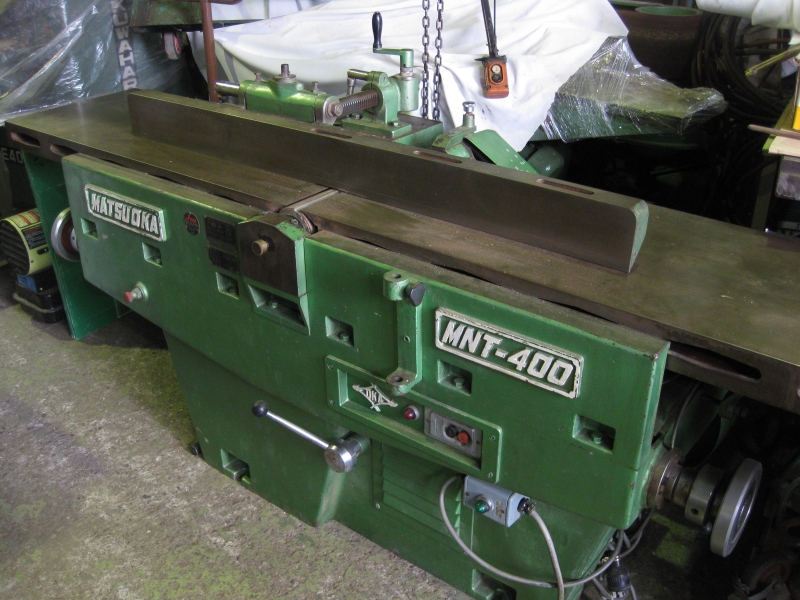

A 400mm jointer with cross-cored tables and fence, by Matsuoka:
- mnt400.jpg (344.45 KiB) Viewed 8247 times

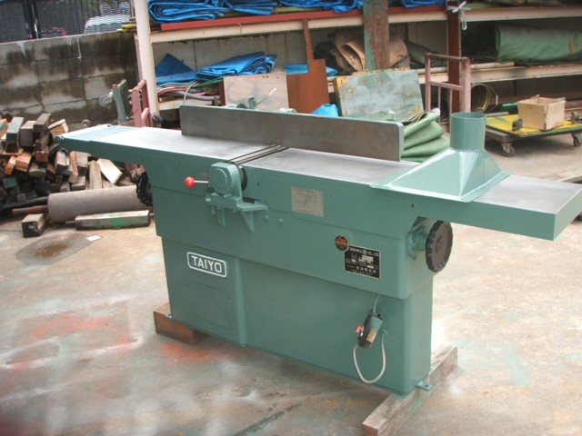

Taiyo is a common brand:

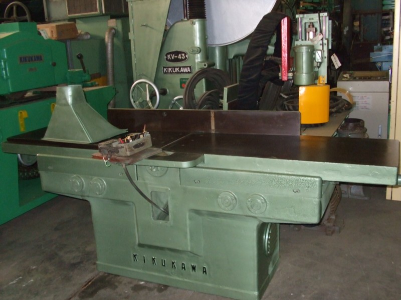

Kikukawa:
Looks like it needs some attention to the electrics.

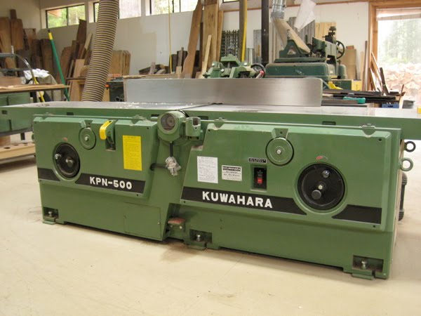

Kuwahara makes some very solid looking machines:
A sleek design which is a bit reminiscent of sliding table saws with the rotary adjustment wheels for the infeed and outfeed tables.
