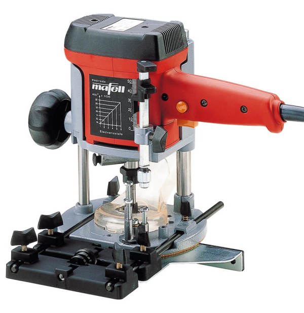

One thing though about the Mafell small trim router: I read somewhere it is actually made by Festool. Lets compare the Mafell to the Festool to see how similar they look:
The Mafell, at $600:
The Festool, at under $400:
I'm not confident that one can draw the conclusion that both routers are made by the same company, but there are a lot of design similarities to be sure. Apparently Mafell used to make the large Festool router as well, before the design was revised. Mafell aims more at the heavy carpentry worker, while Festool aims more at the cabinetmaker/joinery end of things, with some product overlap.

Interesting. Seems basicaly exact the same machine. I wonder if the components like motor, bearings etc. are the same? It seems that the Ft can run to up to 24000rpm and the Mf only to 22000. The mafell has:
'- Great versatility thanks to 1 15/16 in. (50 mm) cutting depth and the speed
  range of 10.000 to 22.000 rpm.
- Control electronics, which constantly maintain the specified speed and
  guarantee smooth start-up and '
This might mean the Mf has different electronics hence the price difference. But does this mean a better machine? Who knows, I always find it hard to judge those things depending on the information provided by the manufacturers. Mafell has the tendency to be the most expensive brand in most cases but they do pay tribute to the 'German high quality production ethics'.
Re: Routers
Sat Jun 23, 2012 10:11 am
Hmm. Well, on those points the Festool also has electronic motor control and soft start. The depth adjustment range is 55mm, or 2.125". Also made in Germany. Looking at the Mafell base I notice it has poorer support for the edge guide rods (2 locations enclosing the rod instead of 3 on the Festool), and no quick disconnect cord. Not sure I see any reason to buy the Mafell in this case.
