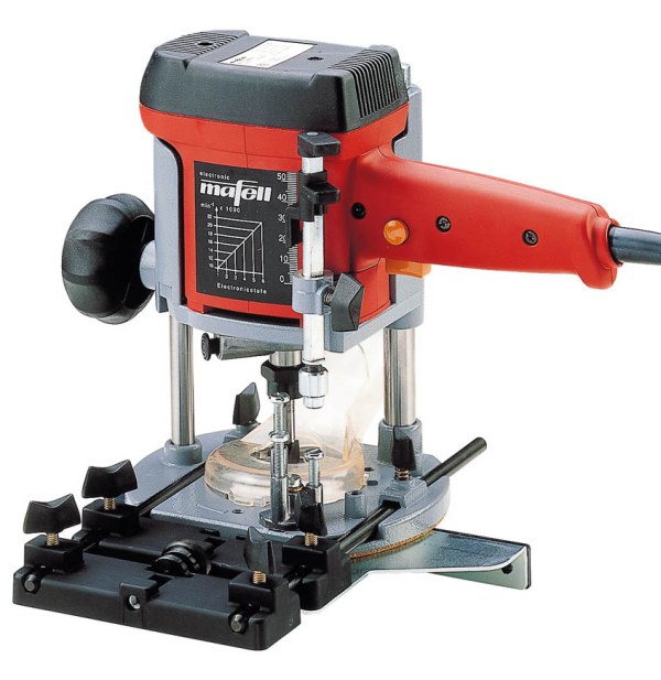

The past couple of years I have used many different routers. At first the Festool was definitely my favorite. Recently I have been using the Mafell routers and I like them more. The others I will not discuss since they are not on my personal wish list.
I think the engine is of better quality especially the lo65 is way ahead of the of2200. The glide bars still run smooth on the Mafell after long and intensive use, not the case with the Festool which is a serious annoyance for me. The Mafell is easily stood upside down when you change bits, the Festool not.
The copying rings on the Mafell are dead accurate, I have heard that this is not always the case with the Festool although I have no experience with this issue.
The depth adjustment on the Festool looks fancy but I like the no trill and frills on the Maffel much more. Personal preference I guess.
Dust collection is excellent on both machines but I don't like the plastic cap so I never use it because I like to see what I am doing. On both machines I miss a bright LED light.
And again I like the round handles on the Mafell so much more then the grips on the Festool. Unlocking is smooth since the knob runs on a bearing. At the moment the Mafell is also cheaper but maybe this is only the case in Europe??
Festool will be a very good buy no doubt about it, but my personal preference goes to Mafell.
If you are looking for a trim router I can recommend the Ridgid which is a great little machine. The Bosch I don't like since the aluminum on the shaft will wear and cause it to grip while adjusting, very annoying.

One thing though about the Mafell small trim router: I read somewhere it is actually made by Festool. Lets compare the Mafell to the Festool to see how similar they look:
The Mafell, at $600:
The Festool, at under $400:
I'm not confident that one can draw the conclusion that both routers are made by the same company, but there are a lot of design similarities to be sure. Apparently Mafell used to make the large Festool router as well, before the design was revised. Mafell aims more at the heavy carpentry worker, while Festool aims more at the cabinetmaker/joinery end of things, with some product overlap.

Interesting. Seems basicaly exact the same machine. I wonder if the components like motor, bearings etc. are the same? It seems that the Ft can run to up to 24000rpm and the Mf only to 22000. The mafell has:
'- Great versatility thanks to 1 15/16 in. (50 mm) cutting depth and the speed
  range of 10.000 to 22.000 rpm.
- Control electronics, which constantly maintain the specified speed and
  guarantee smooth start-up and '
This might mean the Mf has different electronics hence the price difference. But does this mean a better machine? Who knows, I always find it hard to judge those things depending on the information provided by the manufacturers. Mafell has the tendency to be the most expensive brand in most cases but they do pay tribute to the 'German high quality production ethics'.
Re: Routers
Posted: Sat Jun 23, 2012 10:11 am
Hmm. Well, on those points the Festool also has electronic motor control and soft start. The depth adjustment range is 55mm, or 2.125". Also made in Germany. Looking at the Mafell base I notice it has poorer support for the edge guide rods (2 locations enclosing the rod instead of 3 on the Festool), and no quick disconnect cord. Not sure I see any reason to buy the Mafell in this case.
