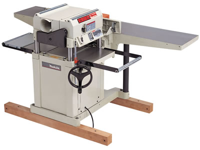

I would steer clear of those older machines. They are only 110v, for one thing, which makes them light duty. And because they are 110v. they scream pretty loudly when running, and they can't take much of a pass, especially with wider boards. The little jointer that comes with them is of limited use, though at least it is mounted to the side. As you noted, most of the ones you'll find are knackered, and this wouldn't be such an issue if parts were available, which they are not, for the most part. You can get rollers recovered, spare drive belts, brushes, that sort of thing. Bearings are likely proprietary.
Makita and Hitachi still make these sorts of combo machines, though they don't export to the US.
Here's the Makita 2035 with 318mm jointer, 318 planer:

Derek,
I think the side-by-side arrangement of jointer and planer, as in the above-pictured Makita, is a reasonable solution. I would say it is best to avoid the type of machine in which the jointer tables are on top and must be flipped out of the way and the chip hood folded over, like a Hammer A-31 or similar. I think that a 12" jointer is really the minimum useful size for carpentry and furniture work, and a 16, 20 or larger is to be preferred. Whatever size of jointer you have, the planer needs to be at least as wide in capacity.
The amount of chips a planer can spray without collection is impressive. A dust collection system is a must - the only exception I know of is a Dewalt portable planer which has a built in fan so that a plastic bag can be attached directly. Those are lighter duty planers however, and only 12.5" wide. Good to have on a jobsite.
Some jointers can be used without collection, providing there is a hopper or some sort of tray below the machine where the chips can pile up. Some jointers however are designed to work only with dust extraction - like my Martin for instance. If you try to joint wood on it without the dust collector running, the chips soon start spraying out around the cutterhead.
