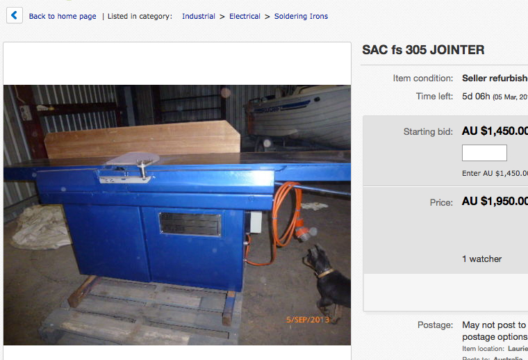

SAC is a decent Italian brand, on a par with Griggio, Casolin, Casadei and SCM. Probably owned by SCM. Quality seems on a par with those brands, and i imagine the price of parts also. I believe they are still in business, but I have no idea how far back they carry parts. It might be instructive if you locate the parts supplier in Australia for SAC and give them a call and ask about the availability of spare parts fo a machine which is 20 years old or older. Things like knives, belts, bearings. That's about all that wears out on a jointer. Well, the table raise lowered mechanism can wear and get slop, leading to the infeed drooping slightly over time, but good machines have adjustment capability built in for that.
Looking at the SAC jointer, i was struck by the ad on Ebay - why on earth would it be in the category of 'soldering irons'?!:
Then I was struck by the wooden fence - I'm suspicious, especially since the fence tilt mechanism is still there. What happened to the fence? It must have gotten bent or broken, as it is not something easy to lose or remove from the tilt mechanism. If the fence took some sort of damage making it unusable, then what sort of damage might the rest of the machine have taken? Was it dropped off the back of a truck? The color scheme was pretty ghastly, but that's minor. I think I'd pass on that one.
The Griggio planer - the major strike against it, in my view, is that the table is raising only on a central hydraulic cylinder, without the added vertical gibs on the front and rear to help stabilize. I feel that is a poor design, one easily stressed and distorted by feeding a longer timber through the machine without full support. Also an ugly paint scheme, and the presence of homemade metal brackets here and there - though the dust hood looks good - leads me to wonder just how bad the shape of the machine was before the paint got slopped on. It's also on the small side at 350mm capacity - 500mm would be better. I'd pass on that one too.
I'm not sure which machines come with the more desirable 4-post, 4-corner table support, but the SCM does. Martin too, of course, but no point going there. I picked up a used 630mm SCM planer with Tersa head last year for $5500, which was a bit of a steal. Not sure what your budget is, but if you can find a 500mm SCM planer with Tersa for around $4500 that would be a good choice. Oh - what power do you have at your shop? That's a consideration too. A 500mm planer should run at least 6 horsepower. Maybe I'm suggesting machines that aren't practical for your situation - if so, my apologies.
A lot of machinery sellers will take a beat-up-looking machine and slap fresh paint on it - with 'slap' being the operative word. The machine looks newish as a result but in reality is just as worn out as before. That's an incredibly common practice and a bit of a warning flag. If they will supply pictures of the complete rebuild, along with pictures of freshly ground tops, and so forth, that would be another matter.
