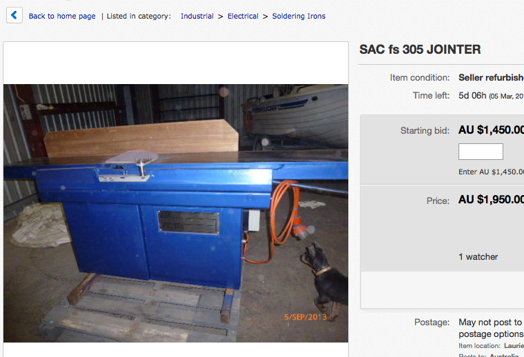

Looking at the SAC jointer, i was struck by the ad on Ebay - why on earth would it be in the category of 'soldering irons'?!:
soldering irons.jpg (329.74 KiB) Viewed 7968 times
Then I was struck by the wooden fence - I'm suspicious, especially since the fence tilt mechanism is still there. What happened to the fence? It must have gotten bent or broken, as it is not something easy to lose or remove from the tilt mechanism. If the fence took some sort of damage making it unusable, then what sort of damage might the rest of the machine have taken? Was it dropped off the back of a truck? The color scheme was pretty ghastly, but that's minor. I think I'd pass on that one.
