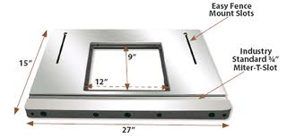

Did an updated search and found
http://www.discountsteel.com/items/C250 ... nts=&qty=1
This looks like the ticket if I go this route. If you go to the page, you'll see there are flatness tolerances given for different widths. The critical width is 3/4", since at that point the flatness is guaranteed within .005"
The biggest problem with going this route is that I'm uncertain how to get a machine shop to clean-out the drop in router plate area? When asking a shop to do something like this, do I need to purchase a router lift and take it to the shop? Or find dimensions and tell them what I'm looking for?
Chris, like you said, perhaps the t-slot isn't super important if I either: purchase the Jessem fence so I can purchase the Mast'R slide sliding gauge or I could purchase a fence like the Incra and retrofit the Mast'R slide sliding gauge. I was able to find one person who has already done this and posted a tutorial on it.
Would you still suggest some type of flat steel bracing underneath?
I'm open to all suggestions since this is foreign territory for me.
Either approach could work, but likely the most reliable would be to bring the drop in router's lift assembly in with you and explain how you need the plate cut to accommodate it.
I would still look to place bracing underneath, and after the shop machine's the opening they should recheck the plate for flatness. Metal moves when it is cut sometimes.
It's not the cheapest route but you would obtain a flat router table afterwards. I would also plan to hard-coat anodize the plate afterwards, as raw aluminum can leave a mark on wood.
Consider a Mitutoyo quill kit as well, which would be the best z-axis indicator available. The machine shop could probably adapt it onto the router lift mechanism.

Before I get too invested in this process and begin purchasing, would it be just as reasonable to purchase the ex-calibur top and have it surfaced and the quill installed at that time? I'm thinking it may save money and give the exact same result?
http://www.tools-plus.com/excalibur-40-075.html
Maybe I'm wrong and precision surfacing will cost just as much as the machining required for the router lift cutout? My biggest problem in guestimating all of this, is that I've never had anything machined. I'm sure it's variable, but what kind of prices are we looking at here?
I'm not going to cut corners but I wonder if these would produce similar results?
